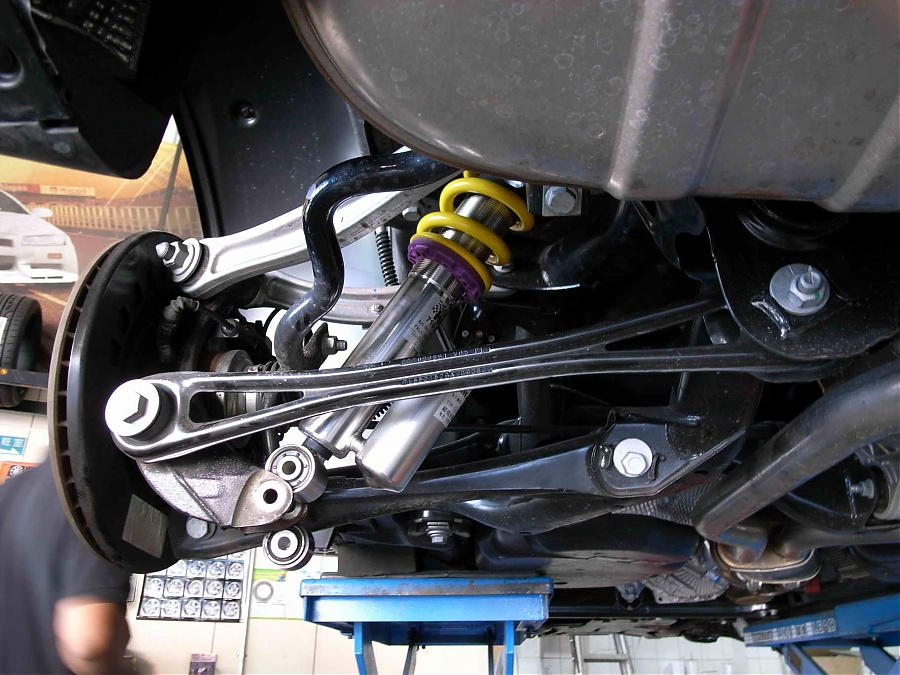

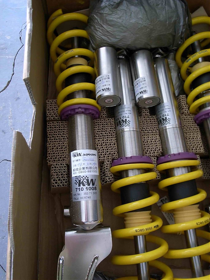

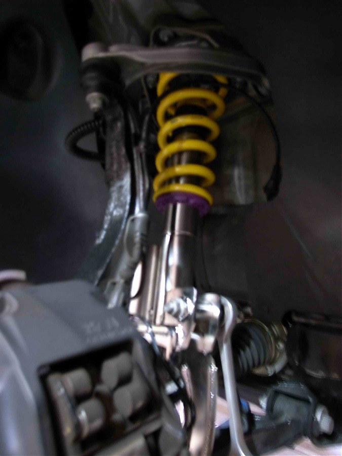

Actually, I have the KW V3 installed on my '08 Cayenne a couple of months back. The car can attack corner at higher speed with minimum body roll. As the bound and rebound are fully adjustable, the ride is much comfortable than the stock setup, especially in the rear axial.

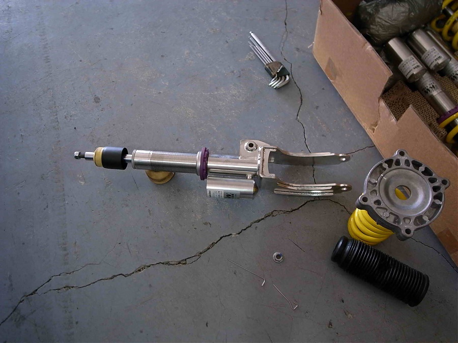

The installation was straight on, and will retain the the original camber plates. FYI I don't think the ride height is much an issue here, the KW V3 allows 35mm~70mm height adjustment on top of its physical size. The stand along KW coilover is about 6cm shorter than the Cayenne stock shock, so it allows you really drop the pepper.

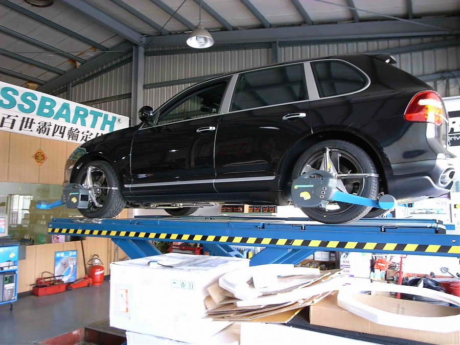

I have not tested the Cayenne's air suspensions nor the GTS steel spring setup, I cannot comment their handling. To me, one of the main advantages of using KW V3 is the wide range bound and rebound adjustments to anyone's like. The pro tuned the setup well suited to my 20" rim/tyre combo, and he manipulated similar ride comfort to my in law's new Cayenne (22" Techart) as well. He commented the setup is as comfort as the air suspension, and handles par if not better than it. However, you can go off-road with the air suspension, but I doubt there is much clearance for the KW. If price is not an issue, KW V3 is a good choice to consider.
