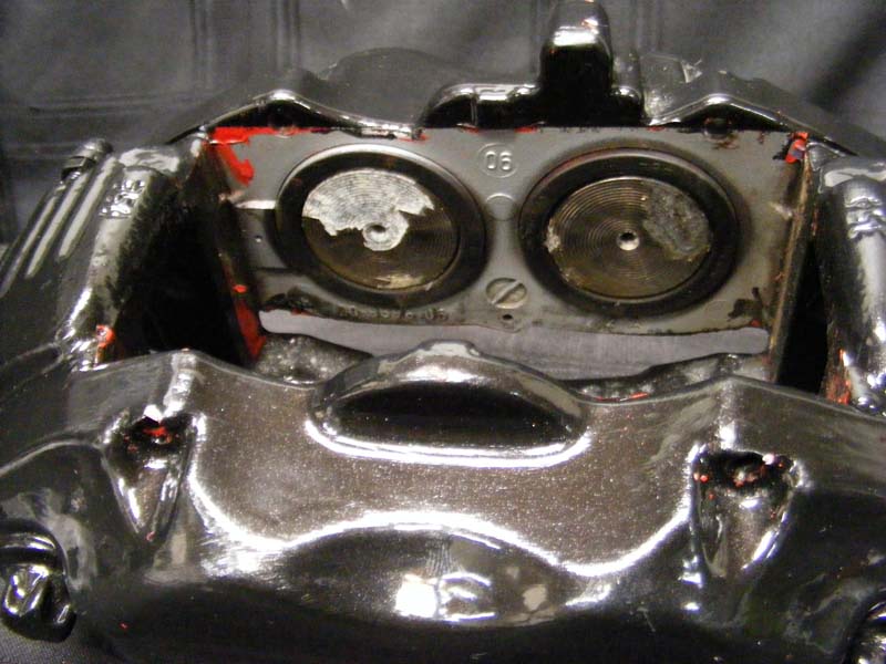

Still want to Powder Coat? Calipers gone South
From this image you can see how the PC cakes on the parts, not good at all....
Call "Eli" yourself, he'll answer your questions.
