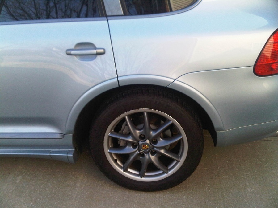

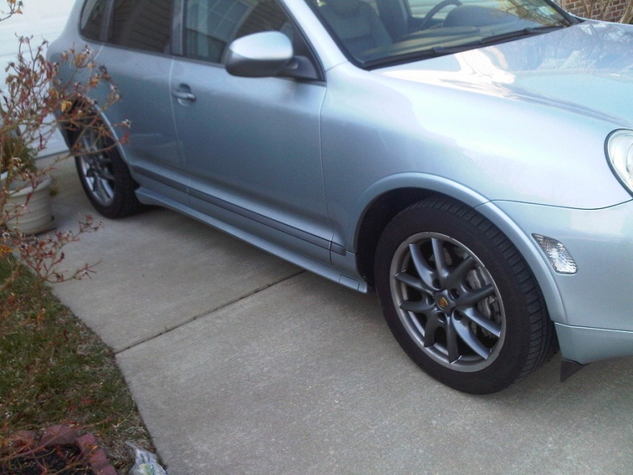

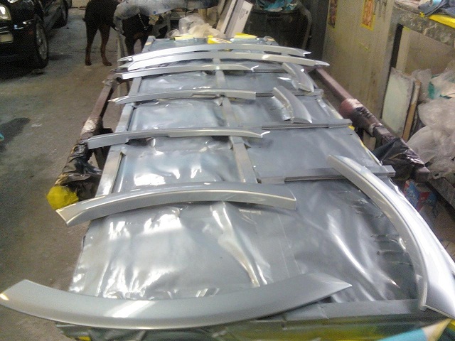

ok folks i finally got the arches painted and installed, the 10pc package for my generation Cayenne 2002-2006.... will let the results speak for them selves. Wife cant tell the difference and also all the photos were taken with my blackberry and Cayenne was not washed , ... A bonding agent from 3M was applied ( I don't recall the name but in 24hrs it was dry and 100% car wash ready i did run it through the car wash on the 23rd hour and 58min lol).
I didn't want to use the tape the pieces came with since they sat with me for ages and who knows how long it sat at the dealer before i purchased them. These pieces were originally a black/charcoal grey with texture. My buddy who preformed the magic smoothed them, filled them, primed them refilled re-primed sanded painted and cleared them not sure of the exact number of coats or the order they were done. In my eyes she looks like the pre Cayenne GTS, and i have got the nod from a few Cayenne's already (2009 Turbo S, and a 2011 Cayenne Turbo, one gent with a Titanium asked me was that an option i should have checked off i never saw those on the order book)
