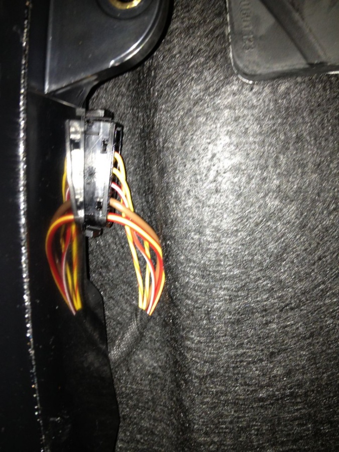

I'm a novice when it comes to electronics. Done some amp and speaker installs long ago on my BMWs. I'm interested in doing this upgrade (Alpine MRP-500 with JL Audio 10W3 sub). Went to local shop and they're quoting me $870 out the door. Yikes. $150 for amp, $200 sub, $60 box, and rest ($460) for parts and labor. They want to run power from battery and use a ?Hi/Lo converter? vs this installation which they claim is not a good idea.
With my 2013, the wires to my Bose are different. Per the picture, I have a large red with white stripe, large brown, little red with white stripe, little yellow with brown stripe, and little yellow with red stripe. Assume that the large red/white is power, large brown is ground but what about the others?
Also, not sure if I want to pull out the Bose sub or just tap into the wires and run both the Bose and potential upgraded amp/sub.
Other than needing to know what the wires are on my 2013, can someone please advise what additional parts/wires I will need to order with the amp and sub to complete the install. Thanks and sorry about the novice questions here.
