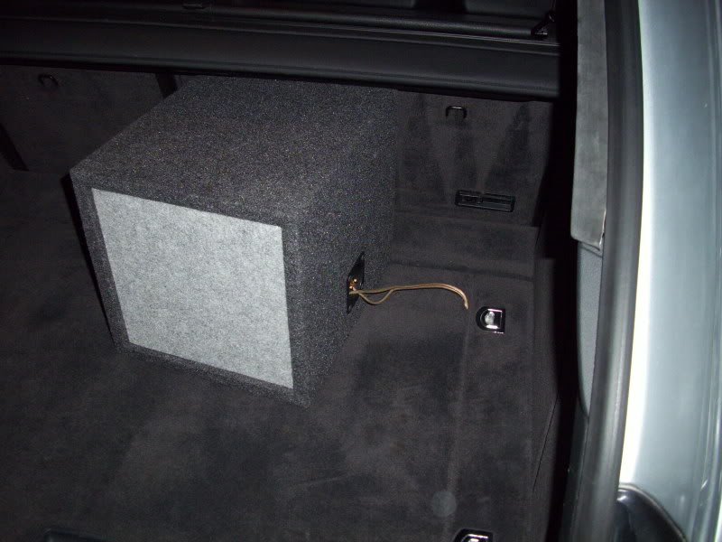

Image Dynamics 10" sub in custom box, easy to take out when needed!

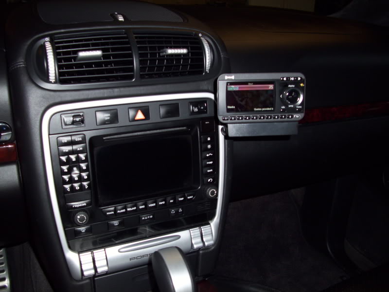

Heck, here are some pics of my XM Radio install using a Dension Gateway 500 interface just for good measure!

I have the I-pod cable run up into the non-smokers tray in the front dash as well so its easy to swap out I-pods and use them for control. Rest of the factory system is stock for now.

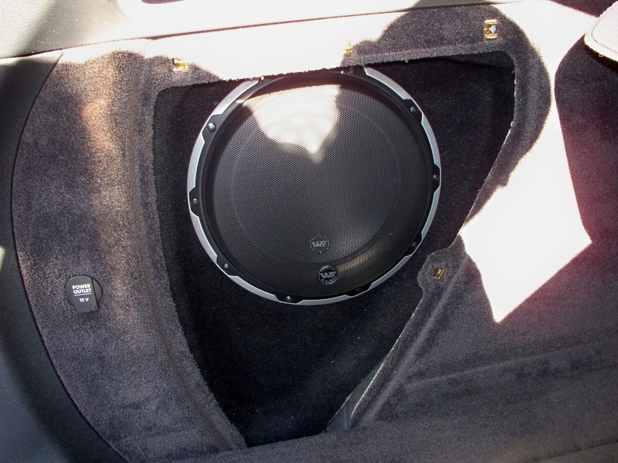

I did almost the same thing....amp under spare with Stealth box on drivers side cargo panel. I have a bass gain **** under the steering wheel to adjust bass on the fly. I kept everything else stock. Sounds pretty good, not as clear as having a 12" sub etc and replacing all speakers but definitely a huge improvement. Didn't install myself, so I can't help you with an installation time. I'm pretty sure the Stealth Box had to be sort of jammed in there...
