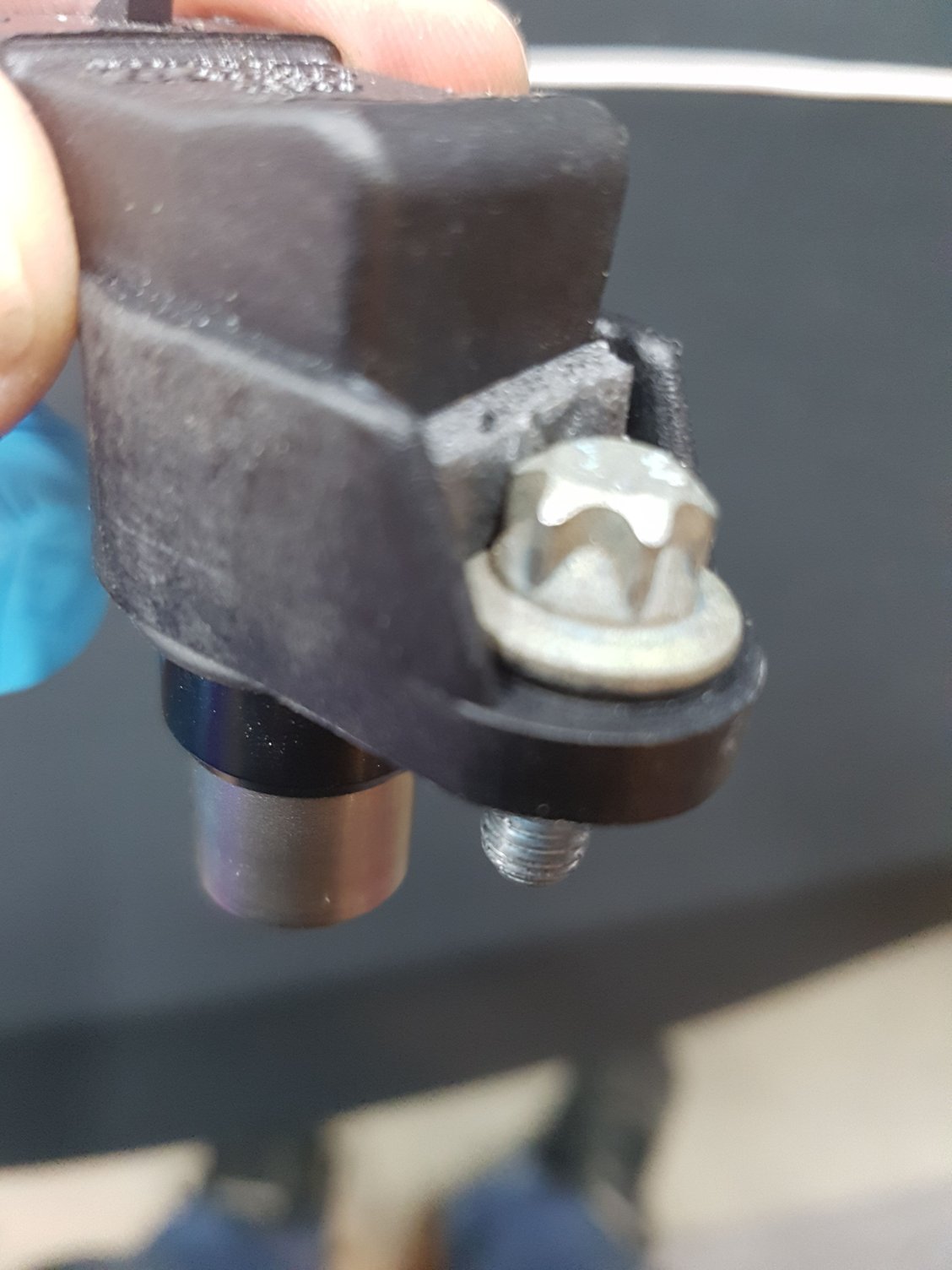

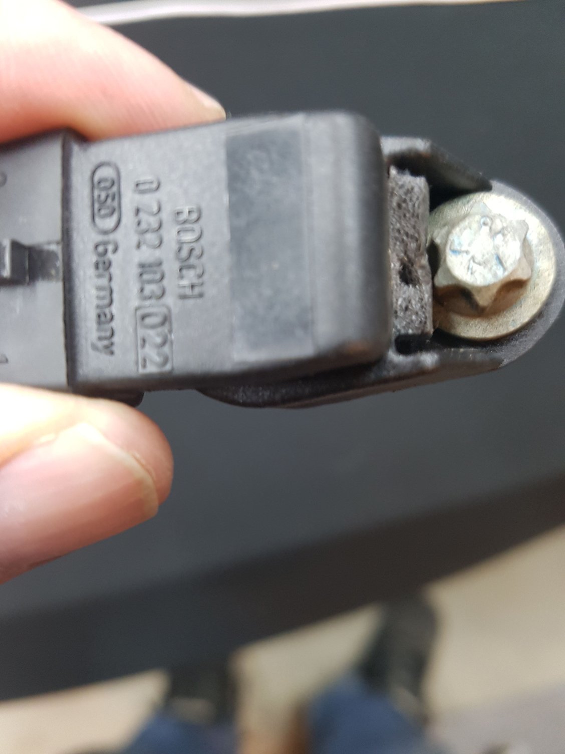

Thanks on the Bosch P/N... far less than Porsche and the exact same part as was in the truck already!
One tip i have to add is that on a on a TT it's tight (understatement) to align the sensor and get the bolt started. I was stressed about losing the bolt down into the bowels of german design so I put a piece of thin foam tape on the sensor beside the bolt head. Its soft and thin enough that the socket could engage the bolt head by squishing it aside. It made it much easier to manipulate the sensor with the bolt already pushed
through
