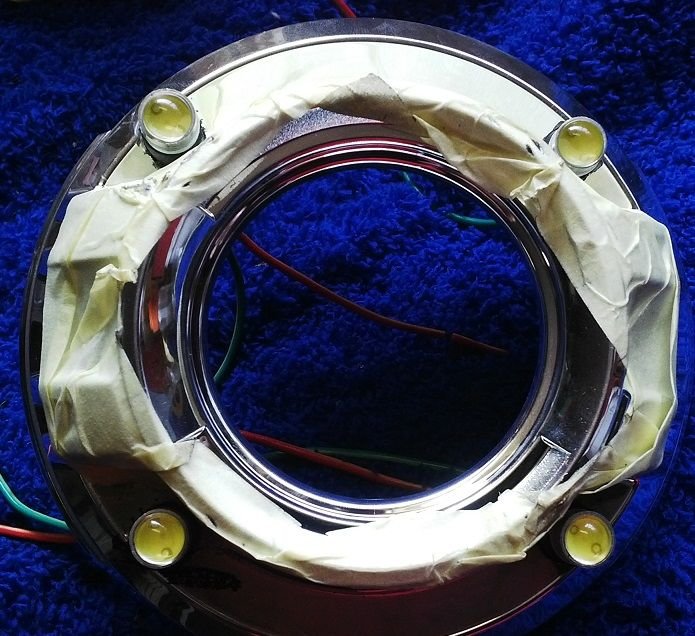

I've just completed my 957 lights.
Process is the same as for the 955. Still a nerve-wrecking task even after cutting off the edge, as the glue is still very strong and I was in constant fear of cracking the plastic cover while removing it.
But I eventually got it done without breaking anything.
I decided to try a 4 led setup inside the light while I was in there, and it turned out pretty good.
I found out the hard way that the "chrome" plating on the trims around the lens are very fragile. I masked it with a bit of tape to protect it while I was drilling the holes for the LEDs and the chrome coating came off with the tape.
I sprayed the entire thing black.
masked for protection, but removed chrome coating
sprayed , without cover fitted
Blacked out with LEDs
