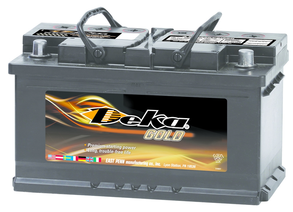

Deka GOLD 950 CCA = $135
Fits under the Cayenne driver's seat like a glove. Made in USA:
Old Jun 28, 2015 | 03:32 PM
Waitin4Dv's Avatar
Joined: Aug 2013
Posts: 155
Waitin4Dv is infamous around these parts
Got this from Napa fit like stock

Zuffenhausen955's Avatar
Joined: Jan 2014
Posts: 247
From: Palm Desert, CA
Zuffenhausen955 is infamous around these partsZuffenhausen955 is infamous around these parts
That is made in USA by East Penn Mfg(Deka/Odyssey/NAPA).
