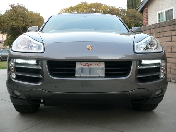

Led DRL installed.

Explain please...
Old Dec 4, 2012 | 03:28 PM
Taiwanese's Avatar
Joined: Apr 2007
Posts: 211
From: Los Angeles
Taiwanese is infamous around these parts
I bought this http://store.ijdmtoy.com/Audi-A5-A6-..._drl_sku77.htm
shave off one side so it butts up with the light (do it on both LED lights)
drill a hole on each side to fish wire through
hook it up to fuse #9
mount to bumper using 3M heavy duty double sided tape
It worked beautifully since.

Bumper removal needed? Thank you so much my dude!!!

Also do these put out a blue color or a white color? Thanks for all the help taiwanese

Crap, should probably think of all these questions all at once huh? Which fuse box are you using?

No need to remove bumper. Connected to fuse #9 in the engine side fuse box so it's on when the engine is on.
The color is very close to OEM (not blue-ish).
My goal was to make it as OEM look as possible.
