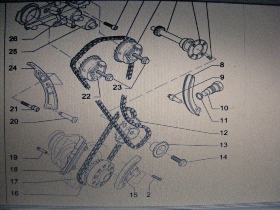

Can you give it gas????(rev up )..sounds like a chain tensioner....at 100k.could also be lifters.....just guessing from your vid........
check this out and compare urs....cheers!!
http://www.youtube.com/watch?v=kCj4vBnUDN8

Chain tensioner? WTF? It's not part of this discussion. This isn't an air cooled 911.
http://www.autofieldguide.com/articl...0205wip14.html

So, I have a chain tensioner on my Cayenne Turbo?
I thought chain tensioners were a problem for older 911's long ago.
Are these just on the Cayenne 6's?

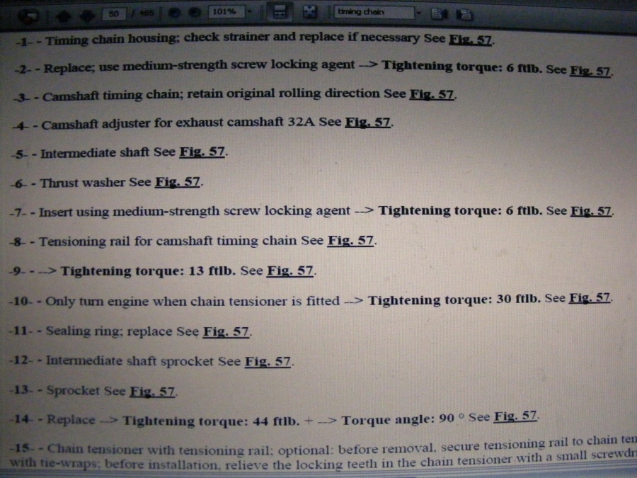

v8's too..but it look alot easier to adjust...(according to the manual)
here you go....first 3 pics..v6.........last pic is v8...

i think lifters are always making noises in these V6 motors.......
I am above 100k and will probably finally take it into another 6 months to get it hooked up to the computer.
chain tensior adjustment looks deep in labor to pull off the front parts of just to get rid of some noise that will return in 10-15k miles......
once it gets above 2k rpms and warms up there is minimal lifter noise.
