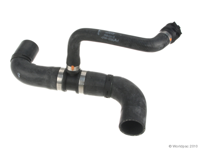

Lou - My guess is you mean the ones in this picture (the top rubber hoses coming from between the firewall and the back of the engine)
If those are the ones, then UGG! If you use the inspection camera that pakundo posted, you might be able to trace them down the back of the engine and then disconnect them there. BTW - I am pretty sure you can buy an inspection camera from home depot - I saw one there 2 weeks ago). Otherwise, I have not seen anyone report a failure of these hoses if that gives you any solace.

Hey Lout - you have to do them. So either now, or later when they really leak. T2 did the pipes at around 100K, and now this tee at 200K. My tee was pretty crusty at the compression joints when I got it out. And the techs (Firehawk?) say definitely do them when you do the coolant pipes on the Turbos.
PM me if you want me to talk you through it. Or tow it to Sacramento and I'll help you do it... ; )

Don't give up!
If it's any consolation, I also sat there an hour into it and almost gave up. Had the exact same thoughts as you - how quickly can I put it back together and tow it in. Could not believe that the stupid tee had even a remote possibility of coming out without dropping the engine. But it did - though one of the harder mechanical things I've ever done. Really big sense of accomplishment when finished. Neighbors probably wondered what the cheering was at 2:00 in the morning.
And FYI, I only replaced the tee connector, not the hoses beyond it. No clue about those, and I had not heard of needing to replace them.
I think if you take it to the dealer, you'll be probably $1000 out of pocket on labor just to get where you are now. And their tech will just grunt through it instead of you.
If you have the replacement part in hand, you know the shape and what it feels like. It drops back and down to the right slightly. As I recall, getting the hose clamps off was pretty tricky, even with the spring-loaded tool. But the real work was again, forcefully removing the tee from the pipes inserted into it. slicing the rubber up the length of the pipe worked for me, and I literally had to jam a wide flathead into the slice to pry off the fused rubber. Once i ripped a big enough piece out, I doused with some sort of lubricant and worked it off like crazy.
Not a lot of help, but click "enlarge" on these pics and you can see it sort of:
http://cgi.ebay.com/ebaymotors/Porsche-Cayenne-Turbo-S-COMPLETE-Engine-Motor-w-tranny-/260727713293?pt=Motors_Car_Truck_Parts_Accessories &fits=Model%3ACayenne%7CSubmodel%3ATurbo&hash=item 3cb4952e0d
I'll try to attach an image - not the exact same part, but best I can find in 5 mins with Google. You're literally going to want to slice into the curve of the "S", from the end to close to the metal compression bands (which is where it leaks, BTW). Sharp blade, held in your fingers... with glove on to keep from slicing fingers!
(The alternative is to drive it hard with the clamps off, until the pressure pops it off... wish I had thought of that when i did mine)
