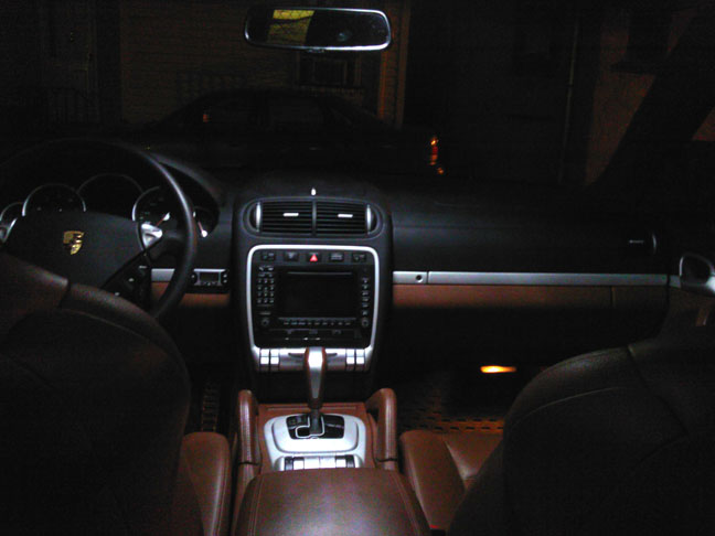

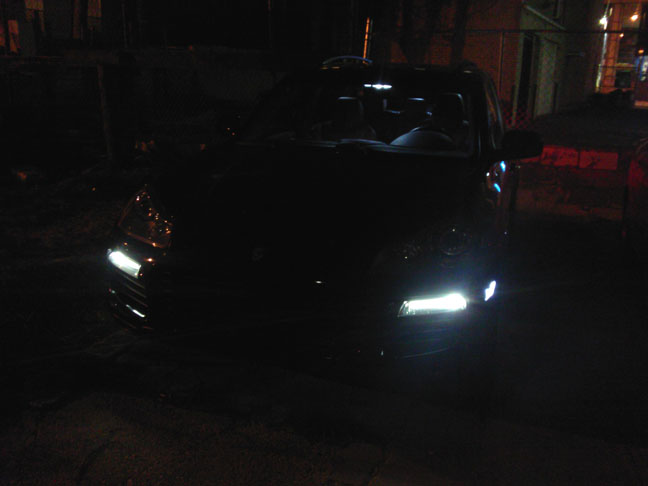

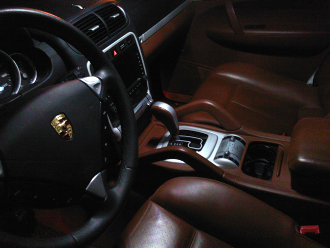

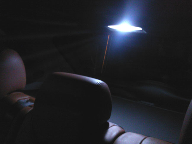

Originally Posted by mikezlee
Sorry I took so long to respond, my camera is terrible, and I wanted to make the pictures as accurate as possible. As for my interior with chestnut, not very flattering. An all black interior might look much better. I've also included a pic from the outside. This is the reason I changed the ceiling lights to LEDs: to match the outer LEDs, and it looks quite nice when I unlock the car at night and all the lights go on(including under the mirrors).
Attachment 145407 Attachment 145408 Attachment 145409 Attachment 145410

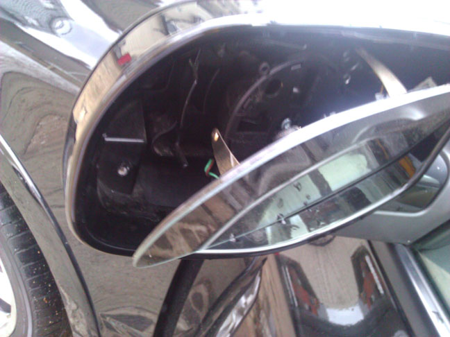

BTW, the mirror replacement is actually one of the easiest bulb change. Just push the right part of the mirror all the way in to make the left part come out towards you. Put your fingers behind the mirror on the left part and just pull. Takes a little bravery, because it feels like you're breaking it while you pull, but it comes right out. I've attached a picture of the mirror too.
Attachment 145411
Sorry, when you say push the mirror right all the way in.... Do you mean push it or use the electric button to adjust it? Or could I just push it manually in?? Hope Im making sense.
Old Oct 31, 2012 | 09:18 AM
  #50
eVoMotion's Avatar
Joined: Sep 2009
Posts: 241
From: PDX, OR
Rep Power: 42
eVoMotion has a brilliant futureeVoMotion has a brilliant futureeVoMotion has a brilliant futureeVoMotion has a brilliant futureeVoMotion has a brilliant futureeVoMotion has a brilliant futureeVoMotion has a brilliant futureeVoMotion has a brilliant futureeVoMotion has a brilliant futureeVoMotion has a brilliant futureeVoMotion has a brilliant future
You can electronically move it to one side and easier access to get a hold on it with your hands so you can then pull.
Old Oct 31, 2012 | 09:22 AM
  #51
Pker's Avatar
Joined: Apr 2008
Posts: 78
From: HK
Pker is infamous around these parts
Gotcha, thank you!!
