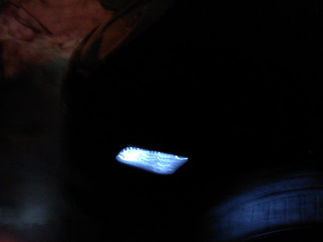

Originally Posted by mikezlee
Roxboxxx, thanks for this. I will try out those bulbs. Hope they are whiter than what I have now. I use LED bulbs for my mirror lights and side markers, and just looks too blue. I'll take pics after I try out your bulbs. Attached are side markers and license plate lights(different bulb). Not really digging the rice blue look right now.
Attachment 144369
Attachment 144370
Also, do the foot lights still dim to your desired brightness?
Do you know what is the bulb type for the license plate?
