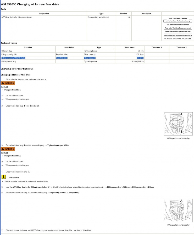

The type of diff oil used and directions on how to change it is not included in the owners manual. Curiously enough, a few other technical documents fail to list the specific type of gear oil used. With that said, there are not many gear oil options available for this application on the market- most use 75W90. Considering Porsche uses Mobil fluids, Mobil 75W90 sounds right to me.
In regards to the friction modifier, it is an additive that is needed for limited-slip and clutch engaged differentials to work properly. It is better to have the friction modifier and not need it, then not to have it and need it. As such, most gear oil will have these additives. Just look on the label for something to the effect of "friction modifier additive" ,"LSD" or "limited- slip approved".
You will also need a pump or fluid evacuator to change the oil properly.
Here are the instructions on how to change the rear diff fluid. For your application, it will take 1.4L of oil to refill.
Post pics and share with others if you get a chance.

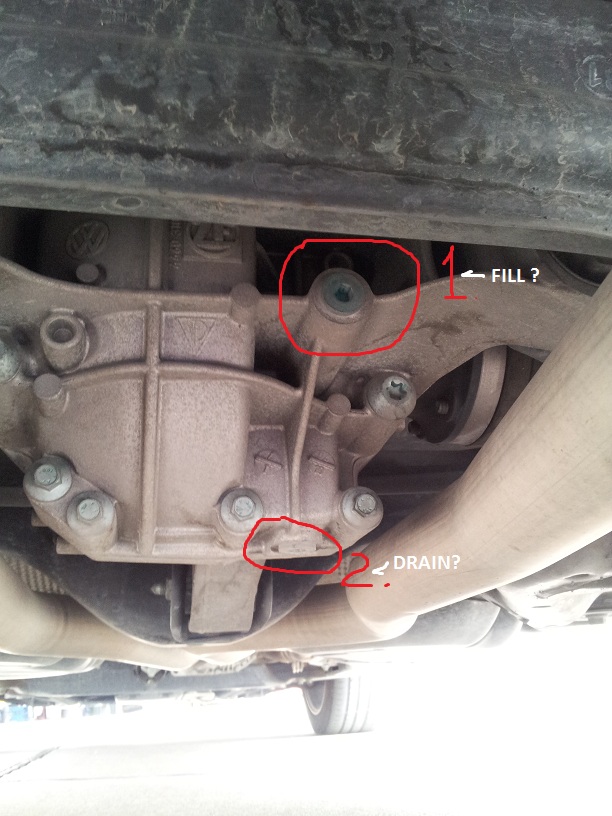

This is a pic from the rear of the car (looking towards the front).
Can you confirm that this is the rear differential, and #2 is the drain plug, and #1 is the fill plug
1 - fill plug
2 - drain plug
Want to confirm before doing the job. Thank you yet again.

Looks right to me.
One worked of advice. ALWAYS make sure you can get the fill plug out first!
