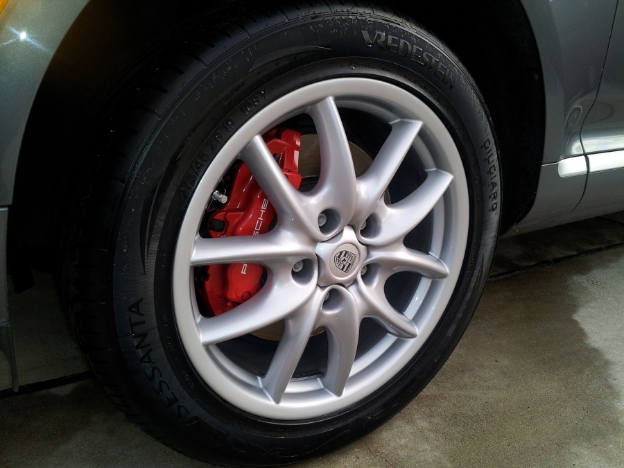

I have been reading a lot about which tires to put on next.
With the existing ones wearing out, I found myself being more 'trigger happy' on the gas pedal through turns, etc.
This, in my mind, was getting me closer to a new set of tires.
Through research and views of those who have had them before, I decided on the Vredestein Sessanta tires. Stock size 275/45/19.
Thought about going one size up in width (285) but in the end decided against. Would be good either way.
The stock size looks a little bit fatter than the old tires I had on there (michelin Latitude sports).
Have only got a few miles with these, but I can really tell less tire noise while driving (even when old ones were great condition).
Have not been testing grip yet, but I am sure it will come down to that soon (lol) - with the F1 coming to Austin in a few weeks, I am sure we will have tons of people day dreaming on highways here).
Here are some pics...

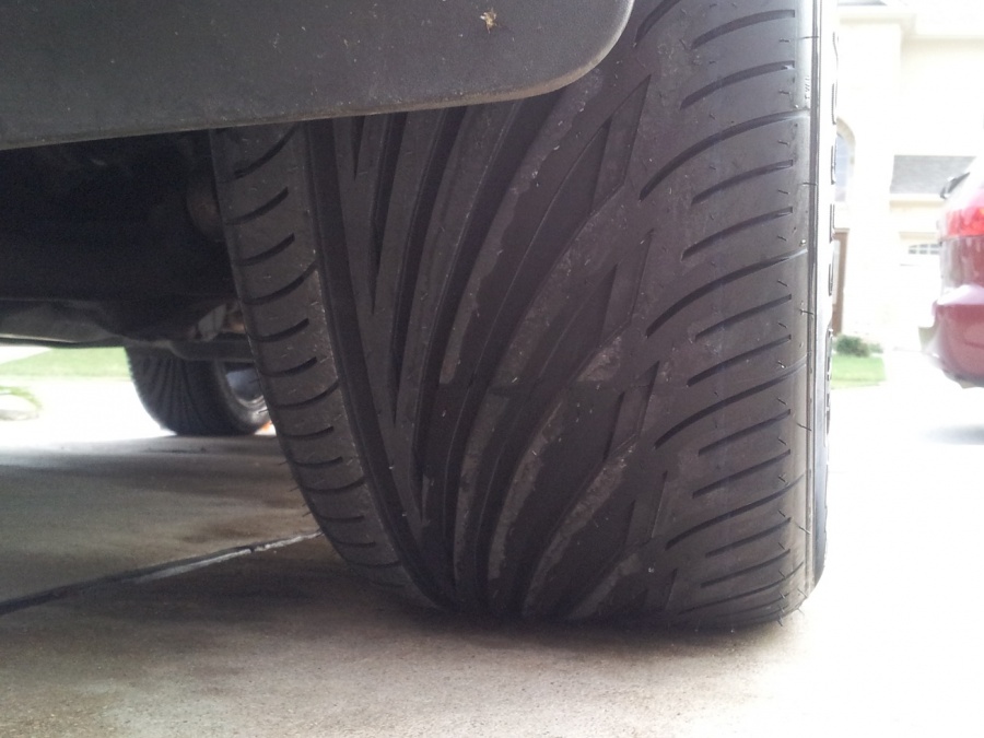

Each tire has a very distinct 'INSIDE' pressed on sidewall, making it impossible to miss and thus mount improprely.
The main groove to inside of car and the wedges radiating out towards the outside.
Also, if you check the Vredestein site you will see same mounting for tires on cars (with main groove inside).
When you check the website for the tire, it also states the tread is non directional.

It weird because I see what rymo is talking about. The grove is on the inside but why would the outter tread v out in different directions? One v out downwards and the other v out upwards. Strange to me but maybe thats the design.
I thought it was strange but it appears part of the design.
Go to their web site and read/view videos. They specifically state non directional and when watching videos you will see the grooves there too.
The purpose is to channel the water from under tire, which the grooves do, regardless of their orientation. Otherwise they would have to design one tire tread for right side and another for left side (manufacturing complications vs. inventory vs. stock, etc.).
Either way, I used them and they kick ***. Literally.

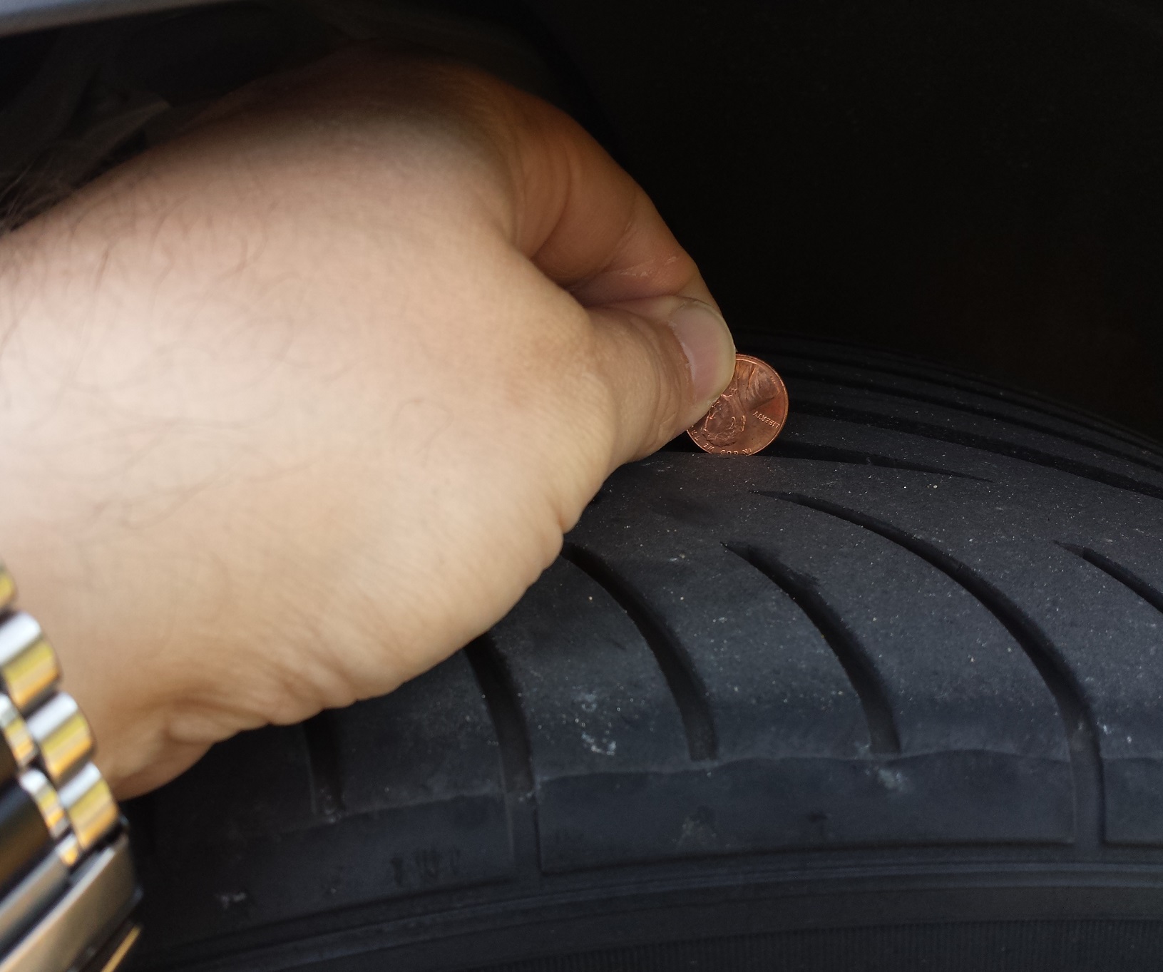

Including pics of what the tread looked like at replace time (compare with pics from first post - new).
Thanks for reading. Now, maybe those who are looking for tires will have a decent info to try to compare to.
I will post my reviews on the next tire as well, to add to the pool of info for Cayenne users (maybe other SUVs too).

Ciaka's evaluation is near spot on. These tires kick ***. In ALL aspects.
The directional tread pattern has one purpose according to the designers,
noise cancellation. One side cancels out the other side. That's why when mounted it looks as if one side is backwards. The tire is not directional but does have only 1 inside Don't worry, you will get over it.
I get about 12k per set. Its not going to get better. I drive hard. Usually my tires are worn on the inside from camber and the CTT's design. It's going to happen if you drive like granny, it's going to happen faster if you drive like Andretti. The wider your tires are, the more the insides wear. When my inside edge is worn, there is usually about 3mm tread left across the tire. I'm over it, you should be too.
The ONLY 1 downside I have noticed on this tire compared to others with larger shoulder blocks on the inside edge of tread, is that with the smaller shoulder blocks and that circumfrential groove, Inside edge wear seems to be faster than say.....the michelin lattitude with much larger shoulder blocks.
