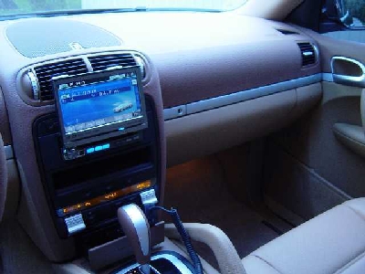

I am currently running an Alpine AVD-900 head unit

Did you make a frame for the head unit since the stock one is much bigger than the alpine?

Yes I did. My stereo guy made a frame out of MDF.

How come they dont mount the stereo right above the temp control, so it wouldnt cover the vent? just wondering...
yeah, i don't get the either.
why not install it in the lower DIN.

There was some sort of fitment problem. The panel was made from scratch and it looked like it was the only way things could fit...
