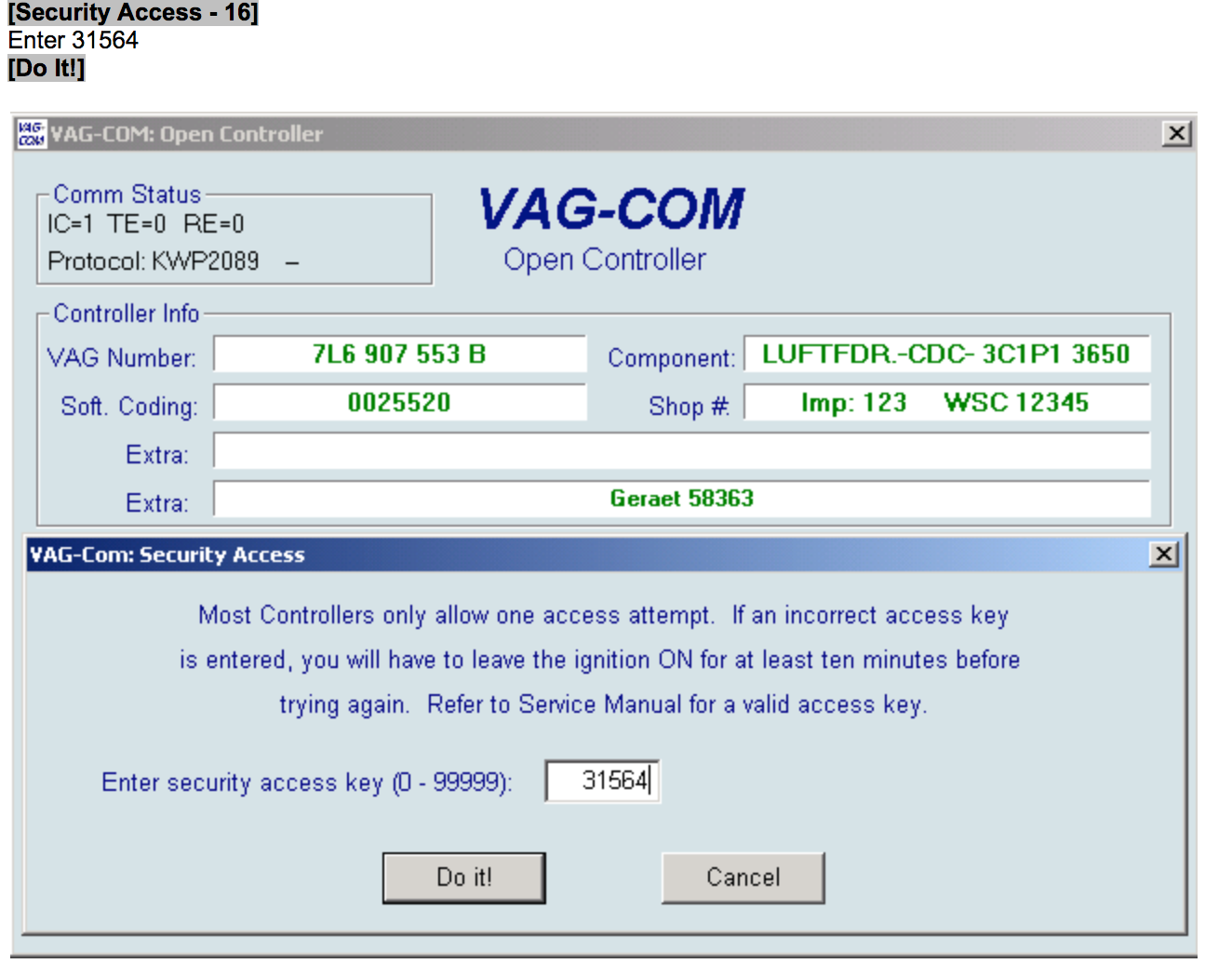

Yes, I got the HEX-V2 Enthusiast from ross-tech.com. Just follow the instruction for Touareg suspension calibration.
i got a cable HEX+CAN from one of my coleagues. It is not the V2 enthusiast is the previous version unlimited.
so i installed the VCSD and i strted to look at the instructions. Looks like i will need a code (see the attached picture).
should i use the same code for CAYENNE ??
No answer from durametric yet...
Yes.

i received from durametric a new version 6.3.5.8 ... as expecteed is still crashing and is giving me the error 1437...
i tried from one of my coleagues the ROSS+TECH cable and looks like it may work ... still the security code is not accepted, but at least is not crashing and you can clear some codes ... not the 1437 though ...
