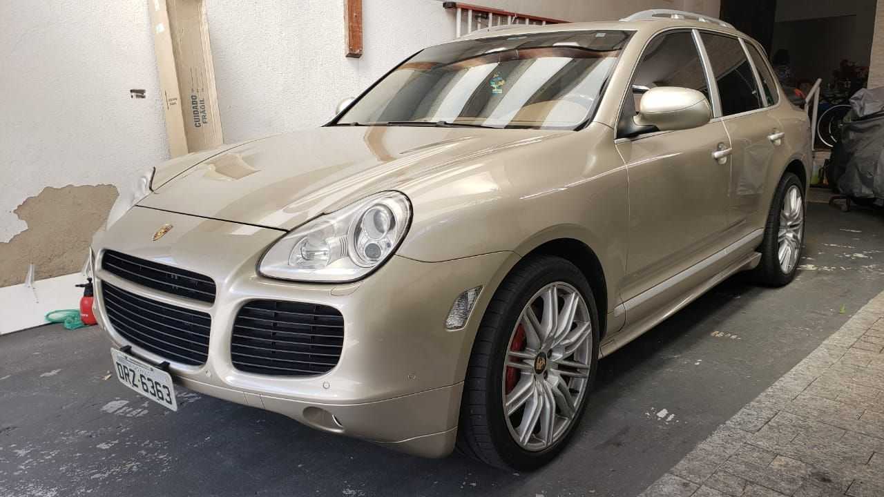

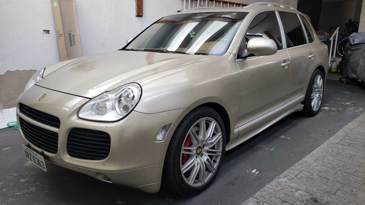

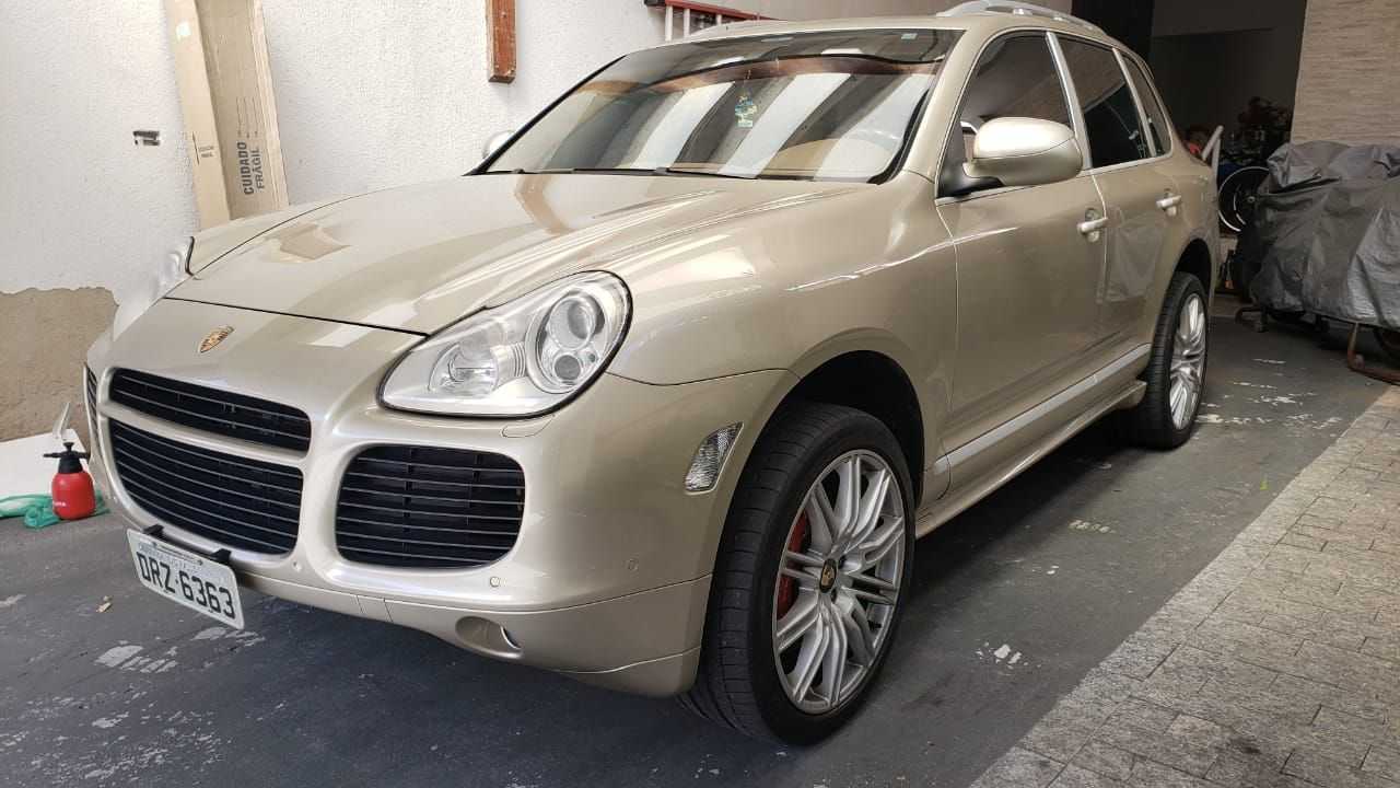

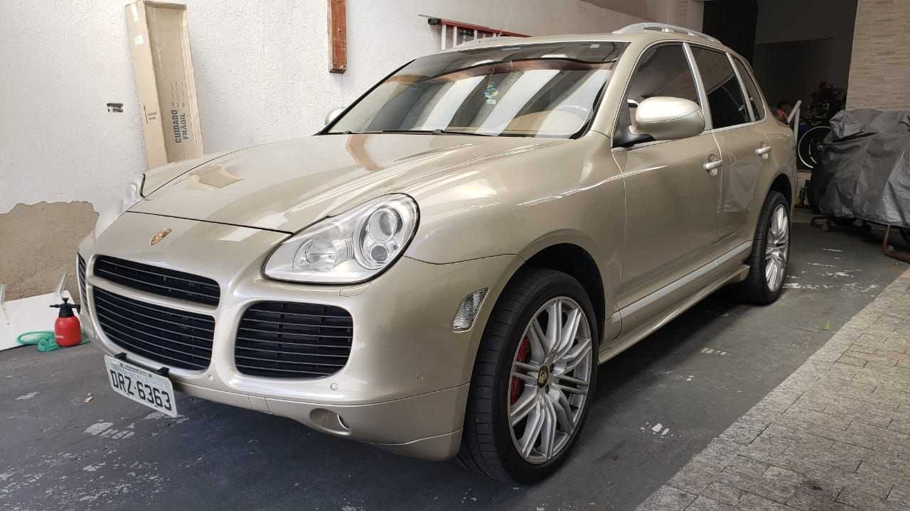

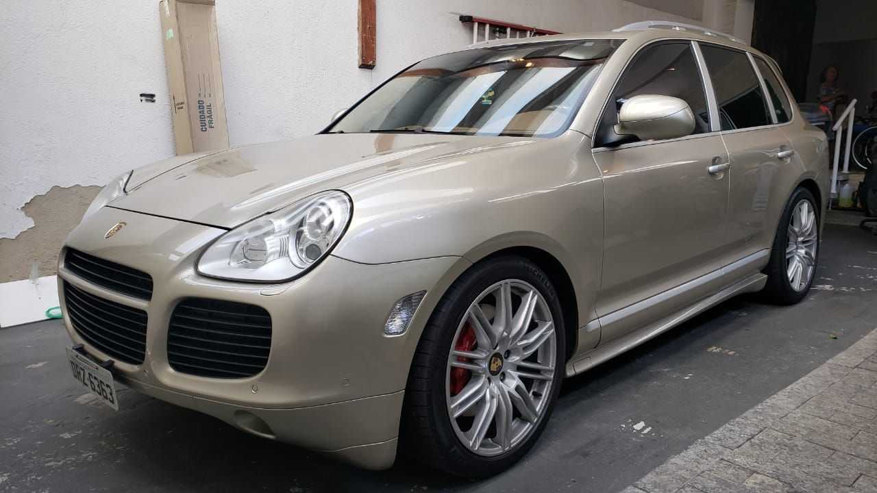

Hello guys, this weekend I had to redo the level adjustment of my cayenne 955 turbo 2006. In Brazil I didn't find durametrics so I managed to do it for Piwis I had exactly all the difficulties that they reported with durametrics, for no apparent reason in some moments it lost the value that I had set and presented the error message, I lost about 5 continuous hours in this service, cooling the compressor with every rise with a jet of compressed air. My car got 182mm in the front (didn’t accept 1mm more) 225mm (didn’t accept 1mm more) the center of the front wheel measured 44cm and the center of the rear wheel measured 46. The rear was not as low as those of the photos they posted , is it worth trying more? Does each car accept a maximum amount?
Thank you for any help, if someone wants to sell a cable preferably used with low price I buy.
max accept
loading level
low level
normal level
terrain level
max level
before Piwis loading level
