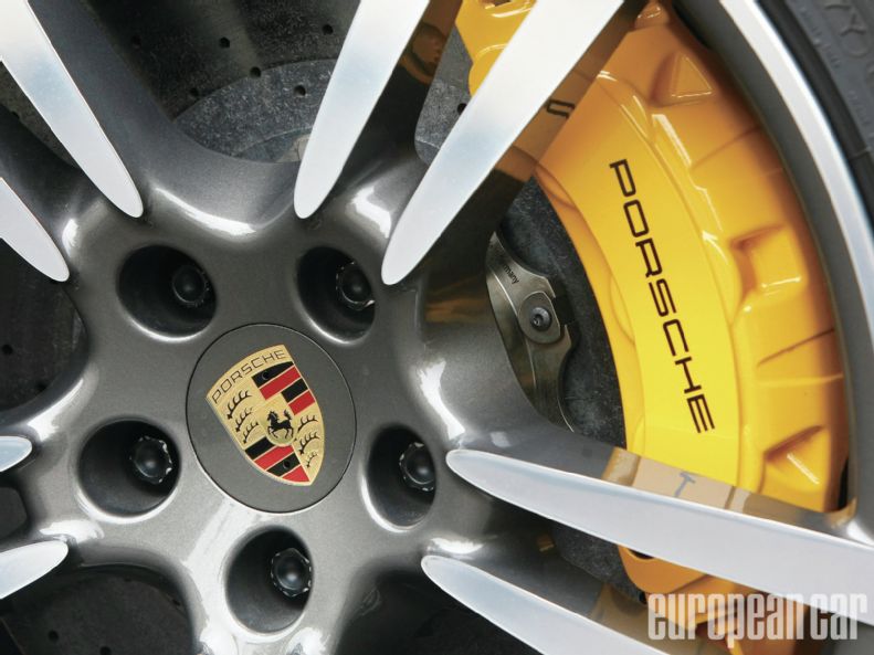

I've been looking at 991 images and every single one of the so far has drilled rotors on it!
Porsche must be throwing caution to the wind! Obviously just for looks and won't cost anything to replace all those under warranty.
Old Mar 22, 2013 | 02:05 PM
Cole's Avatar
Joined: Sep 2005
Posts: 1,160
From: Colorado
Rep Power: 70
Cole is just really niceCole is just really niceCole is just really niceCole is just really nice
2013 Cayenne GTS with factory brakes.

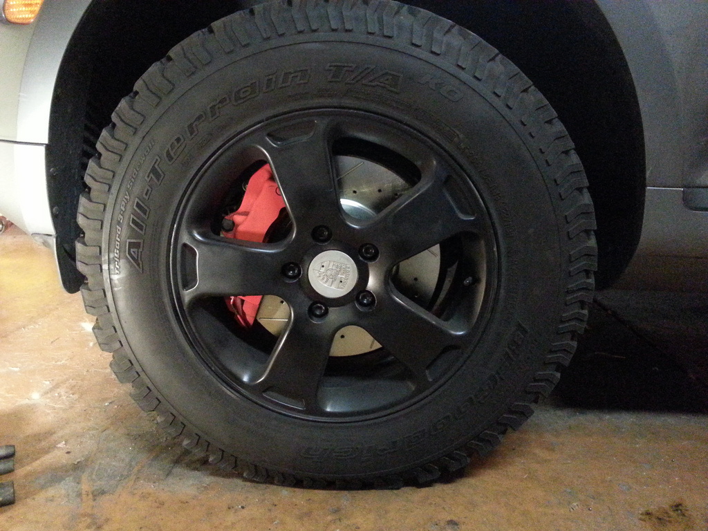

Not sure if you bought your brake kit yet.
I recently put on the Powerstop kit. Part number "K4500" for the turbo. (There is some confusion about the part number on some of the sites. I verified the right parts with Powerstop).
Came with pads, discs and new sensors for right around $500.
Both front and rear are drilled and slotted. (Lightly drilled as you can see).
My Cayenne has seen track use but more importantly it tows a car hauler over the Colorado Rockies from tie to time, and I run 265/65/18 in the winter and 22s in the summer. So getting rid of excess heat trying to slow down a trailer, even with trailer brakes, is why I went with these over standard rotors. And of course they look "more Porsche"
