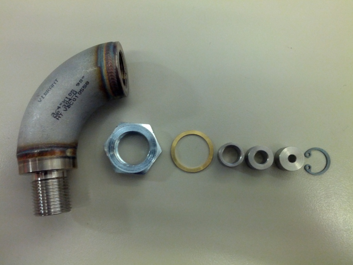

Your wish is my command!
You will need something like this for your 02 extender (attached). Pretty slick setup with the short right angle, 360 degrees of adjustability, tuneable inlet ports and SS 304 construction.

that is pretty cool. source?
after a closer look, source is found
