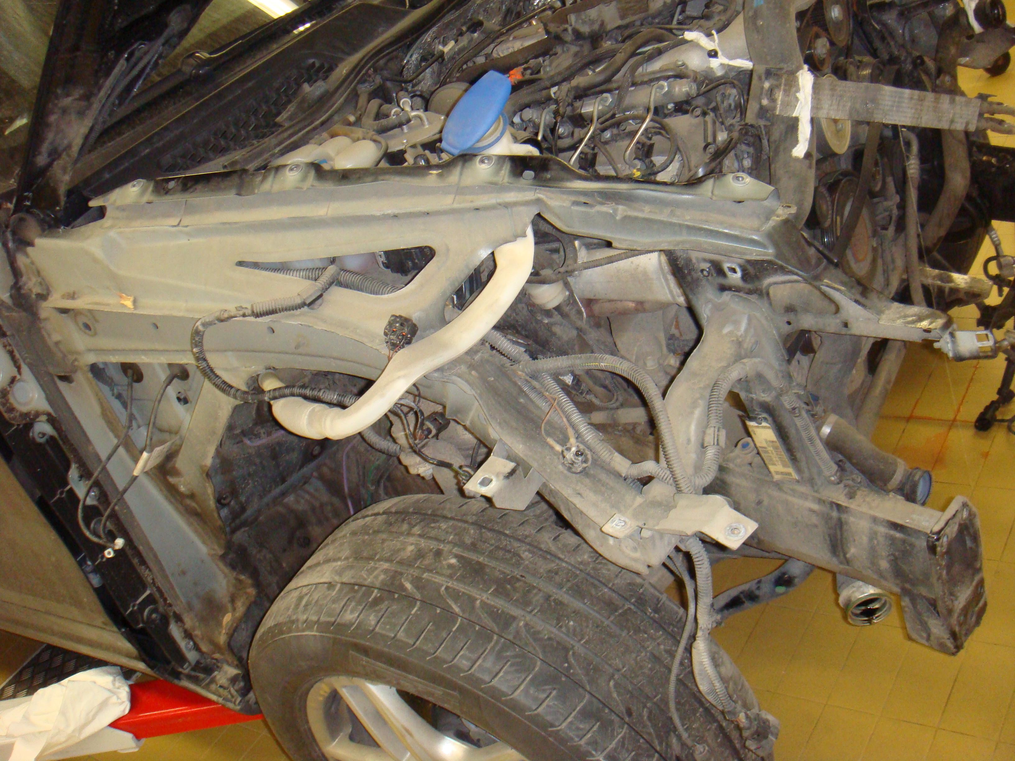

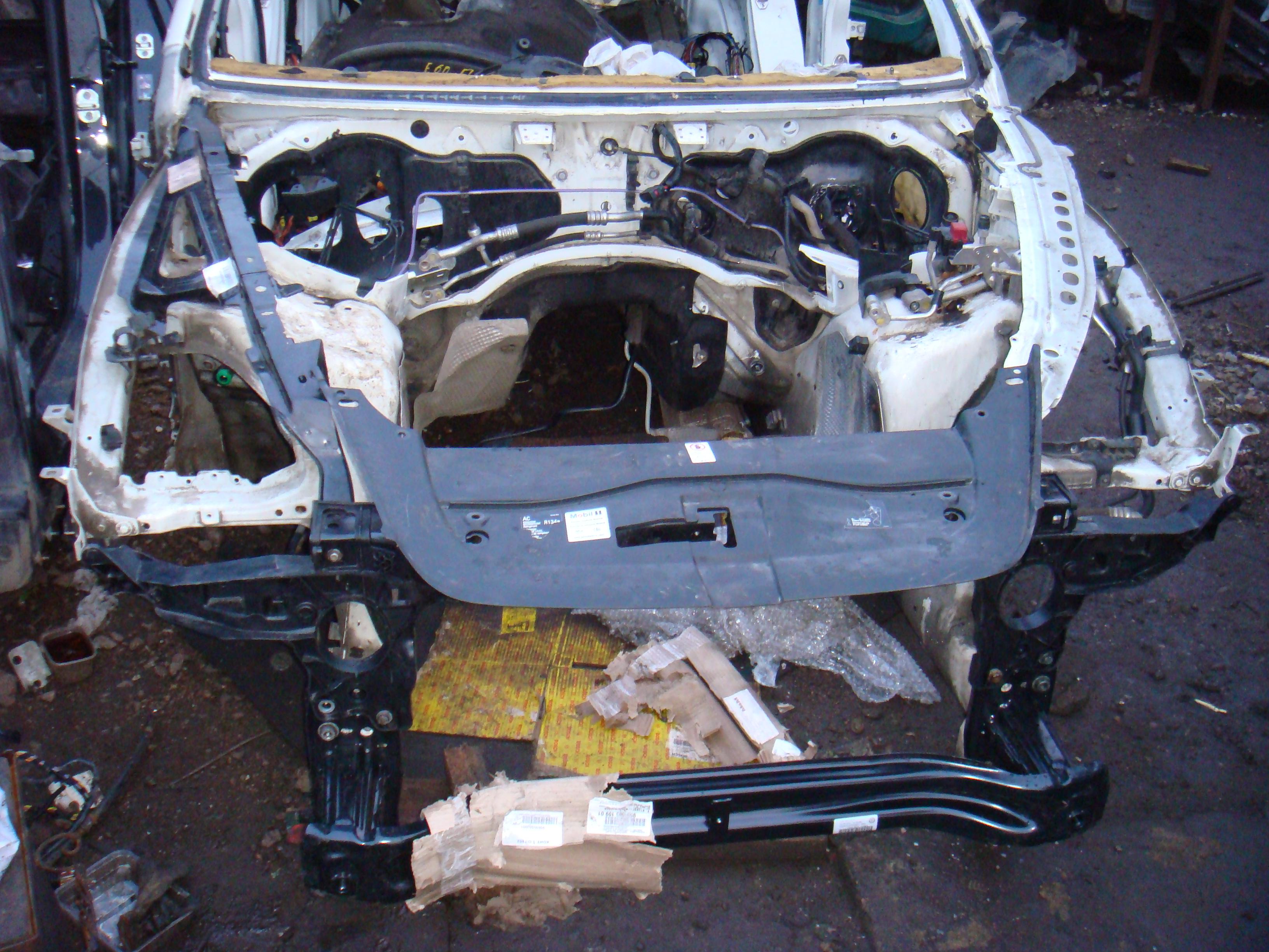

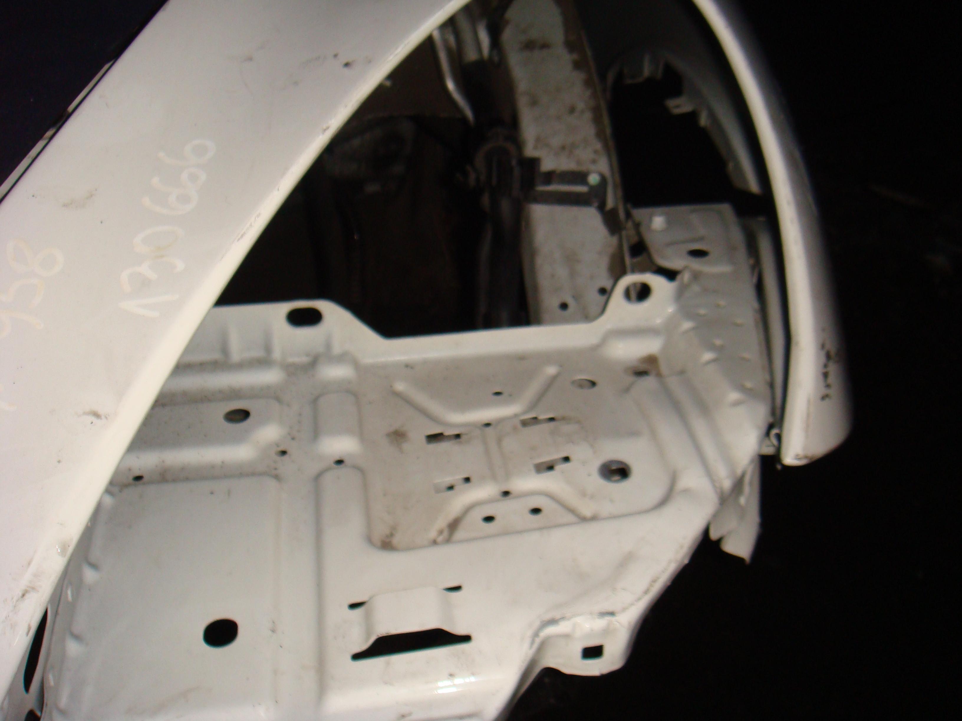

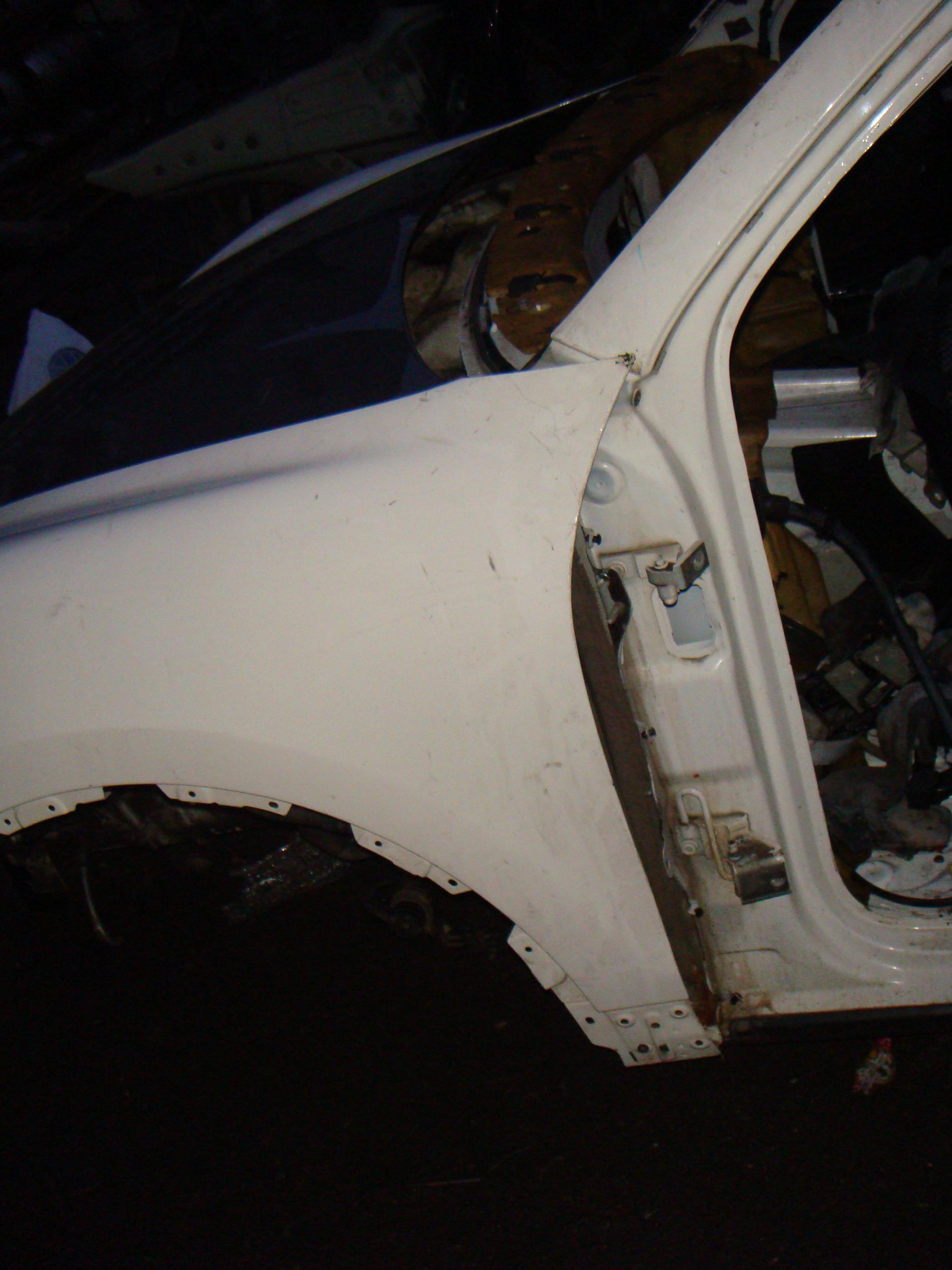

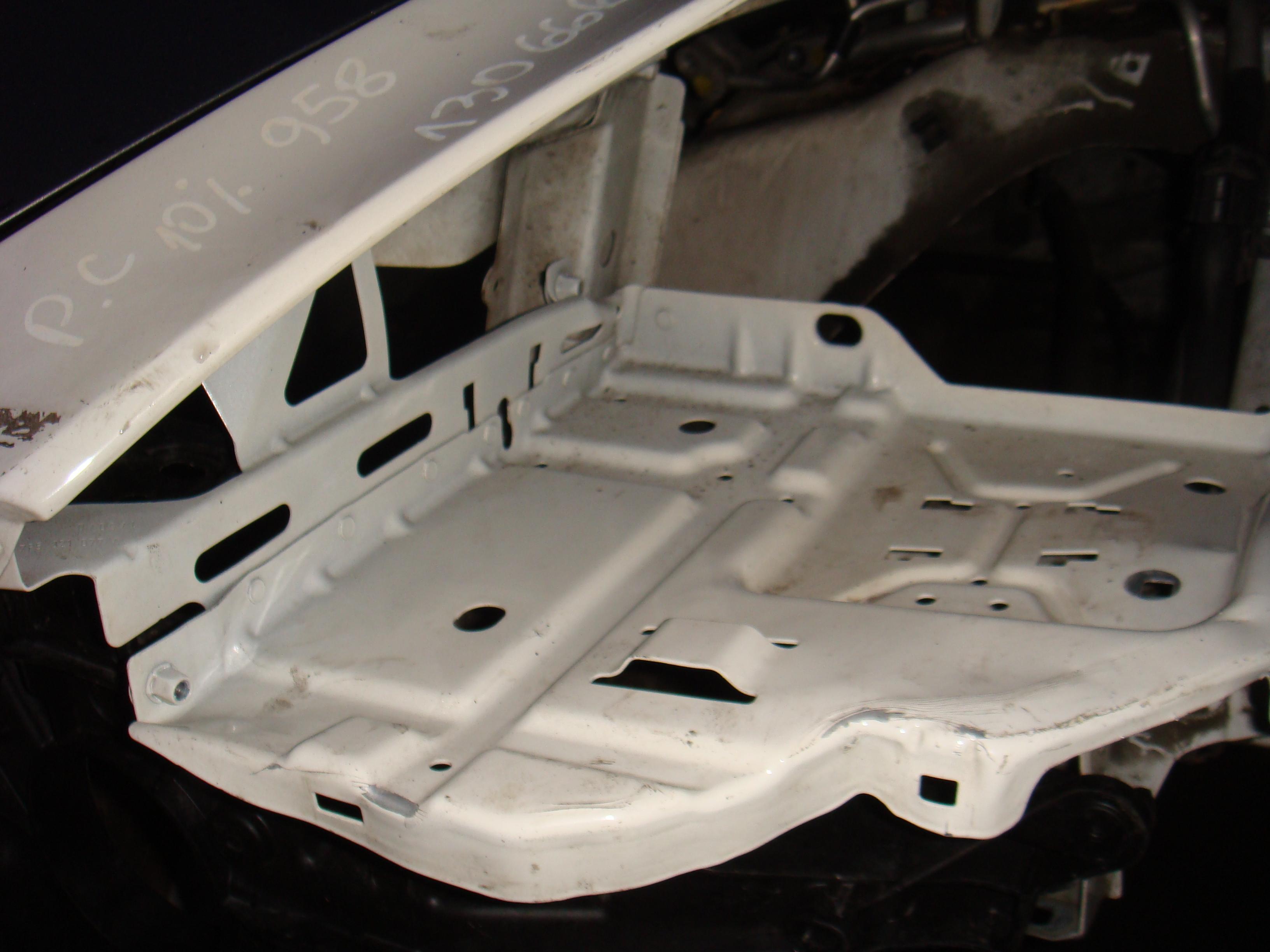

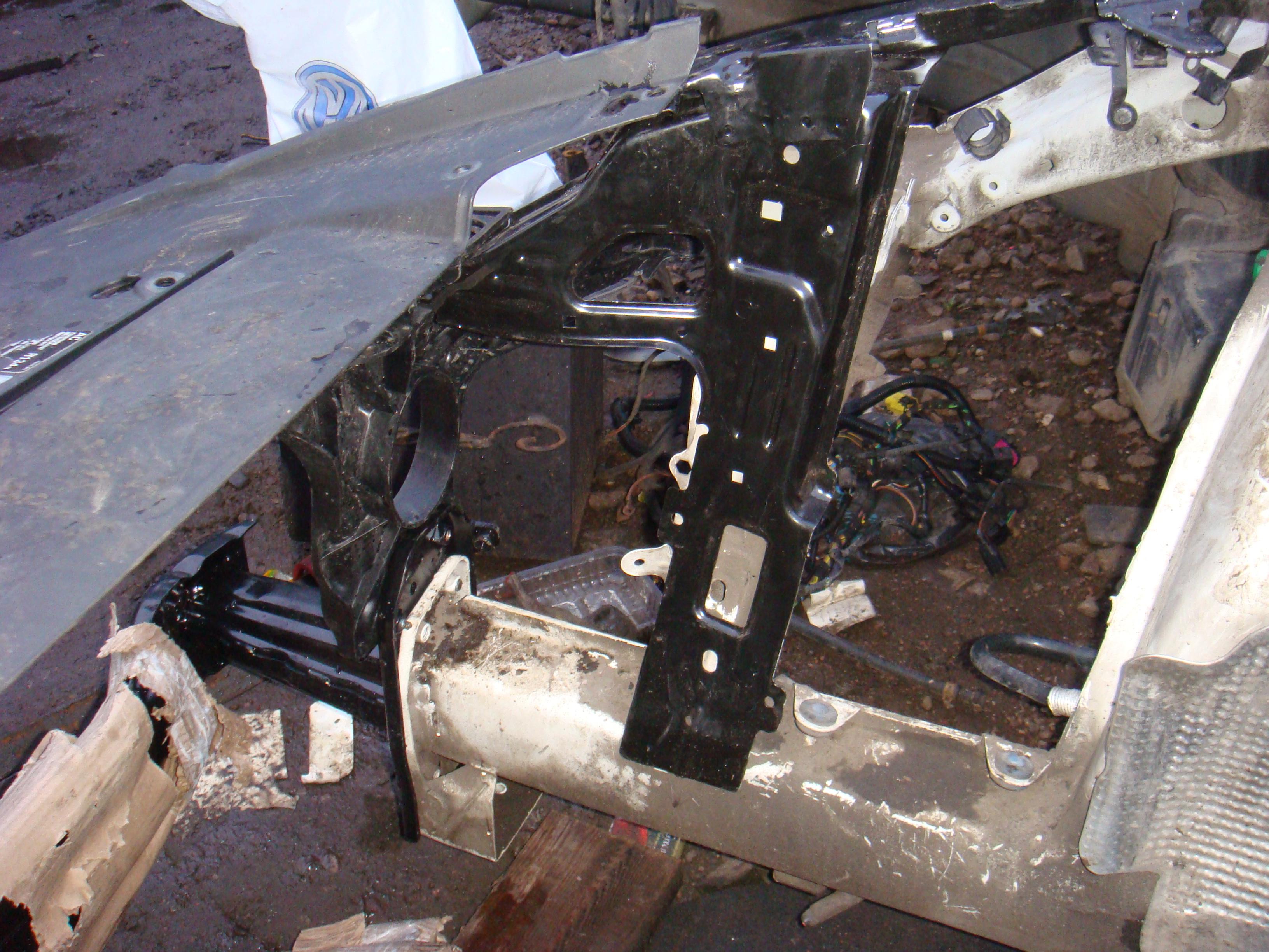

I've checked 957->958 nose fitment long ago.
you need to re-weld front top parts of chassis (wings holders) with 958 parts,
then front end can be fitted with all 958 parts even hood with hinges, but still fenders will not fit doors and chassis at doors, so you need to cut out headlight holder and fit it to custom made fiberglass wing - front are 958, rear are 957 - with rivets.
and you will need to custom made radiator holders since from 958 won't fit old radiator.
ID:	370591   Click image for larger version
ID:	370592   Click image for larger version

I think this is no way. You see there white angled headlight supports/front mount holders behind black 958 parts? They are also need to be cutted, and replaced with 958 because they about two inches higher than needed to be to accept 958 headlights. But of course you can try.
first picture is 958, bit wrecked )) but you can see difference
next two you can see where new wing didn't fit old chassis
last is new part over old ones

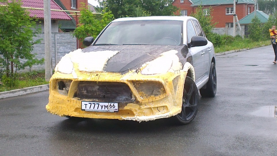

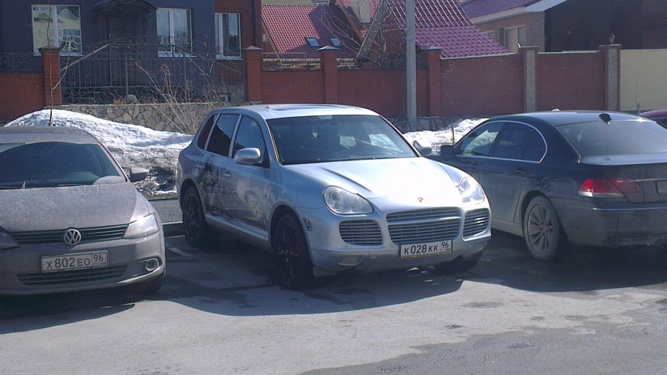

all I can say - go ahead personally me saw at least two tries of such economy ended with nothing... even this - ended with simple 955->957 facelift
Old May 7, 2014 | 10:34 AM
TT VIPER's Avatar
Joined: Jun 2008
Posts: 138
From: Europe
TT VIPER is infamous around these parts
Arrow
Wow. That's a lot of work in the picture. But it looks like the conversion to 958 is almost complete in the picture. Why do say it ended with nothing? It looks like it's almost complete.

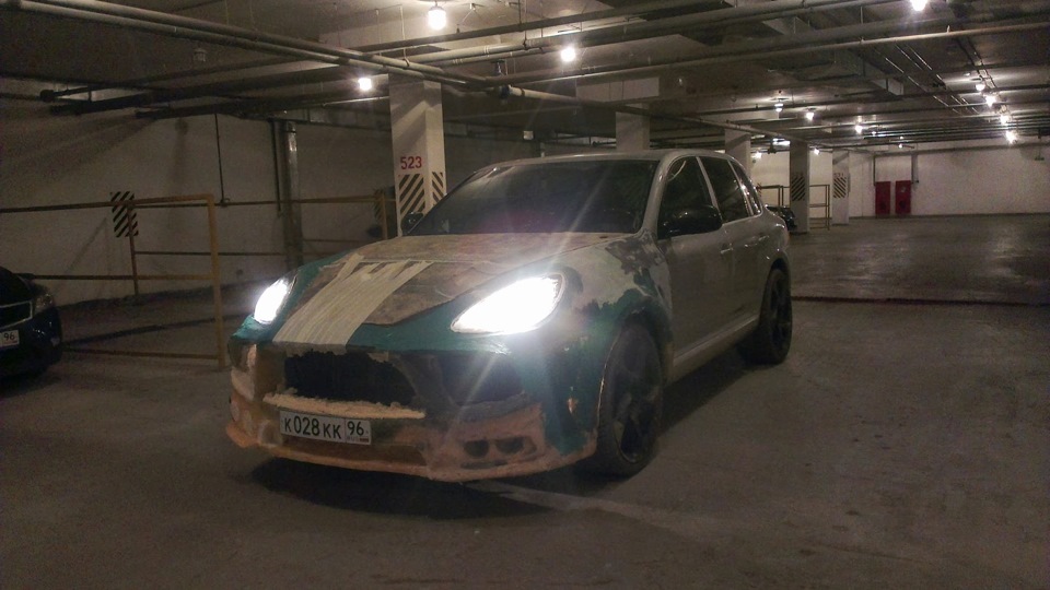

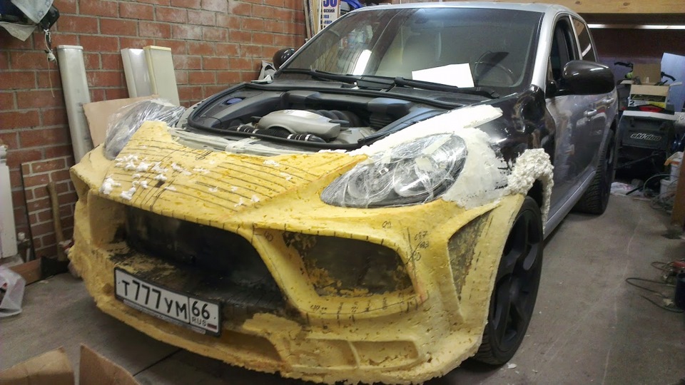

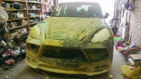

that's not my car on photo ))) maybe too much foam and filler?
this is start and ... end at second photo
ID:	371736   Click image for larger version
ID:	371737   Click image for larger version
ID:	371739   Click image for larger version
ID:	371740   Click image for larger version
