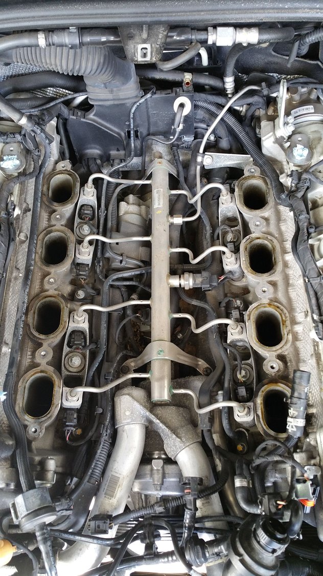

I replaced the plastic pipe under the intake manifold and secured my fitting the other day. My CTTS has 90k miles on it and as far as I can tell, it has the water distributor. Mine was in there quite solidly though, and I wasn't able to budge it with moderate effort, so I safety wired it and applied a little JB weld for the hell of it.
Intake manifold off
Close-up of under the intake manifold area.
Fuel rail off
It turns out that this is where my slow coolant leak was coming from. Notice the coolant residue at the bottom of the vee.
New coolant pipe installed.
This is what my water manifold fitting looked like. No evidence of a leak and could not budge it.
Water distributor fitting safety-wired to the water distributor casting.
Make sure to order the camshaft stopper and a new HPFP o-ring. Mine disintegrated upon attempting to pull it out. I was very worried that I wouldn't be able to get it out of the camshaft, but a pick with a 90 degree head was able to coerce it out after a while.
This is looking at the back of the camshaft with the HPFP drive installed along with the new, plastic camshaft stopper.
