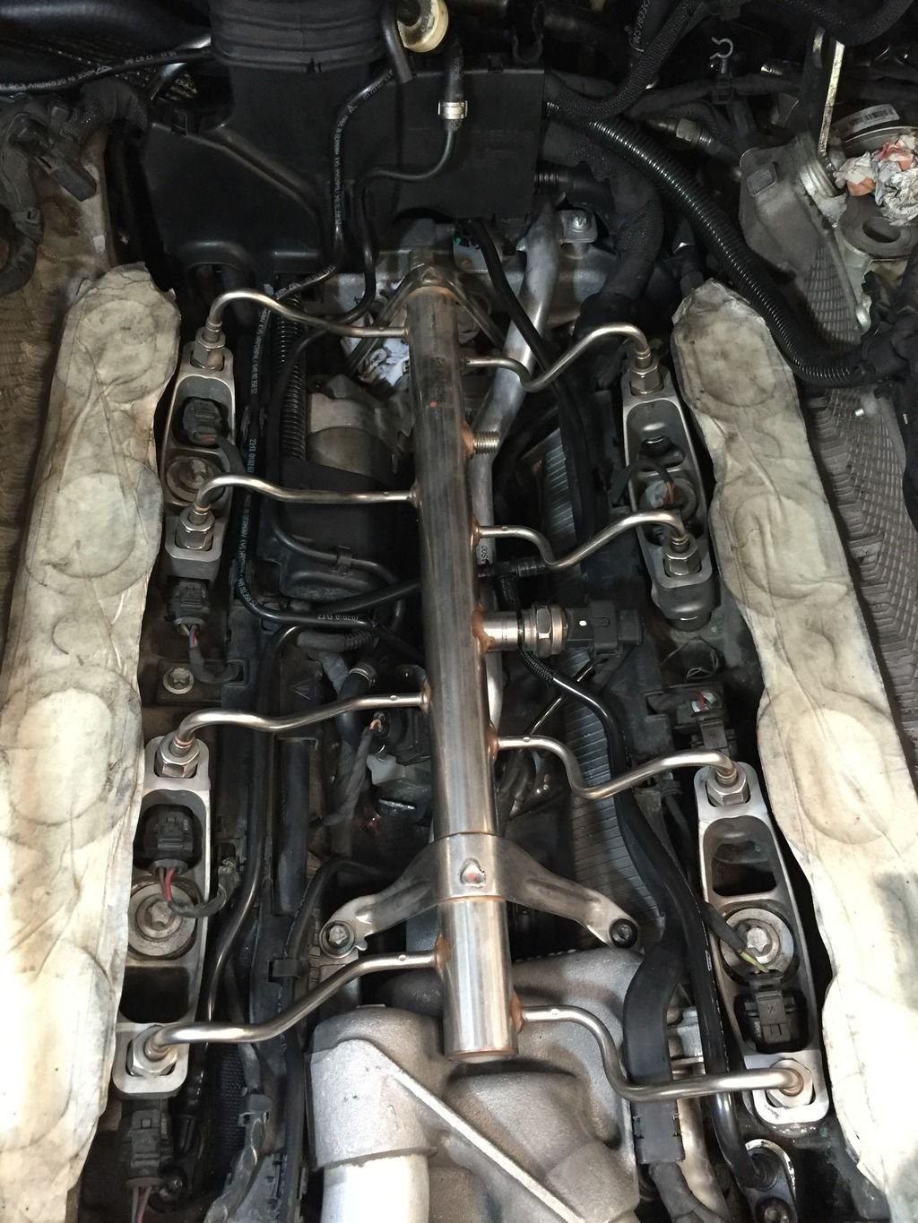

Quick update on the cooling pipe upgrade and coolant distrubutor replace. The remaining rubber hoses finally came in the mail last thursday and re-assembly is going slowly but surely. We had slight difficulty installing the gaskets on either side of the coolant distributor housing. Again space (lack of it rather) was our biggest enemy.
New Distributor installed and aluminum cooling pipe in place.
Fuel rail re-installed
Also, a correction on my previous post, we didn't have to remove the downpipes or cats. We were toying with the idea of doing so to access the rear of the coolant distributor but in the end, did not remove anything from underneath the car. I long socket wrench adapter did the job.
Hoping to have all other bits and intake manifold installed by end of the day Monday.
