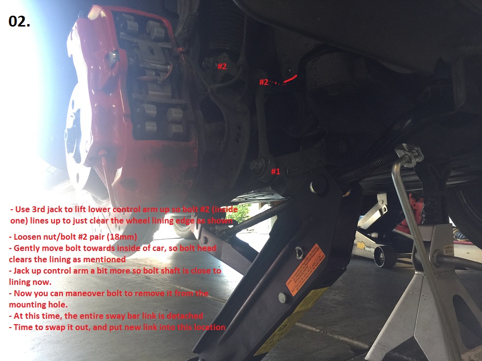

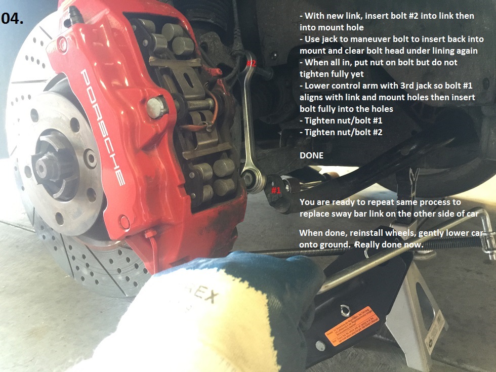

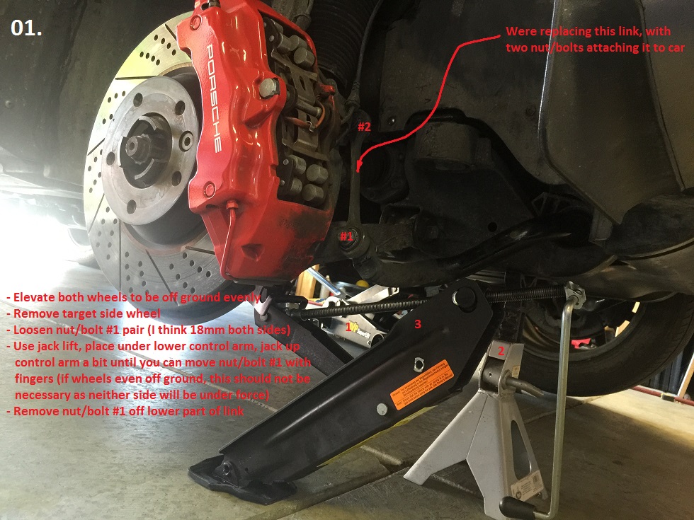

Part of my suspension refresh was replacing these.
Hope it helps the next person.
There are multiple ways to elevate the car. The ideas is to have front elevated so both wheels are even, and neither side is torqued due to being flexed.
So have the car off the ground however you need. Then have a mechanism to be able to maneuver lower control arm up/down, so you can remove the upper nut/bolt from the link and mount holes.
I opted to use 1 jack stand, lift jack on opposite side (to make sure both wheels are even off ground. Then used jack lift to adjust lower control arm to remove the long bolt, and reinstall new one.
Good luck. Follow these pictures in the order you see them, read all instructions and make sure you understand them. Then do the step.
Have fun.
