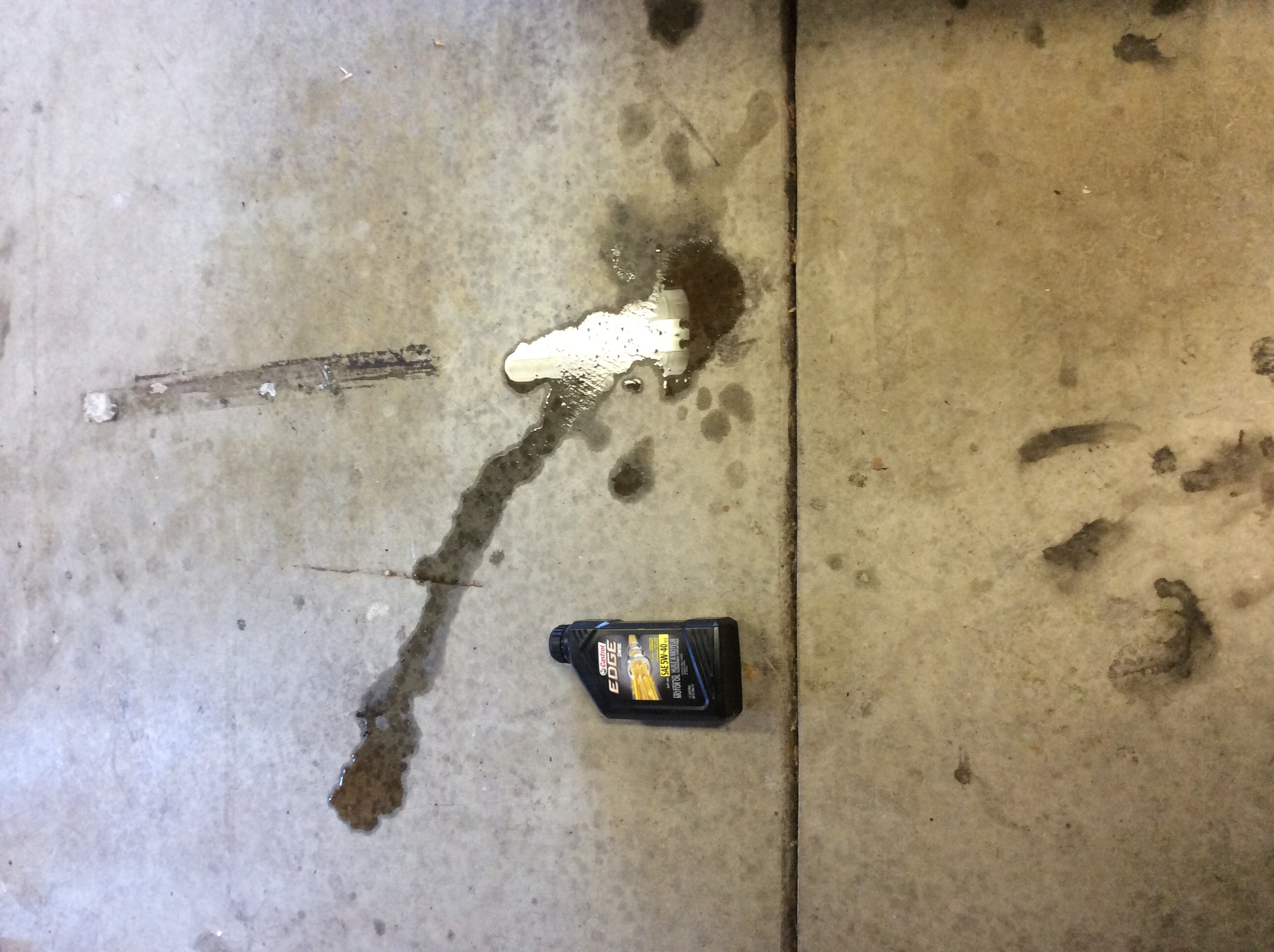

Parked car in garage after work. Today wake up, get into garage and find this (pic below). Right away start swearing. Get my juices going.
Anyone can suggest possible areas to look at?
Remember about 3 or 4 weeks ago I 'topped' up the coolant reservoir (container with the blue cap on driver side of engine compartment). Topped it up not to the upper edge of yellow plastic that says 'max', but to the bottom edge of the container opening (black plastic edge that the blue cap screws into).
It was much cooler then still outside. Over last few days it's been much hotter around here and I wonder if the resevoir just overfilled and let coolant out the overfill hose on that container.
Any ideas? Really appreciate it. Thanks.

Old Jun 13, 2015 | 01:53 PM

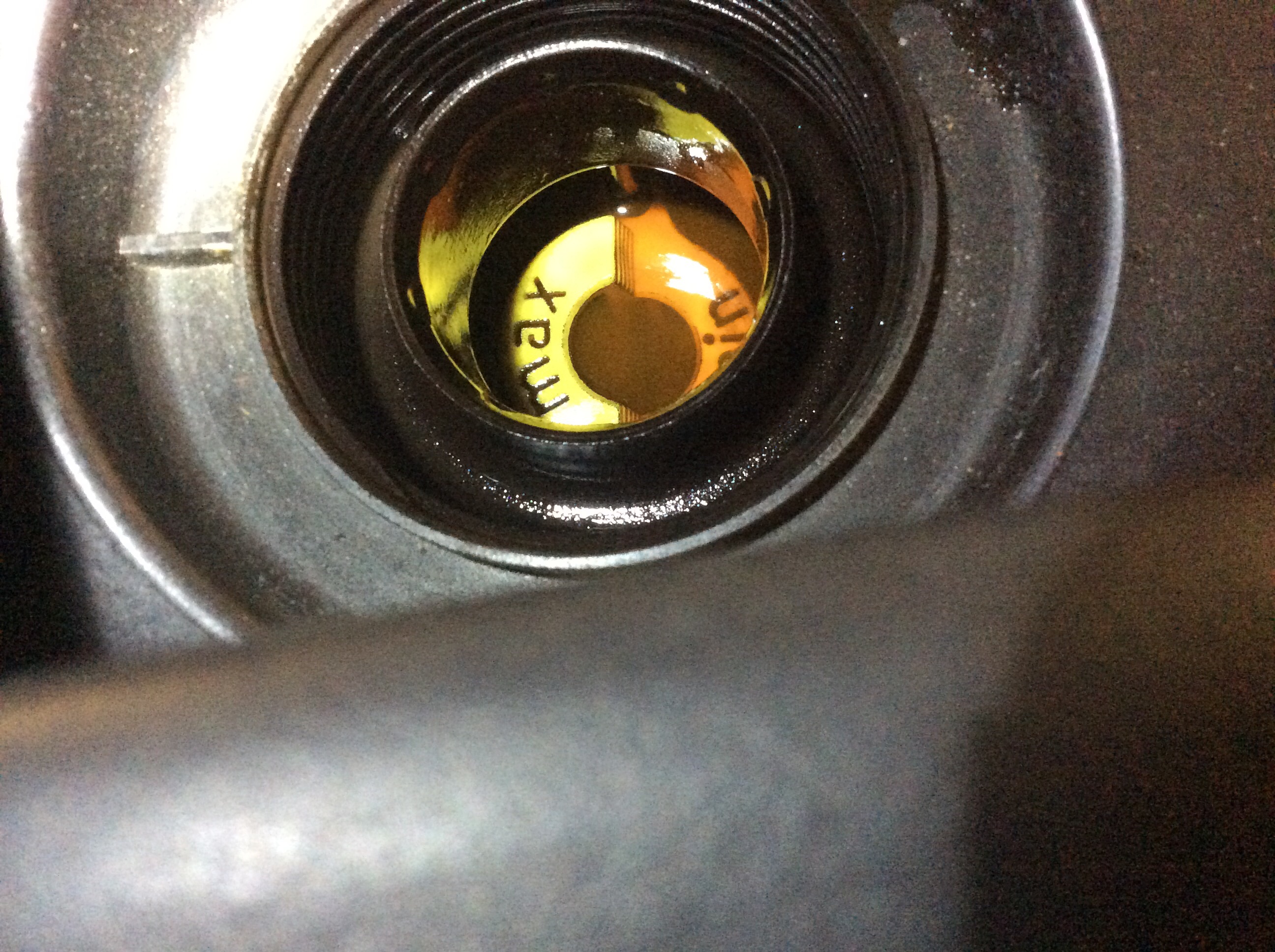

Pic of resevoir and where level is at now after purge. Appears to be at upper edge of the yellow plastic.
When I initially topped up, it was up to bottom edge of black plastic.

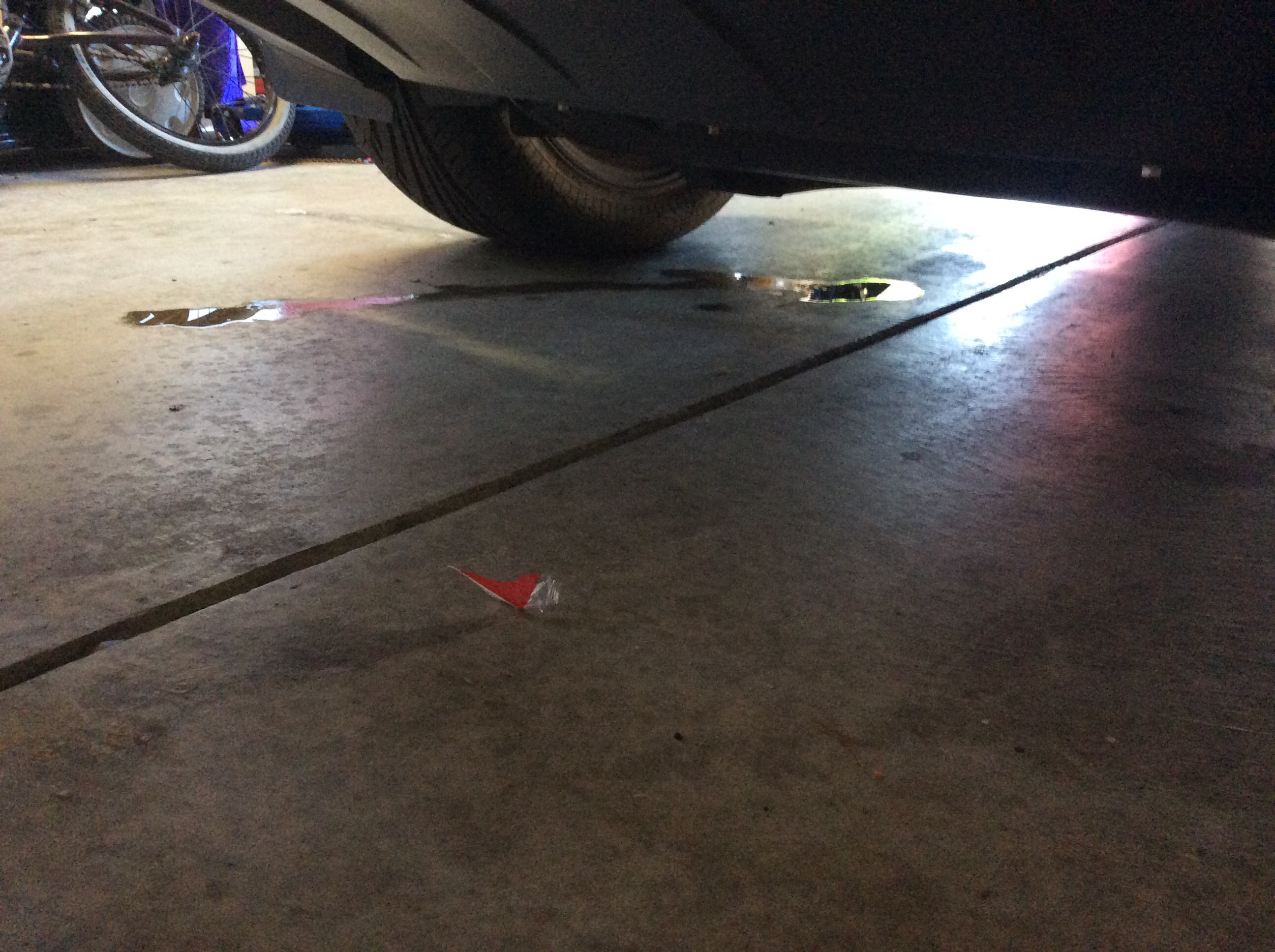

Puddle after moving car.

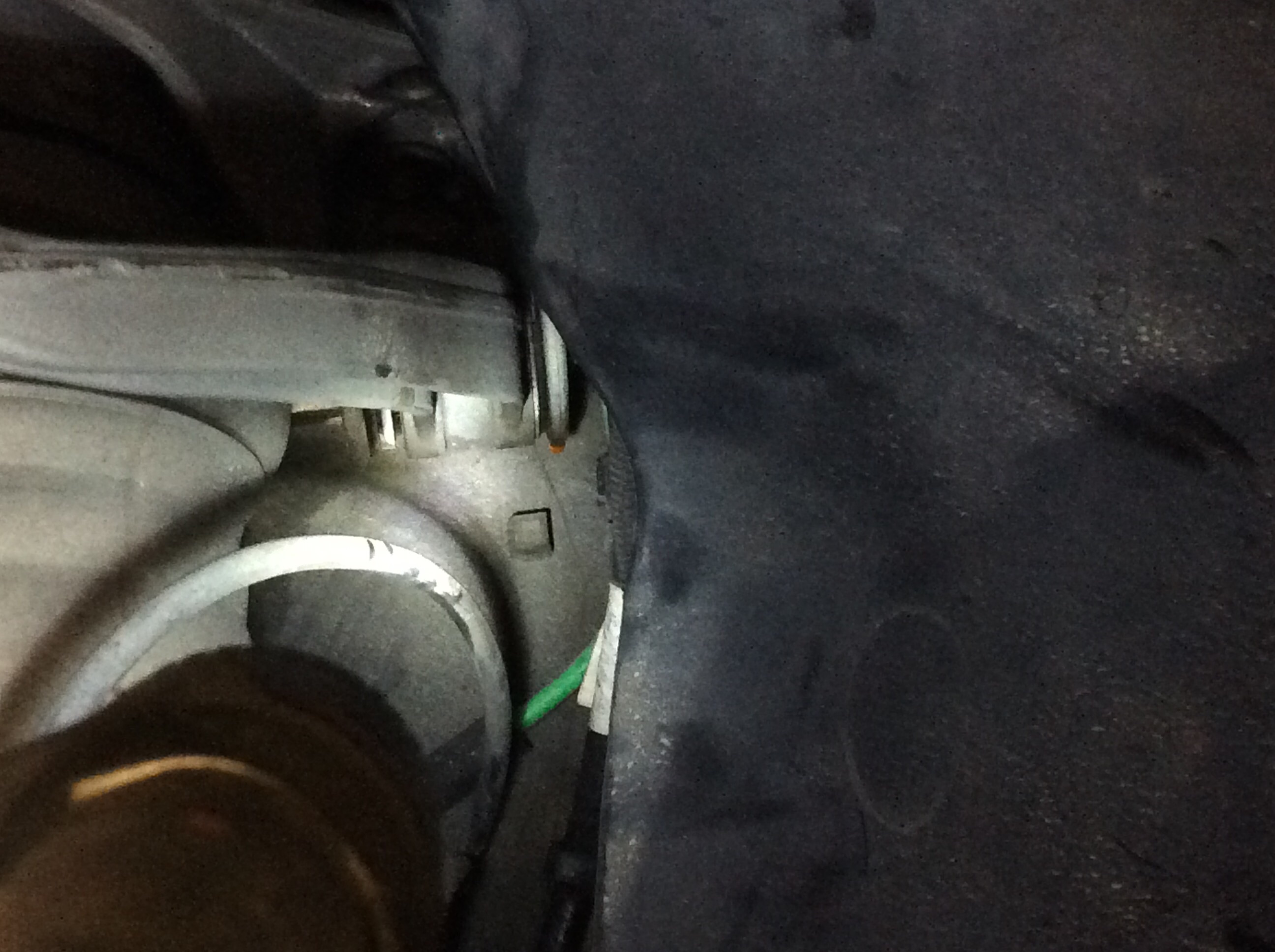

Tracked coolant to this spot, above the upper control arm. Wonder where the overflow piping is with relation to this dripping. Or does this indicate possible resevoir fail. Help appreciated always.

If you look at the reservior you will see where the overflow tube go's thru the top of the shock tower right above the control arm.

That's what I assumed based on looking at the hoses coming off the reservoir. However I wasn't able to actually see the end of the hose.
Another point to suspect overflow is that the grooves inside reservoir, that coolant has to go through on way out, we're all wet.
After I removed excess from reservoir with syringe, the leaking stopped. So will have to keep an eye on it.
A big question I have is where do I check the actual cooling system level? At the reservoir? Since reservoir had extra fluid that gets sucked in if needed. I was looking for the rad cap so I can open to see the fluid level at the rad core, but this car seems different and I couldn't find the cap. The only place I can check is the reservoir.

Well, its been a few days since the initial spill observation.
Since I removed extra coolant from reservoir and kept level at MAX (top edge of yellow plastic with the MAX lettering on it), no coolant spill was observed.
Looks like my assumptions on reason for spill were correct.
Case closed.

It probably says in the manual, but most cars, when COLD you fill to the MIN mark.
The MAX mark is used to indicated where the level will be when the engine is HOT.
I would also never open a cap when the engine is HOT.
Makes sense when the engine is hot it expands the coolant to the max mark.
