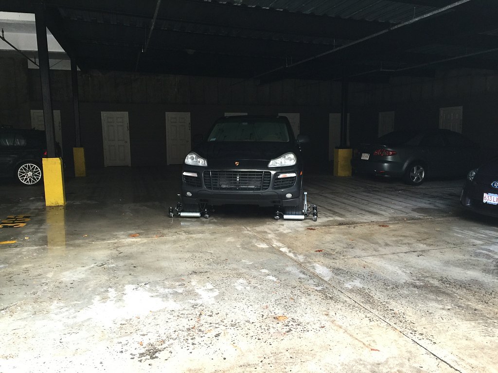

Go jacks in action. These were a life saverClick image for larger version
