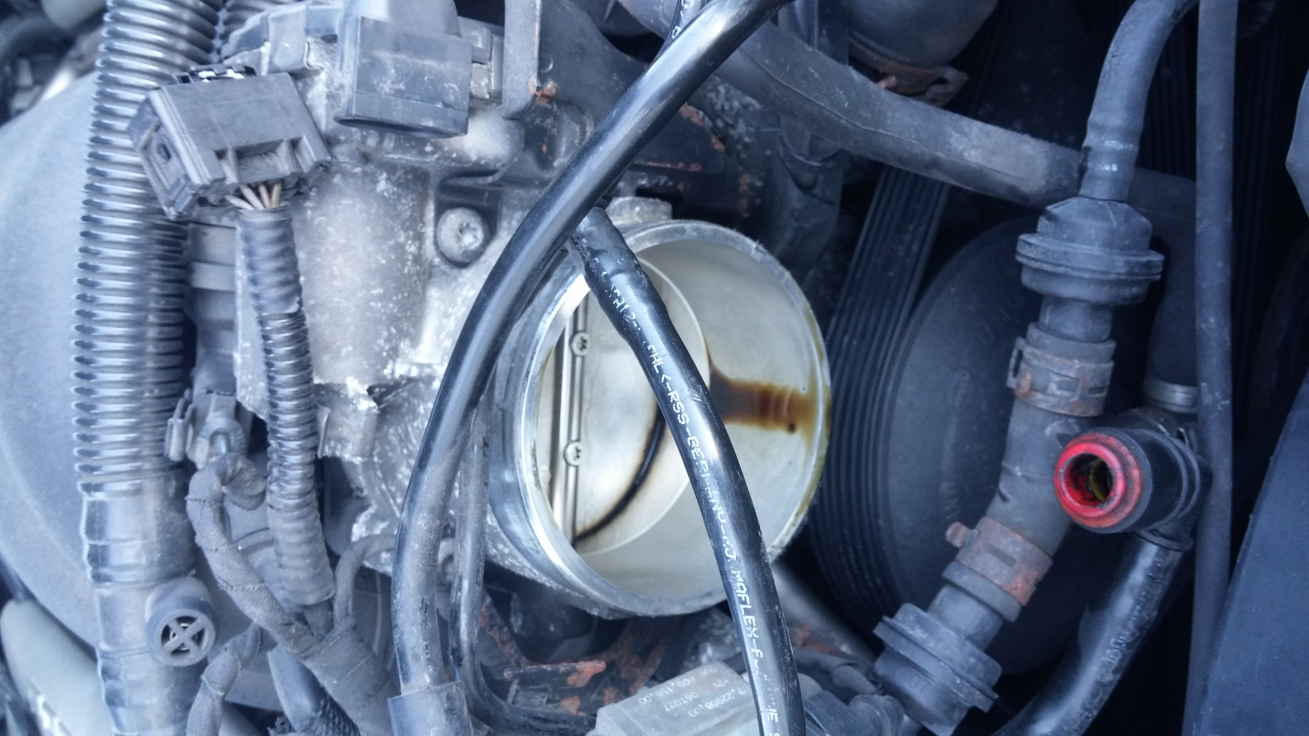

During the disassemble i noticed some oil which came from right side (if you stand in front of the car) into manifold. oil is also in the right pipe (i dont know from where this pipe comes...maybe from turbo?).
Can somebody tell me what is the cause of this oil intrusion. Is it from turbo?

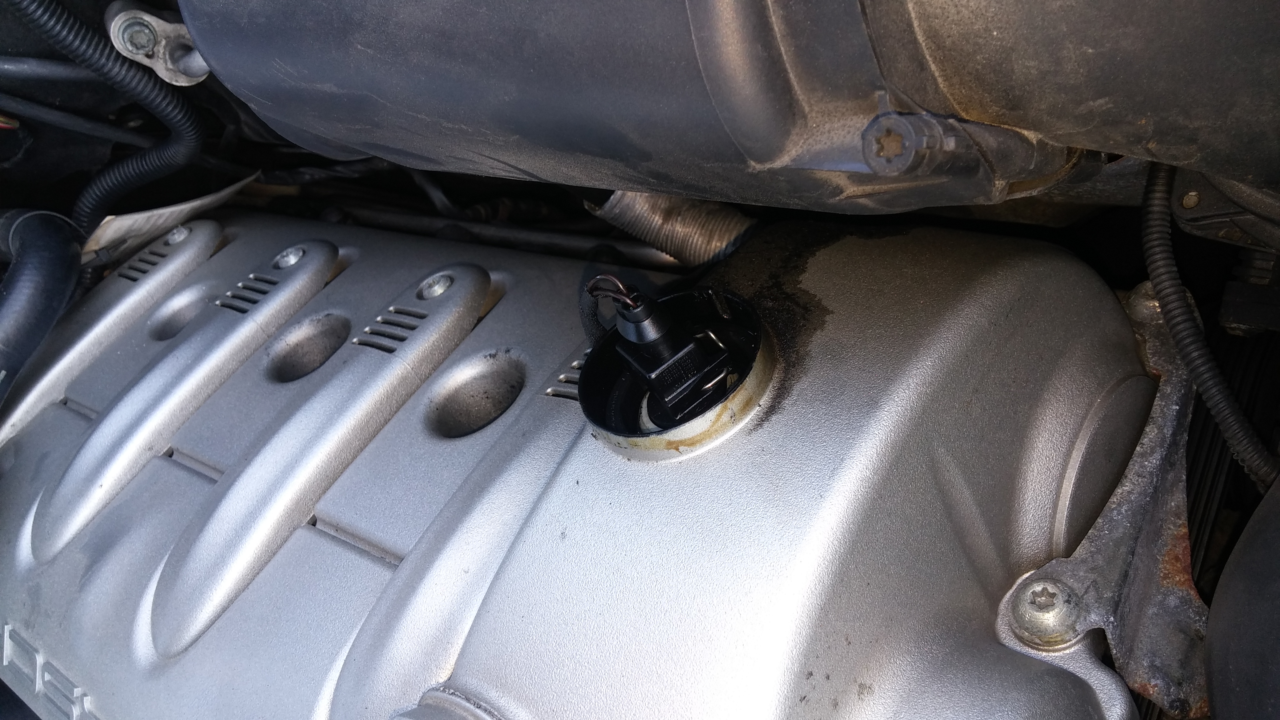

attached are pictures. there is also picture of right cover with some sensor from where also leak oil.

Welcome and there won't be any problem with starting your own thread. Several people have done the same thing. More knowledge is always better I think!
As for the oil, yes that is somewhat normal coming from that side. The pipe you are seeing is coming from the turbo and intercooler. If you take the hose off from the bottom between the turbo and intercooler you will get an ounce or so of oil that collects in that side.

Hi
Tnx for answer about oil intrusion. So i wont do any disassembly on those pipes.
I already ask this in previous post about oil leaking at sensor.
Is this sensor or switch for chain?
i saw a video where the same engine was completely disassembled and on the area where this sensor is located is some guard/protection for chain.
Just guessing...maybe this protection is somehow damaged. Has anybody some exeriences with this kind of fault?

And about the "sensor" from your previous post. That is a timing angle adjuster solenoid or VVT.

what could be the problem of oil leaking at this solenoid (VVT)? any clue?

Oil leaking because of bad gasket or inaccurately placed valve cover - it has few millimeters of walk and if placed incorrect, VVT gasket gets stretched on one side and makes gap. Check it.

You are right, the connection under the cap in the valve cover is the "camshaft actuator". Not sure why that would be leaking and I couldn't find a parts diagram showing the unit so not sure how it is secured through the valve cover.
There is a gasket that goes with the cap but not sure that would stop the leak. It is part # 94810593400 if that helps at all.

i find video on yt
i think this is the solenoid which we talk

Just start with cleaning the leak with some brake cleaner (on cold engine of course). Then drive around for a day or two and check it once in a while. You will see where oil comes from - is it leaking from gasket or actuator itself. There's no reason to jump and change every part that you think is broken.

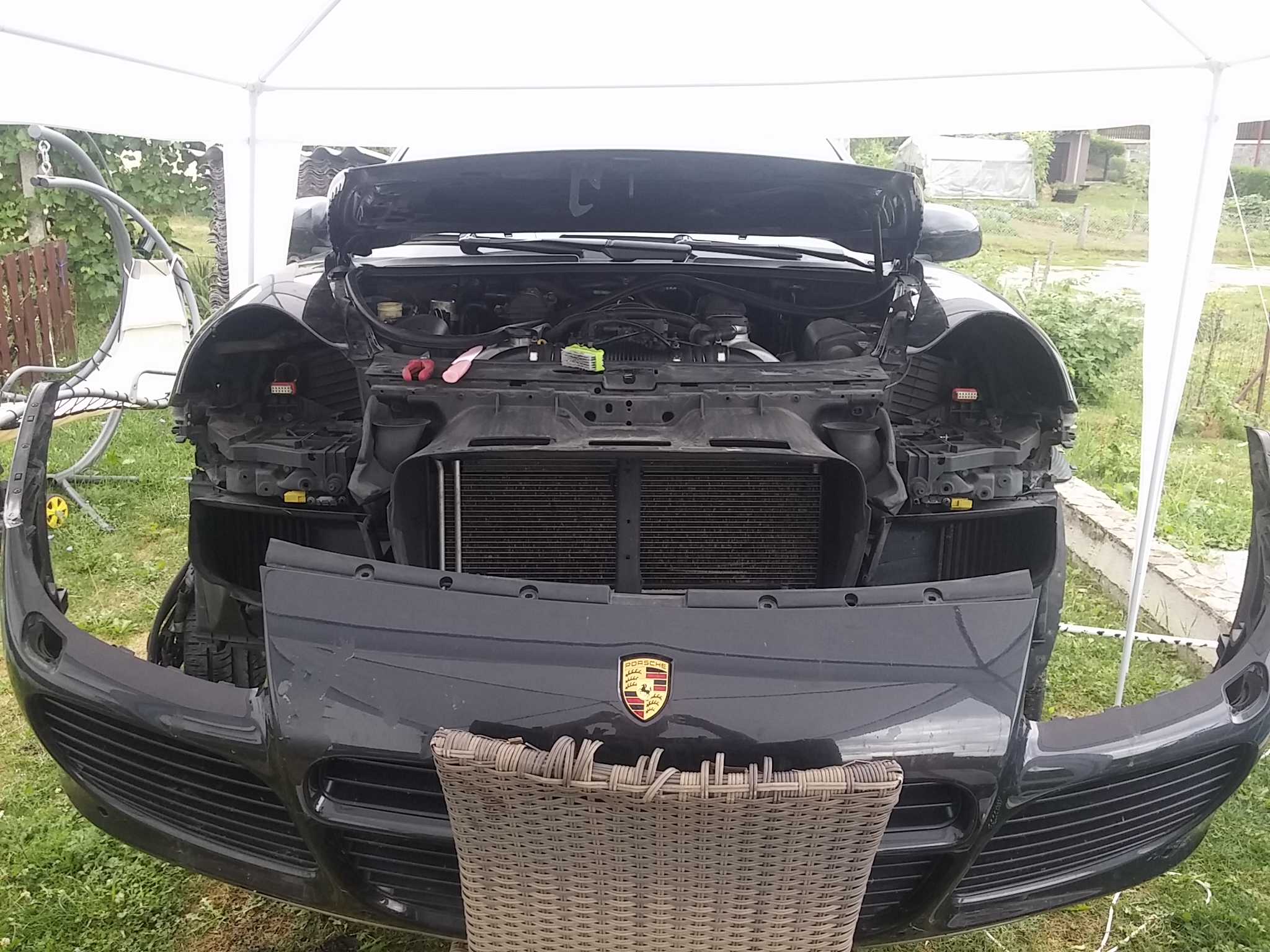

i want to change cooling liquid and i must reach radiator.
is there any instruction how to remove front bumper. There is skid plate, lower part of bumper and bumper. Do i must remove complete bumper or there is a way to remove only lower part with skid plate. I search on yt but there is no tutorial.

Hi
i solve the problem with removing front bumper.
there are 2 screws at side blinker which must be removed and then just pull the fender (must be carefull and not to forget to unplug park sensors and other cables)

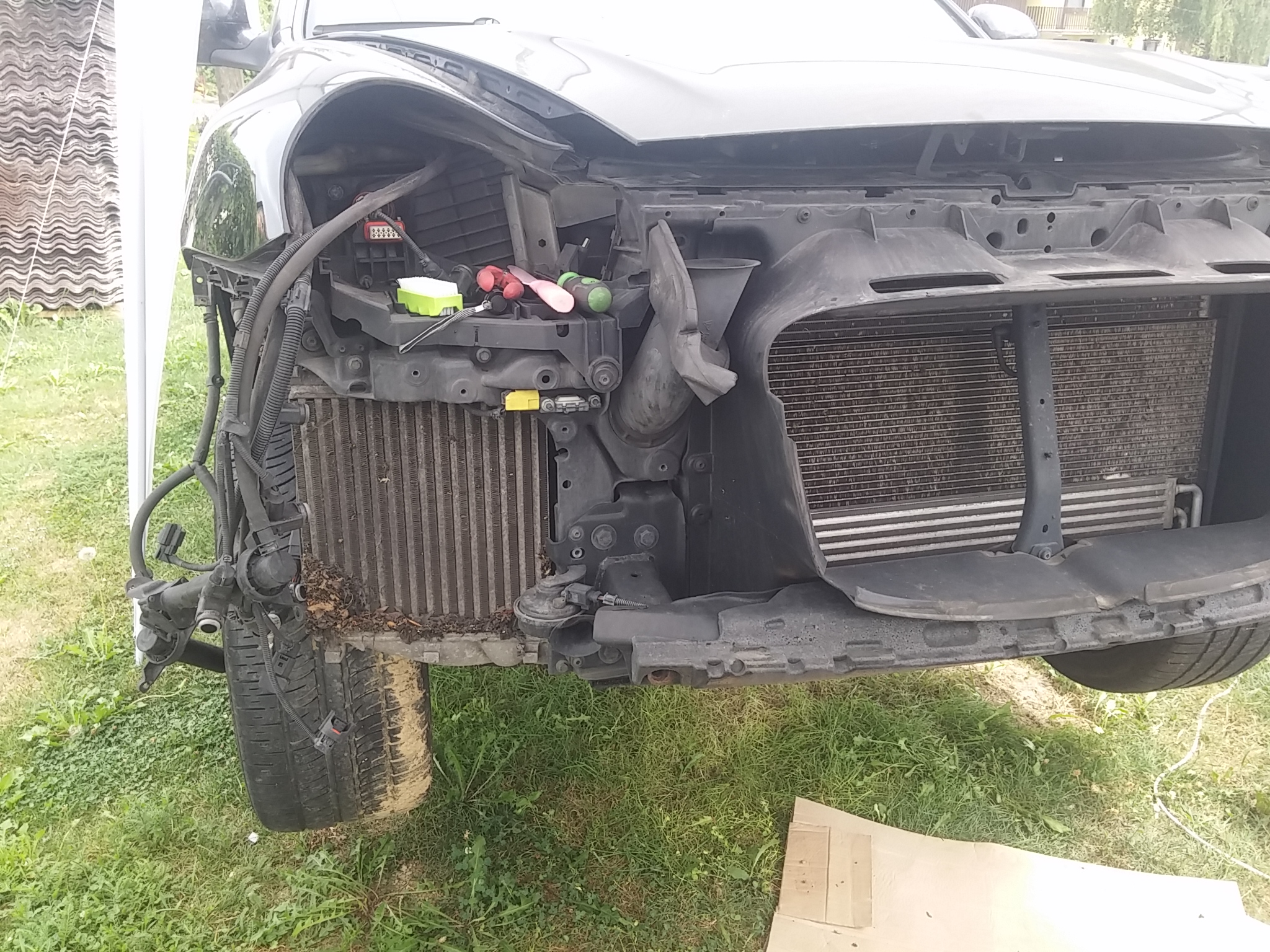

at searching the plug in radiator to release coolant i put apart almost complete front of the car.
unfortunately this model doesnt have plug in radiator or i couldnt find it.
so i clean the turbo radiators (on the picture you will see a lot of garbage including poor bird )
