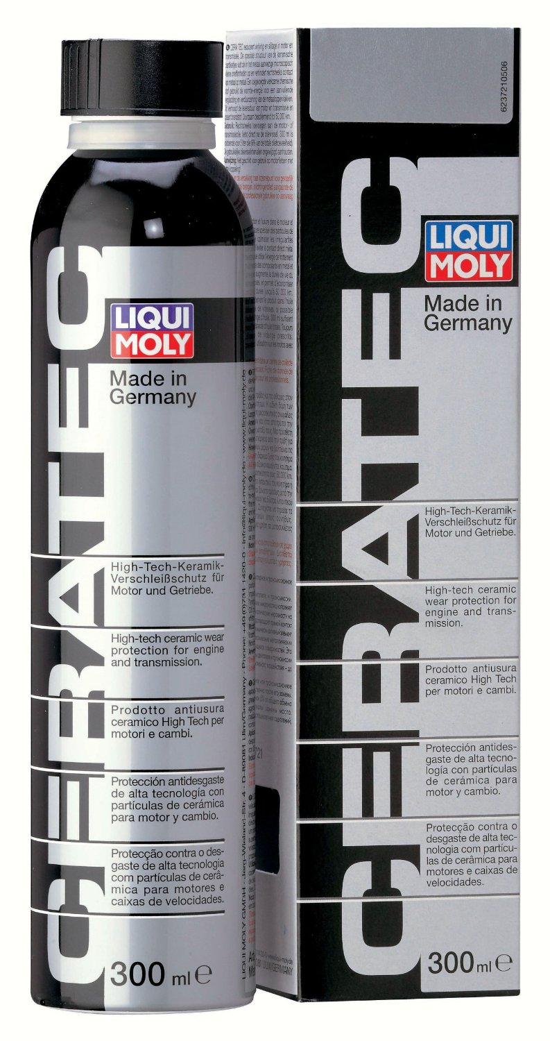

Liqui Moly Ceratec. Uses engine heat, compression and friction, to form a glass-hard coating over bore scoring. I had Audi guys lose all their oil on the track... and the Ceratec still kept the cylinders slippery, after refilling and replacing the oil pans. Google it.....

Hey thanks! Might use this. Hopefully I'll get my Porsche back in a month or so. Really taking their time lol.
