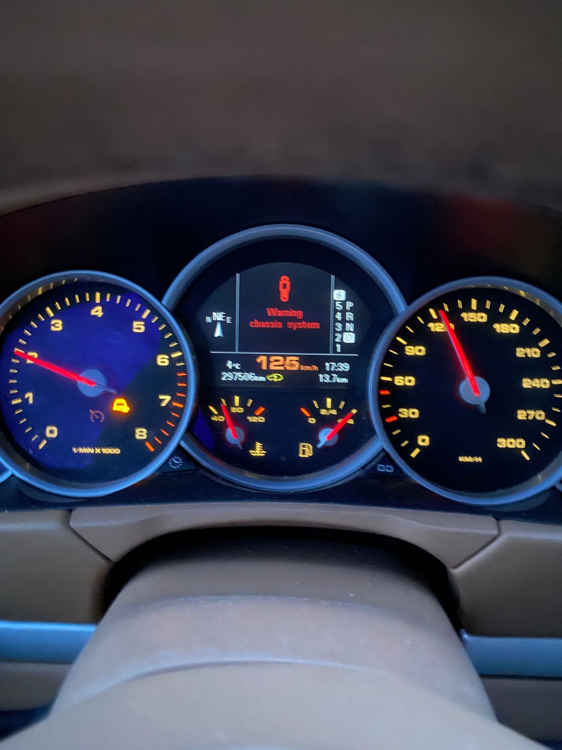

2008 Cayenne Turbo with PDCC
About a month ago, I was making a right hand turn and went over a rail road track (pretty rough surface) and I got "WARNING CHASSIS SYSTEM". It was pretty obvious that PDCC was dead because the car handled like crap. Air suspension works fine, but doesn't let me control it at all, I can't change ride height, it does autolevel though.

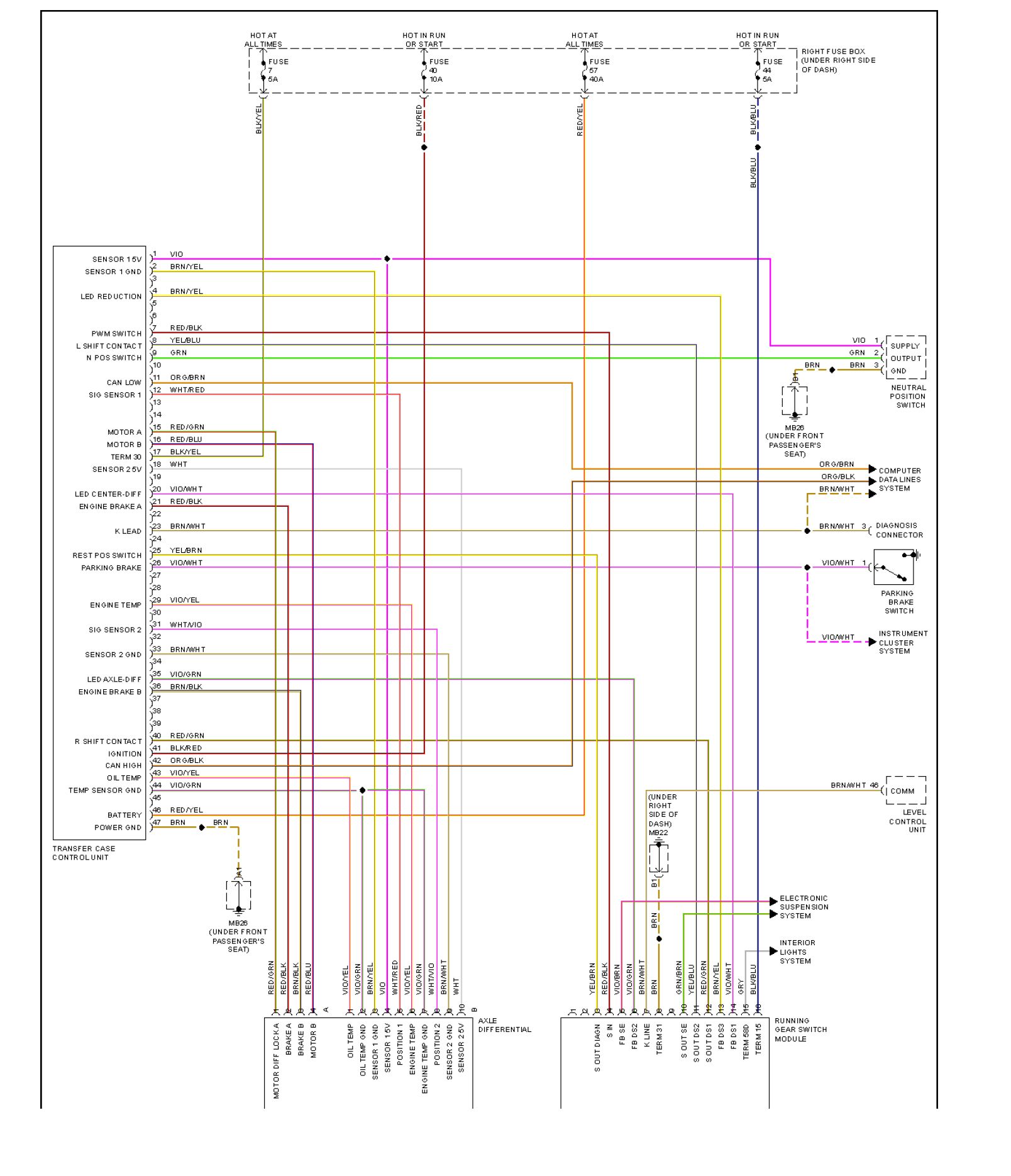

Ok thanks to the help of someone I was able to locate the module and remove it but the fuse is still blowing. Does anyone have a workshop manual with wiring diagrams that shows PDCC? The one I have seems to have everything except PDCC (must have been written before PDCC was added to the Cayenne)
Module was located under the rear passenger side seat
EDIT: I think i found the module I'm looking for, but I'm not sure what it is (part number) or where exactly it's located. The ground point for it is under the right hand side of the dash. It's called "Running Gear Switch Module" but google returns literally zero results with a search for that. Can anyone identify what this module is and where exactly it's located?

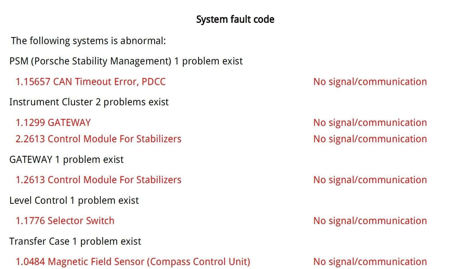

Man I feel for you. I actually went back through my texts to my friend from 2018, and remembered what happened. I was finding all the modules associated with this fuse and I ended up starting the car with one of the ones on the passenger footwell disconnected and it threw a ton of codes. I ended up reconnecting the module starting it, all the codes cleared and the fuse never blew again. I did also see in my texts that having the pdcc module disconnected didn’t stop the fuse from blowing. The one I had disconnected that “fixed” it was called a “gateway module” in the repair manual
