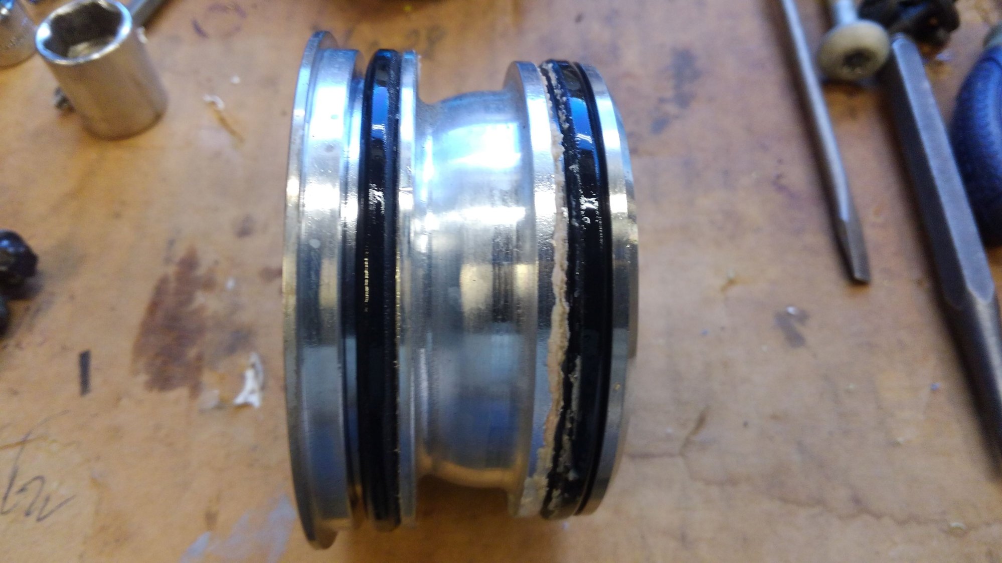

Although I have not replaced the pipes on my 08M CS, I have post coolant leaks after a thermostat water pump replacement. I have attached a photo of a thermostat intake socket where it has evidence of oxidation where the leak path was. I replaced the socket with an OEM and so fat so good. By the way, the coolant leak was dripping out of bell housing, which I thought was trans fluid. Made the socket repair and dripping stopped, a
nd I whiped the sweat from my brow.
