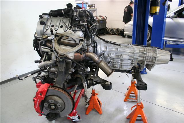

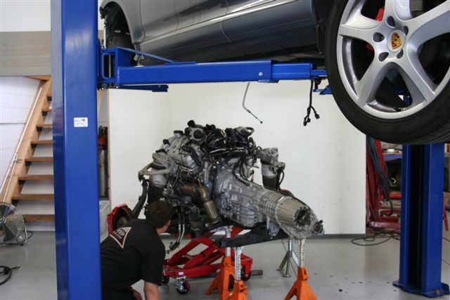

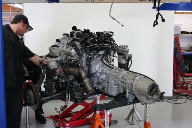

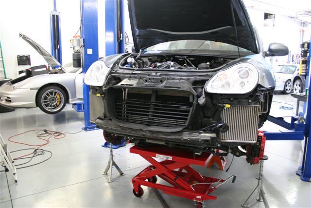

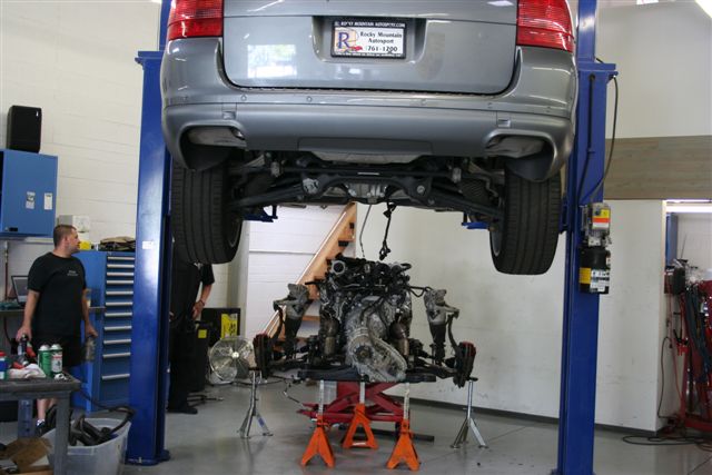

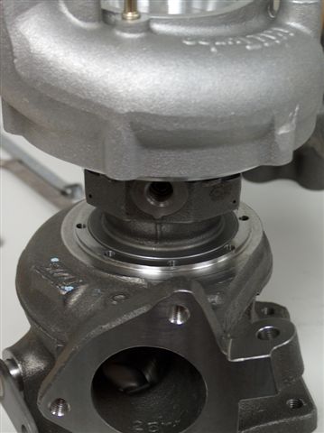

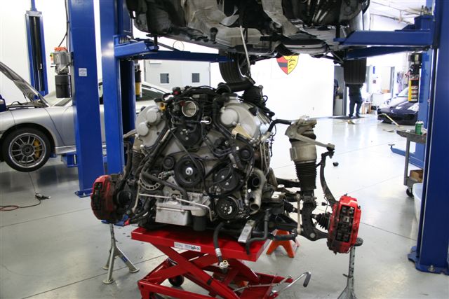

We have begu the final installation of our big turbo kit for the cayenne TT. We have been in the R&D process for over a year now on this project. This is the first car that is getting the initial release of this new upgrade. The upgrade consists of the following components:
EVO / Garrett GT Turbochargers - Machined into the OEM IHI housings
Water adapter lines to cool the jackets of the turbos
Machined oil feed adapters
High flow 200 cell primary catalysts
Secondary catalyst bypass pipes
EVO / Milltek 70mm complete exhaust system
EVO intercooler upgrade w/ upgraded boost plumbing
EVO Billet diverter valves
EVO V-Flow twin air intake systems
Modified torque converter
EVO / GIAC software calibration
Power is expected to be in the 650 range but final numbers will be released after testing is complete. I will update this thread as we make further progress.
