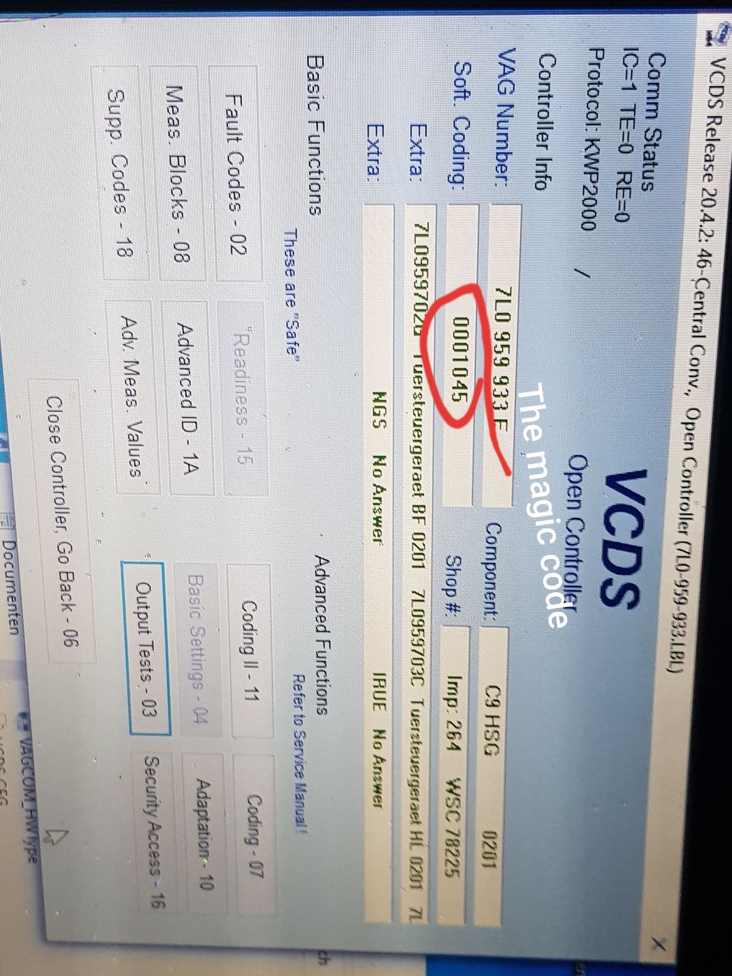

I just found out something crazy about this subject...
After the investigation about the Ambient Lights in the interior doorhandles, earlier posted in this thread, I quited at the mercy of not having those "Ambient Door Lighting" installed in my car, and letting it rest.
But today, I ran a test on my Cayenne, using VCDS.
This test, I found located at: Comfort System/46-Central Conv/, it showed me all the functions the car has. It performed a headlightwash!!
I didn't even know, my car had that option!! I saw 2 little peaces of plastic in the bumper, but did not know they were operable!
And more funny stuff. It also did a tire test, I think! Can my car blow its own tires??
Very very nice, for testing!
The function would be performed, after I confirmed the action. Stuff like Foglights, Cornering Lights, All dashboardlights,
interior- and outside luminations and Lighting.
But then some "Interior Light" options came on my screen...
All the interior lights the car has, where eluminated one by one, after I pressed: "Do it!" :-)
I felt it coming... Soon I will read something about the Ambient Interior Door Light Illumination, and it did, it appeared on my screen.
For one second I thought: "Would it?"
And it did.. The so wanted orange door lumination light, lit up...
I stopped the test, and stared at the orange light, coming from the doorhandle.
Not knowing what to do, I pressed next. That means the test has ended, that particular test is finished performing,
and the light of that test would soon disappear.. And it did, all the rest of the ilumination in the door stayed on, I had my door open,
but the door ambient light behind the armrest, disappearred.
But next question on my screen was if I want to test the door lights, in a door, in the back-part of the car.
So I could see it another time! Worked also!
-They were very very faint, at it's very lowest settings, I think.-
But clearly, I saw them working, I even looked at it from close, and could see them very faint...
My car battery started complaining by then, I mean the Porsche started to complain and throw "peeps" at me, because of low voltage,
using a diagnostic tool like VCDS, takes a lot of battery from the car.
So I stopped. Tommorow a new day, I know exactly how I can reproduce this test now. So I will tomorrow.
I did take 2 pictures of the menu in VCDS, the location I found this testing options. (And maybe programming.)
VCDS will hopefully lead me to the location of this door ambient light programming, now I have leads!
There are a few possibilities, I think.
-We know the Ambient Door Lighting is working, I have seen them working, so it's not a technical thing. The lighting is in the door, the wires are connected to it, and during the test all the lights in that door lit up together, so technically nothing is stopping it from working...
Anybody an idea about this?
I also will investigate further...

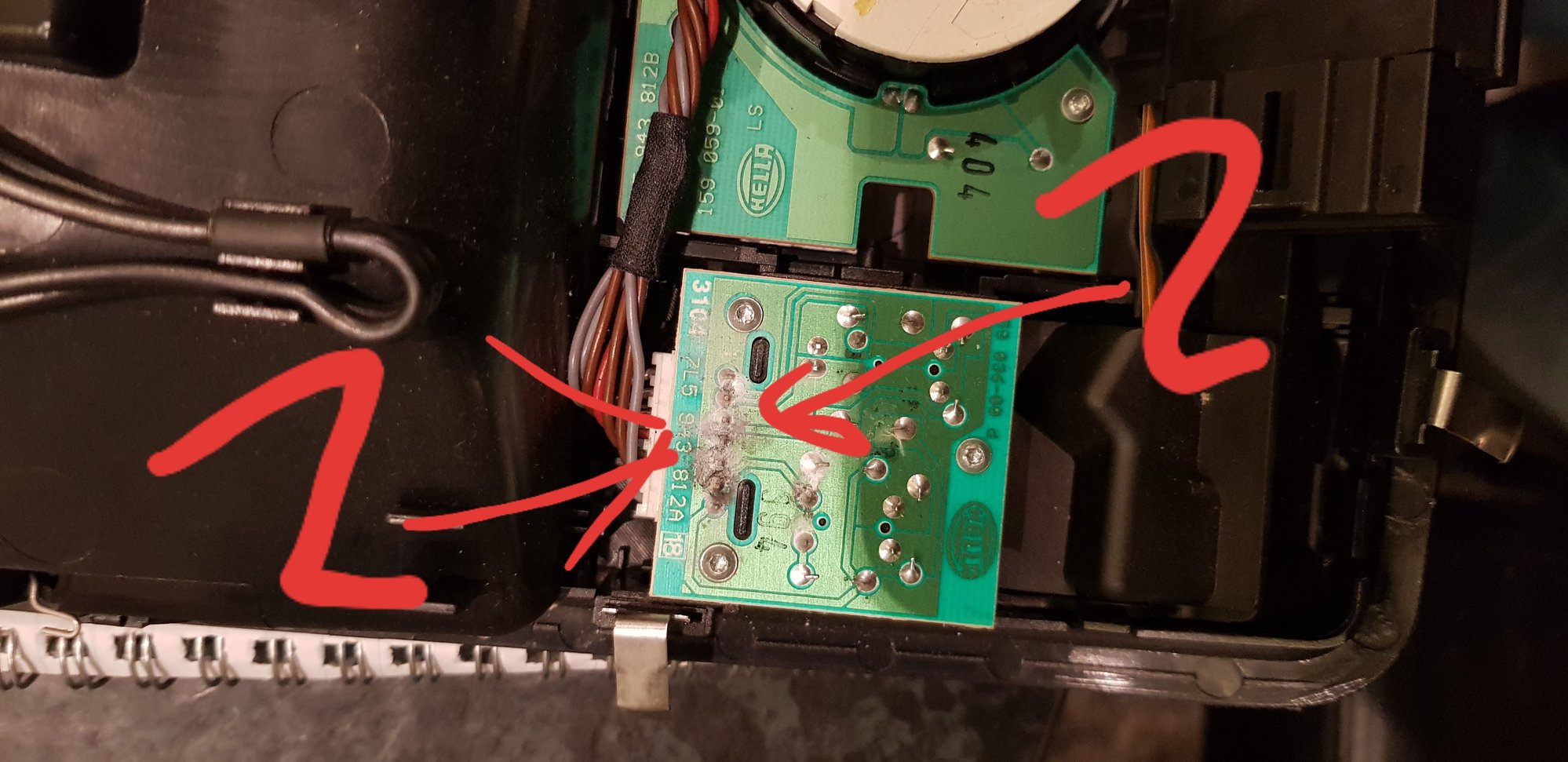

To be sure, I took out the Overhead Roof panel completely.
Wanted to move the cables a bit, and see if the Door Armrest Lighting might switch on for a sec.
Taking it out, I discovered some stuff I didn't expect...
-The lighting in the doors(Window up/down, lock/unlock, and the doorhandle itselve, aren't controlled with the same Dimmer Switch as the Footwell Lighting(Overhead Panel Dimswitch.)
-The strength of the lighting in de doors is controlled bij the dimswitch in the dashboard, the one that also controls the strength of the dashboardlighting!
So in my car, the footwell lighting is controlled by the Overhead Roof dim switch. And the Dashboard- and Door Lighting is controlled bij the dashboardswitch(Close to the "general car light switch")...
-Even with the complete overhead panel removed, the footwell lighting is working..
-I do see some electrical locations in the overhead panel, that look corroded and not real good. But when I follow that location, it ends at the "Set parkinghelp on/off button" on the other side of the panel, which is still working fine.
-I see some open wires that end up at the, seems like "Ventilation holes", next to the "drivers little light button". I will include some pictures.
Learned a lot, but I am not suspecting the VCDS error message: 02197 - Footwell Light Regulator (E398) 008 - Implausible Signal, has anything to do with the dimswitch in the overhead panel. And also not with the Ambient Amrest Lights, that are not working in my car.
