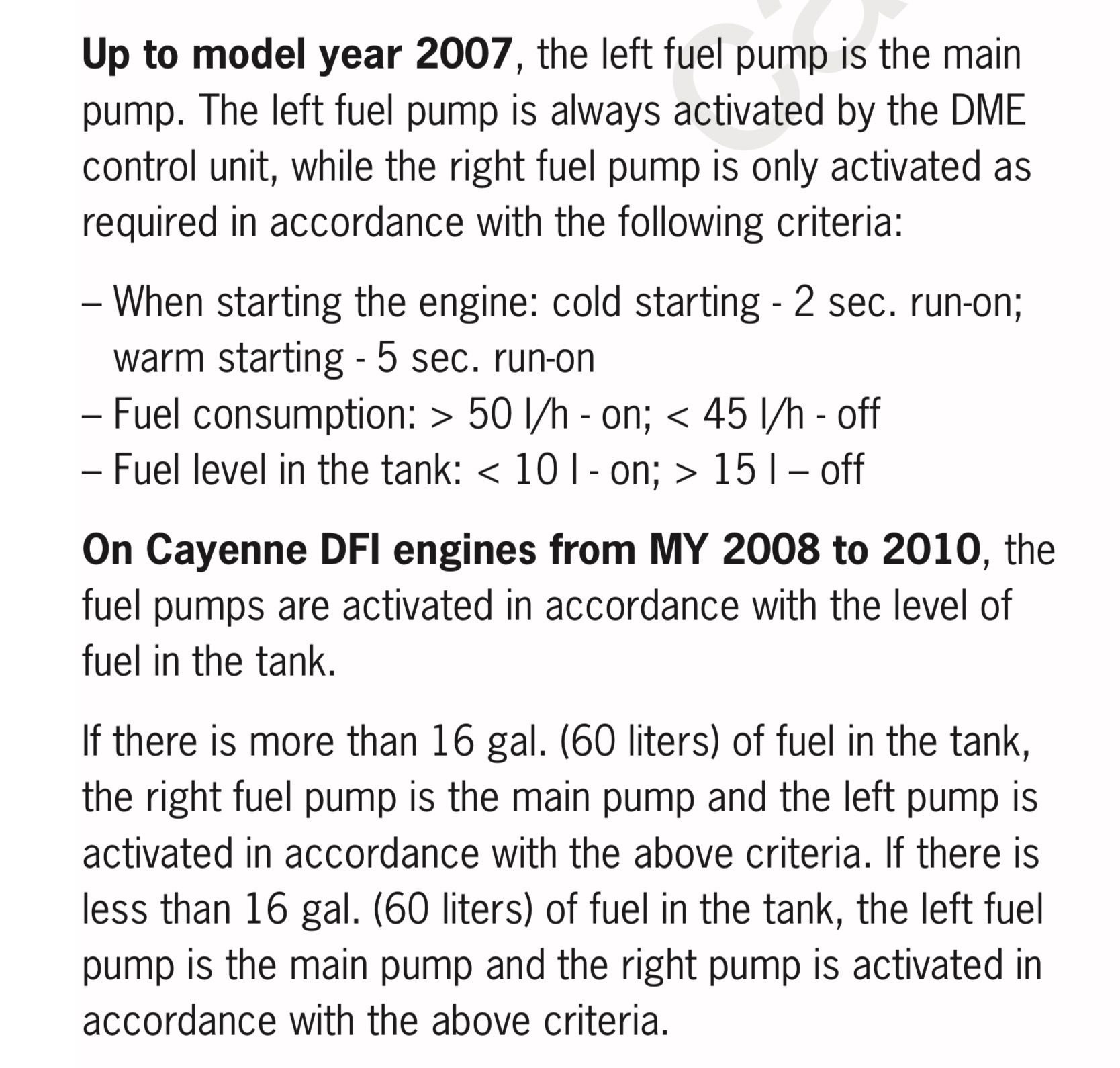

This is the operating method for the fuel pumps

Thanks, good details to know.
But this is not my problem.
When the Left pump runs there is no pressure to the fuel rail -- but there IS pressure out of the filter that is supposed to feed the fuel rail.
The issue is same as others that say have to remove fuse #14 -- but the pump runs fine and both create pressure.
