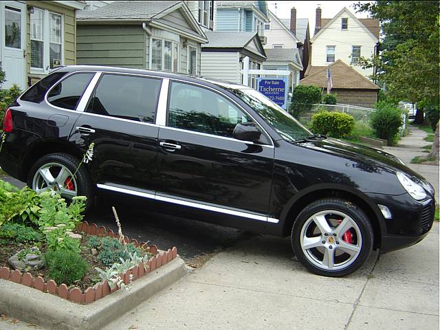

Nice the clear markers must be a nice touch, when I first saw the Cayenne that is what I thought it would need and now they are here.
