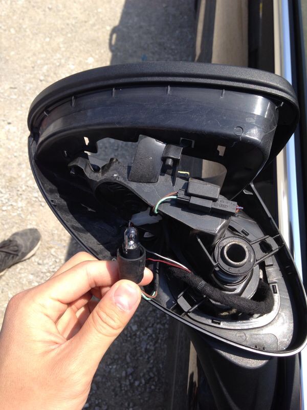

Anyone figure out how to open up the side mirror puddle lights??
you have to disassemble the whole mirror housing. I chickened out at the first step "pry out the mirror".

I did my mirror puddle lights

Another pic.

Exactly the pic I needed! How did you pry off the housing? Or did you take off the mirror first?

You need to pull off the mirror first, it helps if you adjust the mirror so the outer edge hangs out and you can pry it out. Next is to remove the body color housing, you need to release some clips from inside of the housing, but you need to remove the mirror motor in order to get to the clips. Because the bulb is horizontal, you want to get a LED with bulbs on the side otherwise it won't be bright enough, also the LED cannot be too long or it won't fit the bulb housing. Hope this helps.

This instruction is for the Touareg. It has the same side mirrors as the cayenne.
Originally Posted by MBX5
Just give it a good tug and it will pop out
2 screws and two tabs inside towards the top release this part
Once you get this part off you must remove more screws and then take the top (silver) part off then the lower black part.
Credits to MBX5
