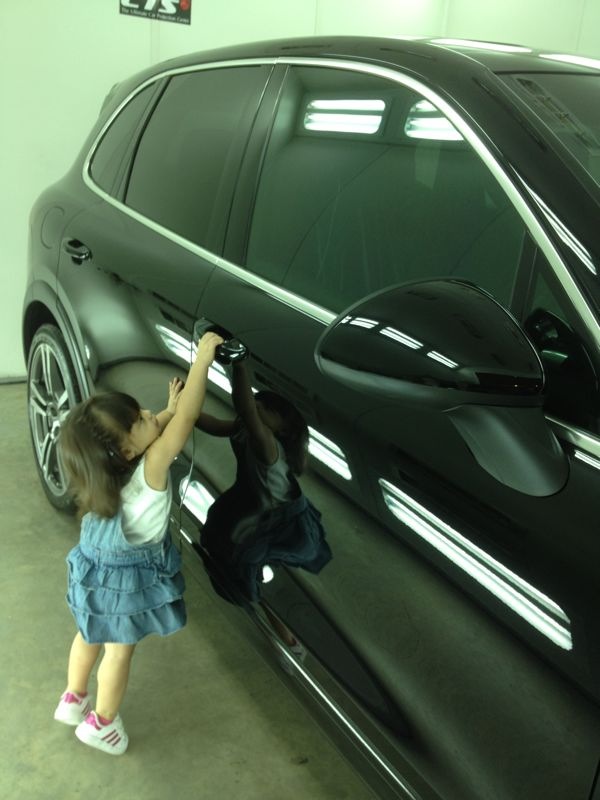

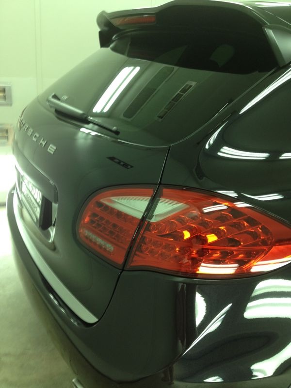

I took no chances with the paint work and had the car crystal sealed, its a process from japan, they spray another coat of silica crystal over the car ( like liquid glass ), its done in a spray booth then they put car in an oven to bake.
The shine from the car is fantastic, the process is not cheap at a few thousand dollars, but the results are great and no need to wax the car, just wash and your done, comes with a 7 year guarantee, prevents scratches stone chips and protects the paint.

This is the website, its in Thai but you will get the idea.
http://www.crystalsealed.com/index2.html
Its big business here as there is over 200% tax on import cars, people make sure there cars paint work stands up to UV, stone ships and whatever the road throws at it.
I have added some pics of the car after its coating, no need to wax now just a wash and its back to its shine.
