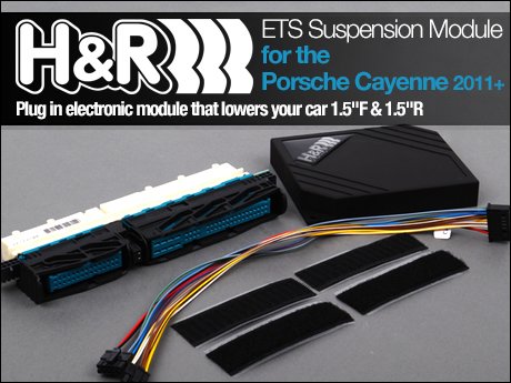

ECS Tuning - Porsche's Avatar
Joined: Mar 2012
Posts: 9,607
From: Wadsworth, OH
We offer the H&R lowering system that works directly with your Porsche factory air suspension to lower your chassis up to 40 mm beyond the factory limit. All modules are plug and play. This unit can removed whenever you want to return your Cayenne to return back to stock. For more information Click Here
