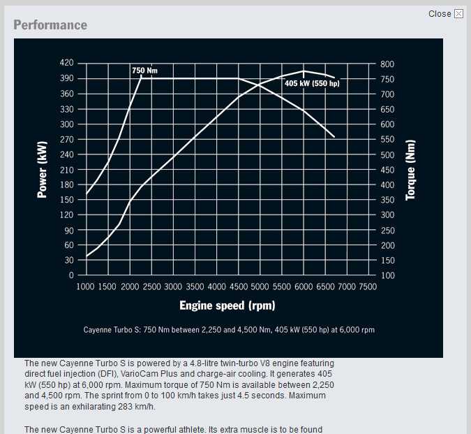

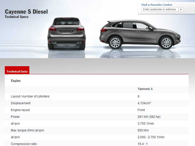

Simple. But first, understand that the chart I uploaded above is for the US-spec V6 diesel. Below is the chart for the US-spec Turbo S. I could find no comparable chart for the Diesel S, but the graphic next to it (from the Porsche UK website) has representative numbers.
So. Note that the Diesel S max torque is available between 2000 and 2750, and that the Turbo S max torque is available between 2250 and 4500 rpm. Short version, Diesel S max torque is available sooner. But the Turbo S max torque lasts longer. That's why the Diesel S will beat the Turbo S off the line. But the Turbo S torque has longer legs, which enables the Turbo S to catch up and eventually pass the Diesel S.
