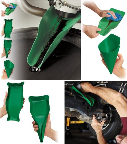

Used a form a funnel last time and worked well, seemed to contain most of the mess.
