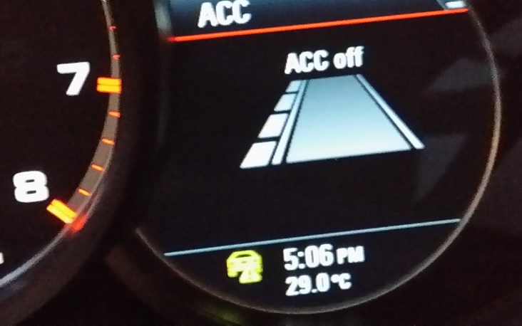

Hello everyone,
I have brand new CTT with around 600 miles on it. I have a weird icon/symbol that pops up for like 20 second then it disappear for the day. It happens almost everyday and I don't know what cause it. I looked on the manual but didn't find anything similar.
I know the picture is not clear but i was driving. Please if you know what it is let me know.
Thanks in advance.

Look up adaptive cruise control in the manual.

I think I found it "driving too close behind another car for long time" !!
as long as its not something do to with the engine i'm happy
Thanks TAch Miami

Exactly it.
Also if the car brakes in front of you and you don't have to be paying attention, it will trigger an alarm and a red warning in the same window along with brakes being boosted up to stop faster.
I love the ACC for this feature alone.

YEP its a warning when too close to the car in front , you can turn that off in the menu.
BUT, how do you turn off the stupid adaptive cruise control, i want a normal cruise control. Mentioned above, changing lanes becomes dangerous when the car brakes at the wrong time.

Of course you can turn it off! And you can also adjust the sensitivity/distance for when it kicks in if it is active.
Did your car come with an owner's manual? It's usually in the glove box, but sometimes they put it in the door pocket. Or download Porsche's Good to Know app onto your iPhone or iPad from the iTunes store.
Instructions are in there under Adaptive Cruise Control.

I believe the op of the question wants to turn off ACC and use normal cruise control instead. At least on my 2014 CD, there is only ACC and no option for normal cruise control.
IMHO, I really like adaptive cruise control, specially when stuck in slow moving traffic. I just adjust the sensitivity to one bar and the CD just follows the car in front until there is a total stop.

From what I read, the icon is for the PAS (Porsche Active Safe) latent warning. It shows up when you have followed another car too closely and the car in front suddenly brakes.
From my memory, I know that there is a setting in the display (I think it is under PAS) that allows you to remove the "check" for laten warnings. Actually, I am reading the manual on my Porsche app right now, and it says that you can uncheck "pre warning on." That should stop the warning from showing up, but the Cayenne will still warn you with an acute warning if it senses you are not reacting promptly to a slow car in front of you. Hope this helps.
[Edit: I guess it is the Porsche mother ship whispering to you that you just followed someone too closely. If you still don't pay attention, it will shout at you and pre-arm the brakes.]
