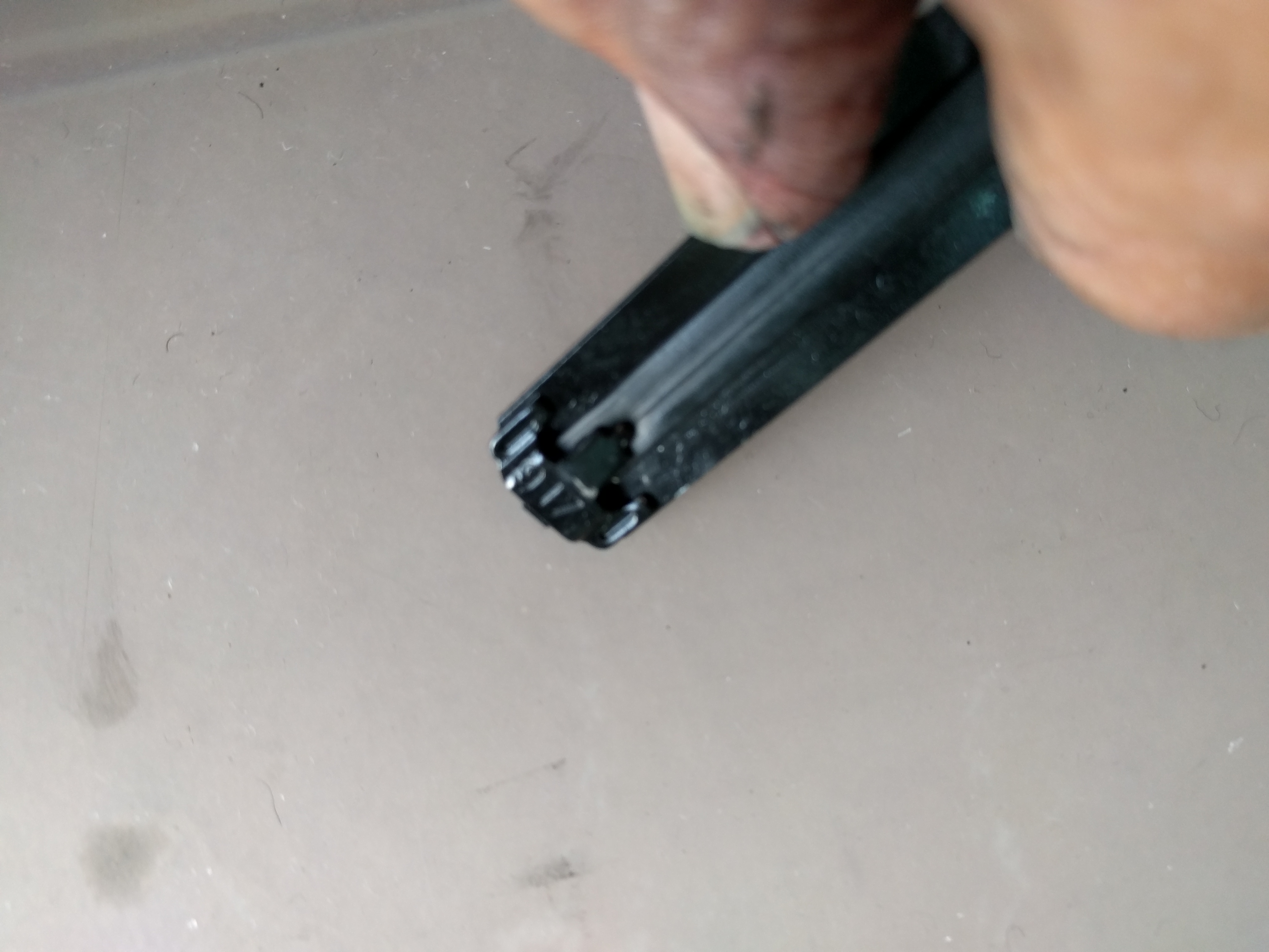

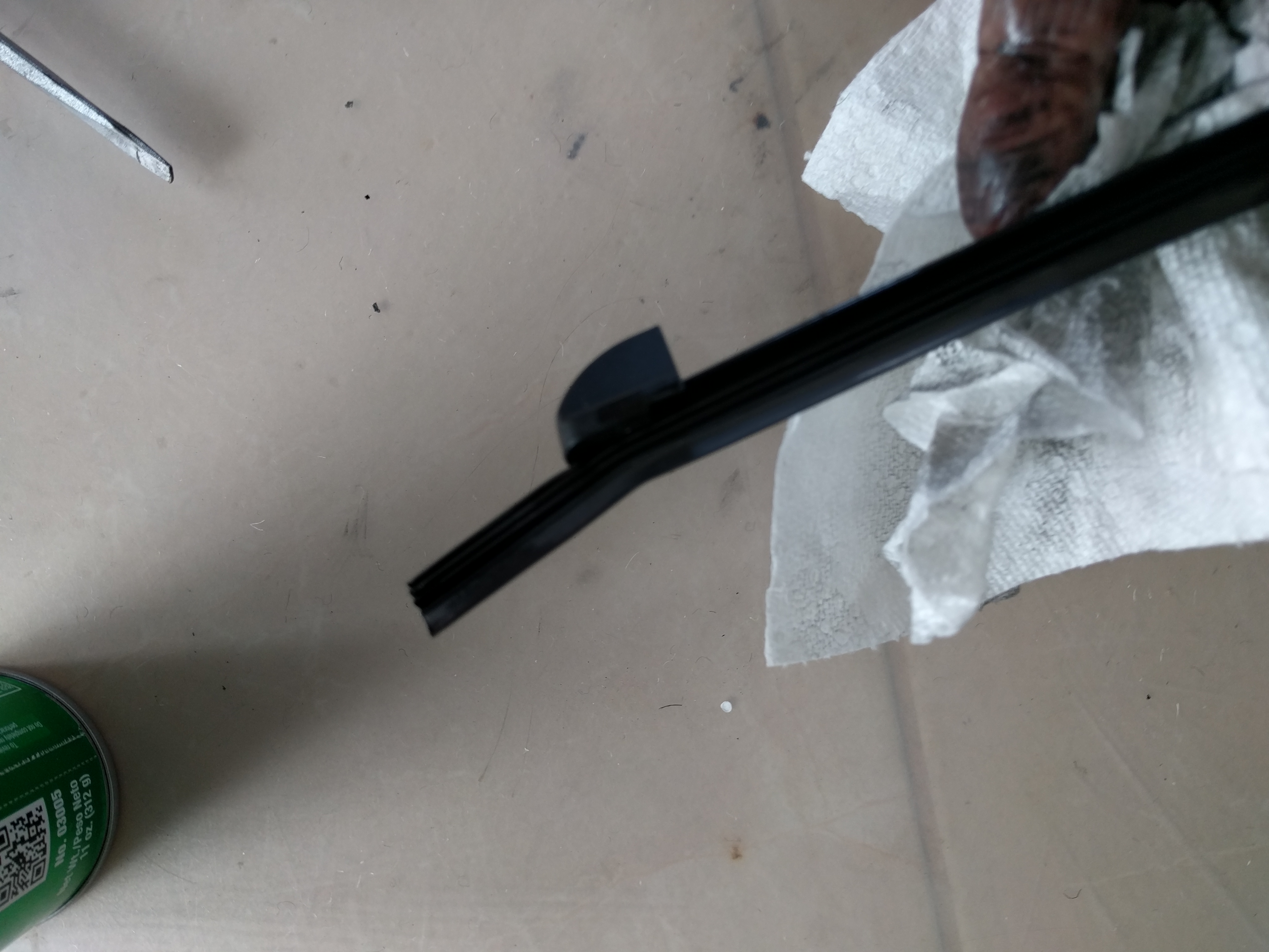

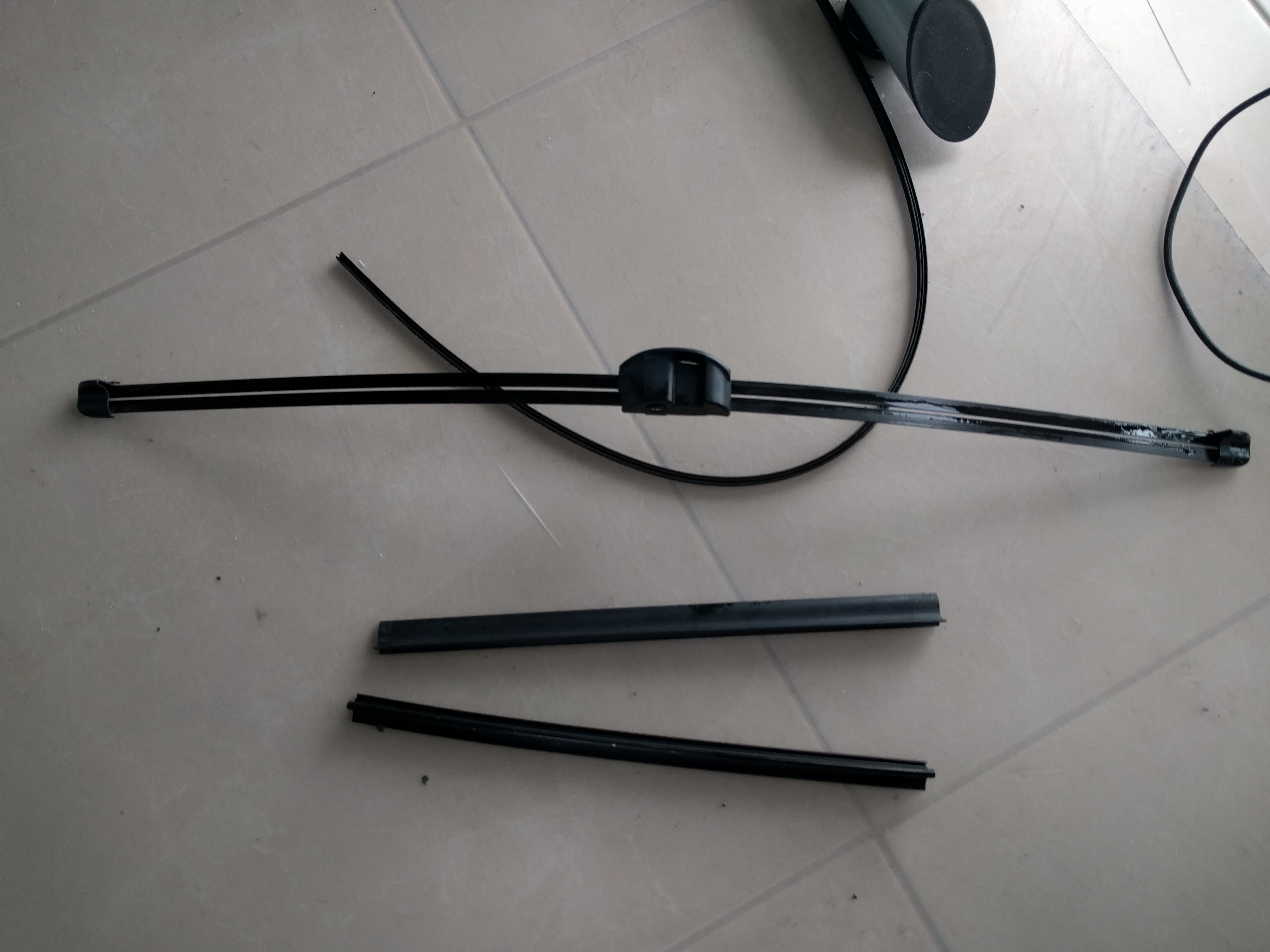

OK you won’t believe this. I had to replace my wiper blades and found and referred the post above but then I thought I remembered having a spare set of blades in the garage and looked and found them. In fact I had a brand new set and another set in a plastic bag. So I took the new pair and swapped arms with the old ones on my car. Easy peazy 1 minute job. Then I decided to see if I could remove the bad rubber from the wiper arms I took off and realized I could wiggle off the little black end of the arm. The only end piece you need to wiggle off is the one on the end where the mounting hole is. Then lift up the tiny metal dual-point keeper arm about 4mm with a needle nose or small screwdriver and the rubber slides right out. No need to do anything else or get your hands dirty. So now I came back here to post this and realized the old post from almost 5 years ago, that I referred to, was mine! The dirty hand was mine! Guess my memory bank is partly resting online these days instead of on-site! The good aspect of this is I am, in my older age, apparently a little smarter to have figured out a better, easier and cleaner way to replace the wiper blade rubbers.
Anyhow below are pictures of what I described. I ordered another set of 26” rubbers from amazon and will post a few pictures when I replace them later today.
Screwdriver wiggle each side till it moves away and then comes off. Metal clip inside is good place to rest one side of the screwdriver on to wiggle the clip off with the other side of the screwdriver
Here you can clearly see the little clip with the little pointy arm bent up that allows the rubber to slide out easily and where new one will slide in. Plan is to bend it down to have the pointy ended arm secure the new rubber when it arrives
