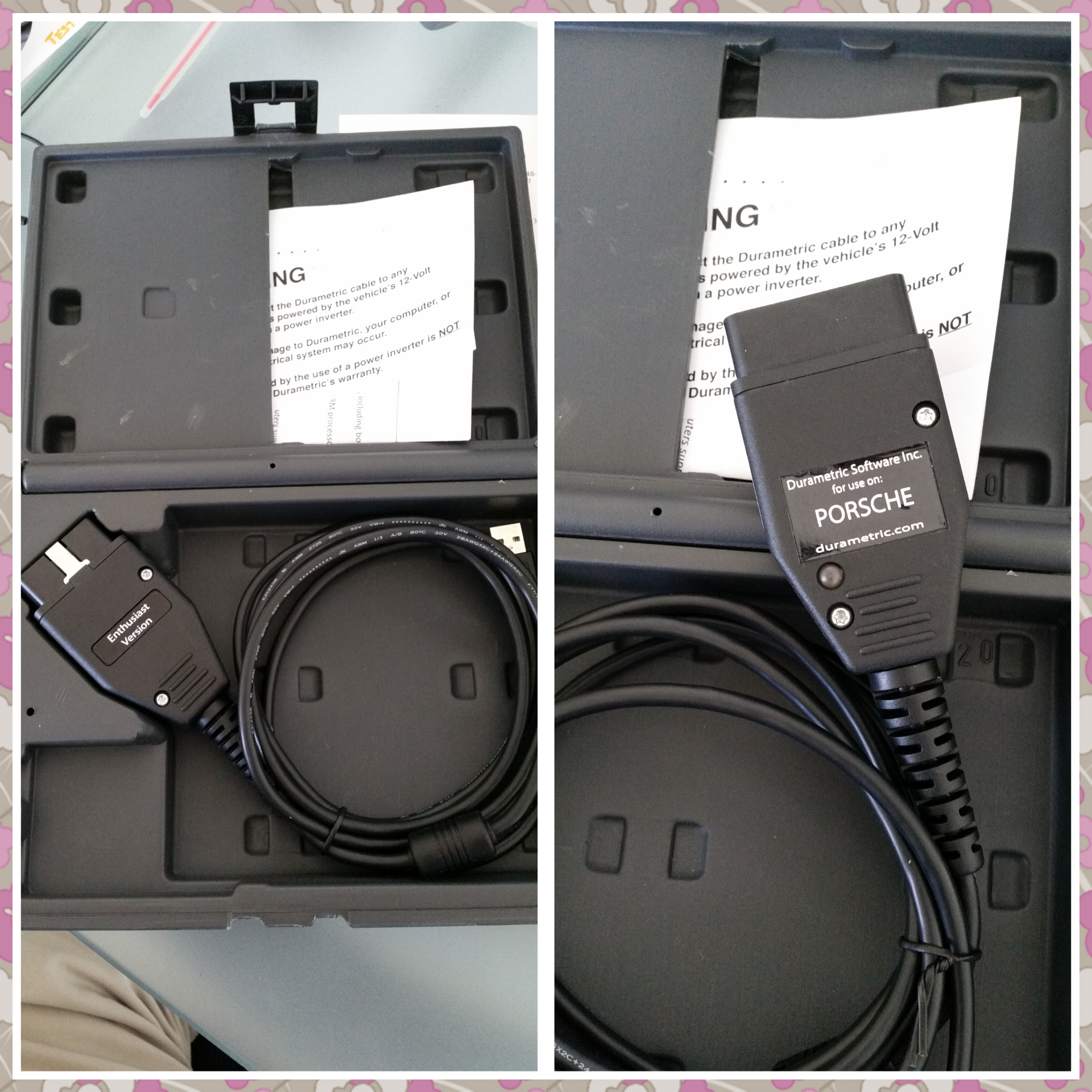

I'm going to buy the enthusiasts Durametric cable to reset my service indicator. Only 4K miles in the past year but dealer won't do it. Will let you know if it works.

Received the cable today. Will reset this weekend.

Reset the oil change and interim service alerts very easily with Durametric. Need to follow their instructions and the Durametric program won't even start if you don't have it first connected to the car and then the computer as additional files get downloaded the first time you connect. Pretty interesting all the information displayed. Found one error I was unaware of.
