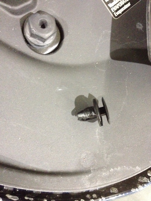

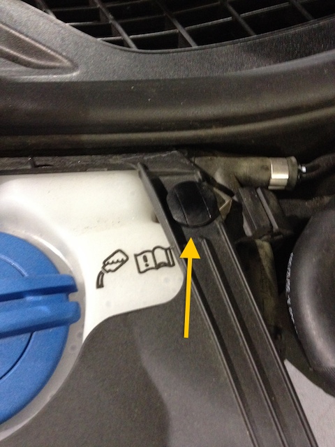

  4. Remove the expansion rivets from the front panel (not shown) and remove the panel. The PIWIS instructions also have your remove the front trim panel (find and remove the rivets) as well, but I was able to get the left panel out and back in without messing with the front panel.

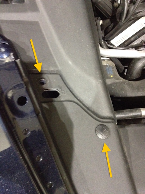

  5. Remove the 3 expansion rivets on the left trim panel and remove the panel. Two at the bottom and 1 at the top (see pics 1 and 2). Pry up the center "rectangle" part and when you pull it out enough the whole rivet will pull out without much force.

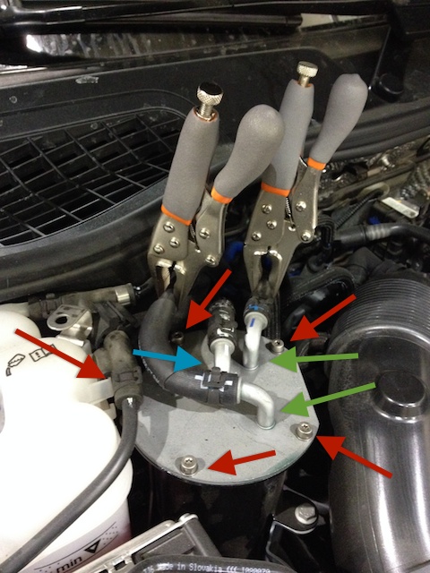

  6. Use the hose clamps to pinch off the two supply lines. Facing the filter housing from the bumper the supply lines are the "bottom" and "top right".

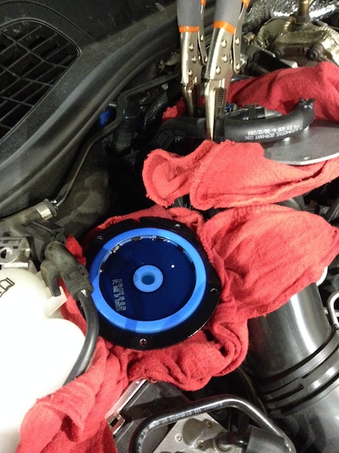

  7. Stuff/Wrap rags (I used two) around the body of the filter housing under the cap. When you pull the cap off, fuel will come out. Not only does it smell horrible, but PIWIS specifically warns against getting it on coolant hoses.
  8. Use your ratchet and the T20 driver to remove the 5 screws on the top of the housing.
  9. Make sure your rags are in place.

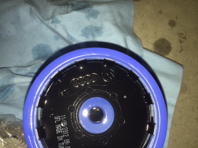

  10. Gently pull the cover off the housing. Mine had a good seal and I had to use a small screw driver to pry between the housing and cover. As soon as the seal popped, fuel bubbled out (hope you had your rags in place!!!) and the cover lifts free.
  11. Move the cover out of the way. As shown in the pics I moved it to the side and put it on a rag.

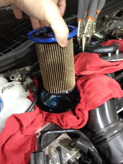

  12. Lift out the fuel filter. This thing holds a lot of fuel so be prepared to hold it there for a bit.
  13. Discard the filter if you are changing it or set it aside (where it won't get dirty) if you are only draining water.

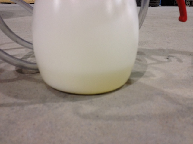

  14. Insert the hose of the extractor to the bottom of the housing and extract at least 100ml (according to PIWIS) of fuel.

The expansion rivet:
The rivet points (yellow arrows) for the left panel:
The filter housing. Red arrows indicate the screws. Green arrows are the supply lines. Blue arrow is the return line. My vise grips are already crimping the lines here. The line/tube that covers the left most screw just lifts out of place off the coolant tank (and I now realize I forgot to put it back in place...).
The cover off to the side. The blue is the top of the filter.
The filter
The drained fuel in the extractor. No sign of water. Color me shocked. Shocked I tell you!

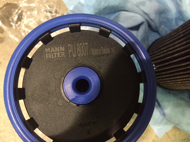

I'll get some pics added later, but other than the coloring of the top and the Mann info vs VW/Audi it is indeed the same.
Going into this maintenance I figured that post warranty I'd move to draining the water every 20k and swap the filter every 40k. Again there was no significant water in the system so I will move the 20k draining unless something changes in the last 1 I'll have to do under warranty.
The filter on the other hand seems to be about correct with the 20k interval. It was by no means clogged and could have gone on for awhile, but 40k (I think) would be too much and if I'm going to move to 20k draining then 30k would just get annoying. So I'll stick with 20k on the filter change.
I also learned that step 20 is important. I remembered that I needed to let it idle, but I didn't think about it too closely. So I started it up and backed it out of the garage to let it idle, or at least I intended too but it stalled on me. Given all the dire warnings about air in the HP side I will admit to a moment of puckering, but it started right back up and I let it finish idling.

Here are some pics of the Mann vs factory filters. Most of the discoloration of the old filter is just being wet, but when I started looking in between the elements I was finding even darker staining that suggested that it was indeed doing it's job well.
Edit: Interesting, looking back at the picture of the filter in the first post the old filter has definitely gotten darker over the last 8 months. Both pics were taken in roughly the same location of the shop and have nearly identical lighting conditions. Maybe Porsche does know something after all
