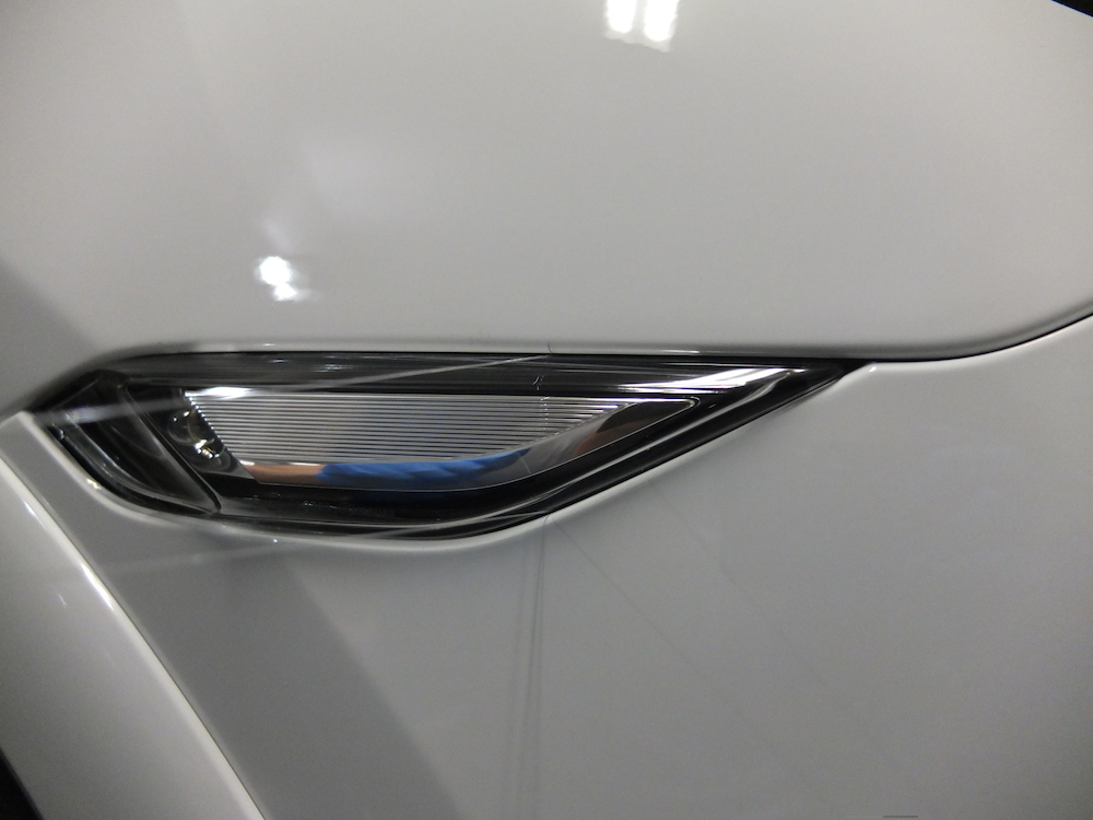

The dealer already pre-installed the Euro clear lens for me so I'll be swapping the clear bulbs out, process is the same
On the left is the Osram Diadem "Chrome" bulbs I will use to replace the factory clear bulbs (on the right) that came stock with our Amber Sidemarkers

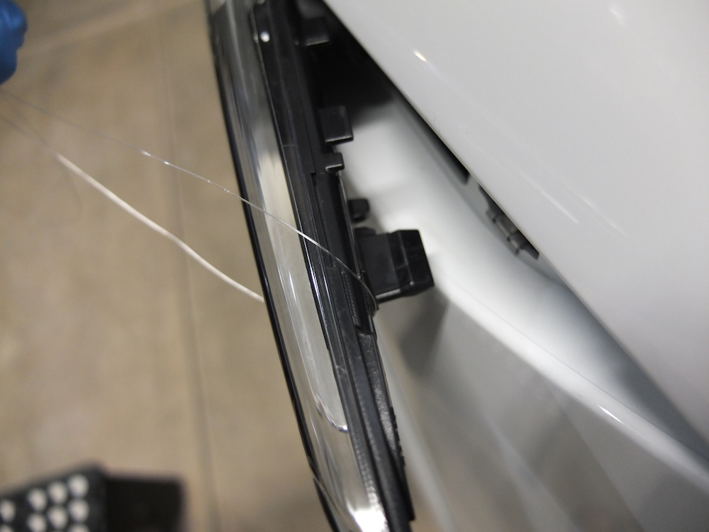

Now using the fishing line, cut it long enough so it gives you enough length to pull on them later, stuff it behind the lens from the front, the gap is tiny but it will fit
Wiggle the line further in until it stops, around this area
Get a grip on both ends of the fishing line and give it a gentle tug, it will unclip the lens from the front pressure clip, you can now see where the fishing line stops from the previous step, should take no more than 15 seconds up to this step

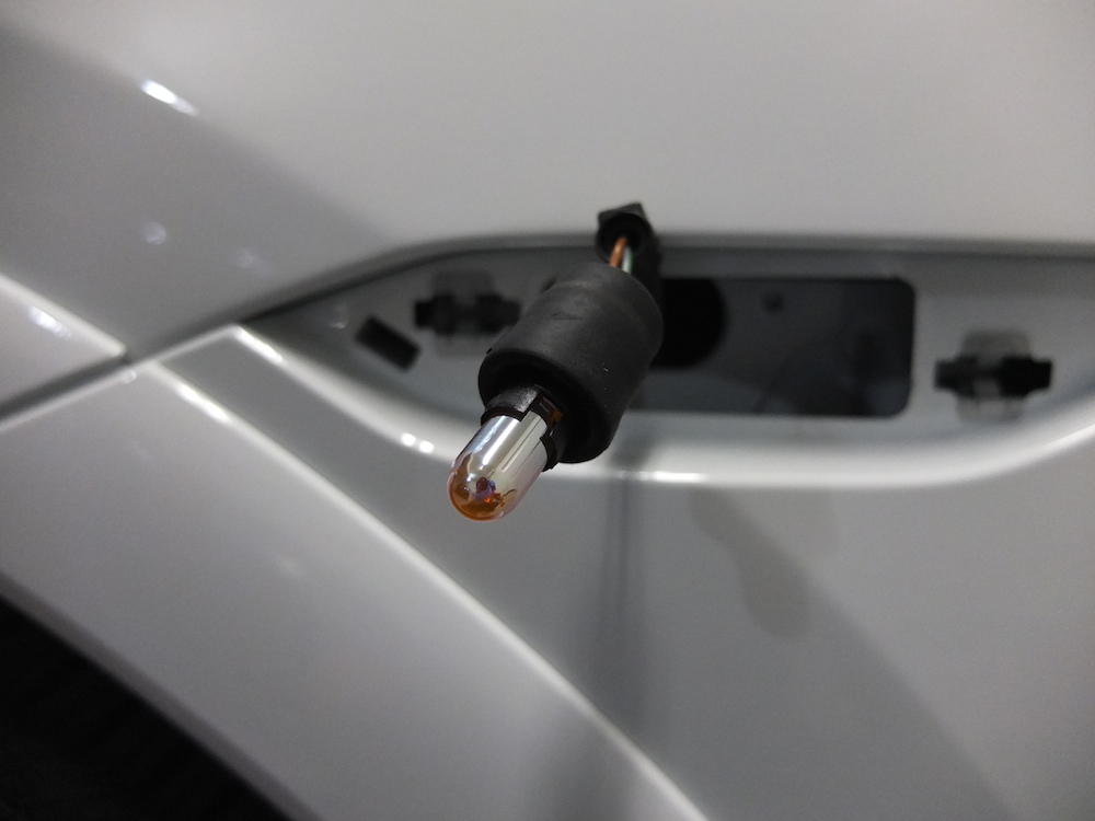

To change the bulbs, just "pull" the light socket out, no need to twist
If you are just changing the lens, you can stop here, put the new one in (clip the back end first) and follow the same steps on the other side. Super easy.
Continue if changing the bulbs: remember to use gloves or towel to pull out the bulb, pop the new one in

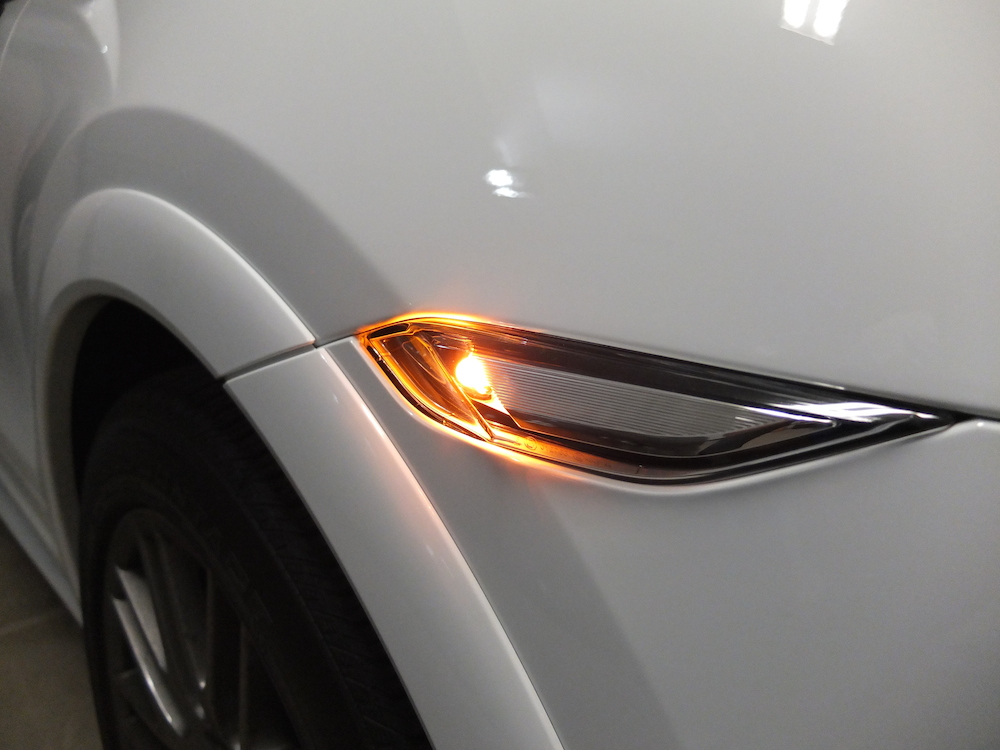

Make sure to do a light test before you put the lens back, especially important if you are changing to LED (polarity only allows one direction)

Special note on this bulb, it makes clear lens legal, it blinks OEM amber, lasts forever, won't melt housing, looks clean when installed
This is better than LED solution IMO
