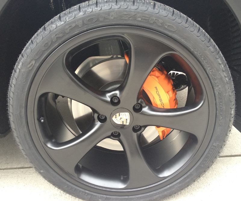

I own a powdercoating business, and I specialize in calipers. Have done over 2500 sets in the last 9 years for various cars. The way I do the letters is usually with vinyl, sometimes a stencil and paint, and then in most cases clearcoat with powdercoat over the vinyl to make them permanent. The problem with red calipers though, is that even with a low temperature cure clearcoat, the red bleeds through the white vinyl and turns it pink, so they are just uncoated vinyl stickers. I have successfully clearcoated silver and black letters on most reds though.
I did mine in Lamborghini Orange with black letters
