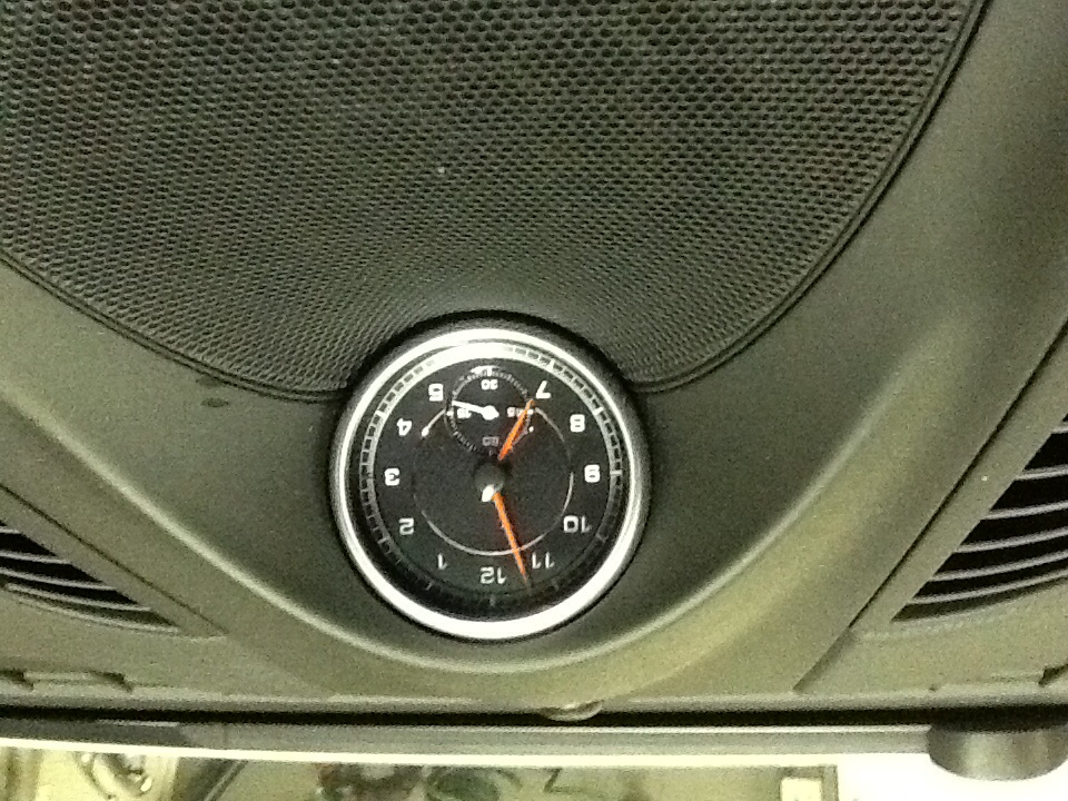

I just noticed the photo shown by cayenne s is not a Porsche Sport Chrono clock.
Please see my attached photo.

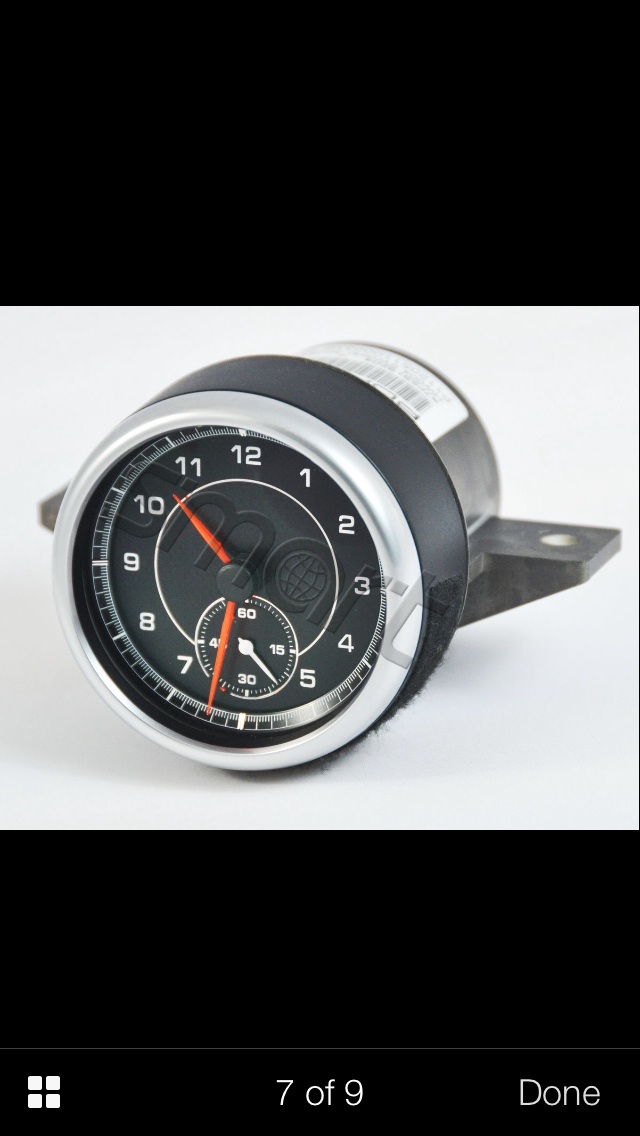

Thanks friends for your valuable inputs well this seller is selling three types standard watch, chrono sport watch & compass i found this standard watch and i was wondering did Porsche has release this in the new modules 2014 ?
what i know there are only the compass & chrono sport ! is this standard watch an OEM by Porsche

This is the clock on my 2013 Cayenne S, it looks like the ebay one. I drove a 2014 loaner one time and it had the same clock, not sure about 2015. A funny feature about this clock is that it actually stops running when ignition is off and as you unlock the car it will quickly spin to the current time.
