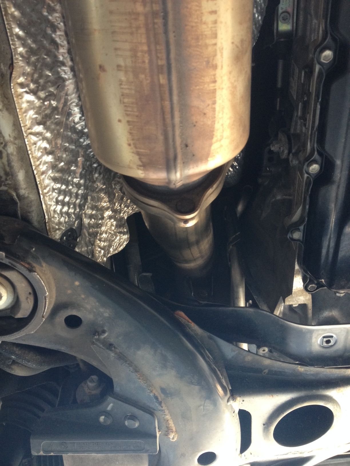

left stock secondary cat pipe, need to unscrew 3 flange nuts which are pretty staightforward
A closer view of left stock cat and the back side of the flange screw/nut. The right stock secondary cat pipe is DIFFICULT! Two flange nuts are easy to access; however, the third (on top) is a pain due to limited room to access.

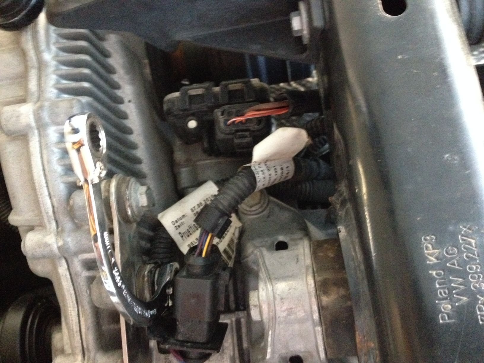

Add a bottle jack to support transfer case and remove the cross beam. This allows more room to remove the stock secondary cats and install new Bypass Pipes.
Needed to remove a nut and disconnect a wire plug to allow access to remove the cross beam.
Remove two bolts at the center and two at either end of the cross beam.
