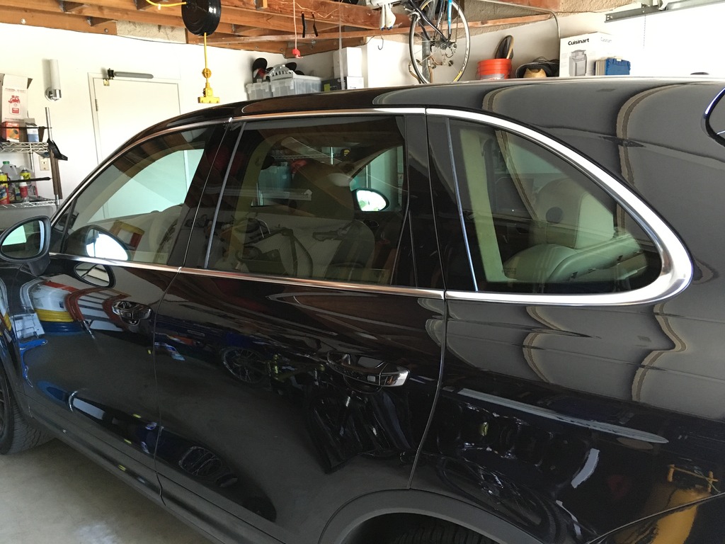

Ok, just finished this project and it's wasn't that bad. No windows had to be removed and all clips and trim are sitting pretty.
There is one lower clip by the rear door that isn't as tight as I'd like it to be but nobody will notice and I'll readjust on another garage day. All in all, a 3 hour job. That's taking your time, unboxing the trim, lunch and then the install.
Before:

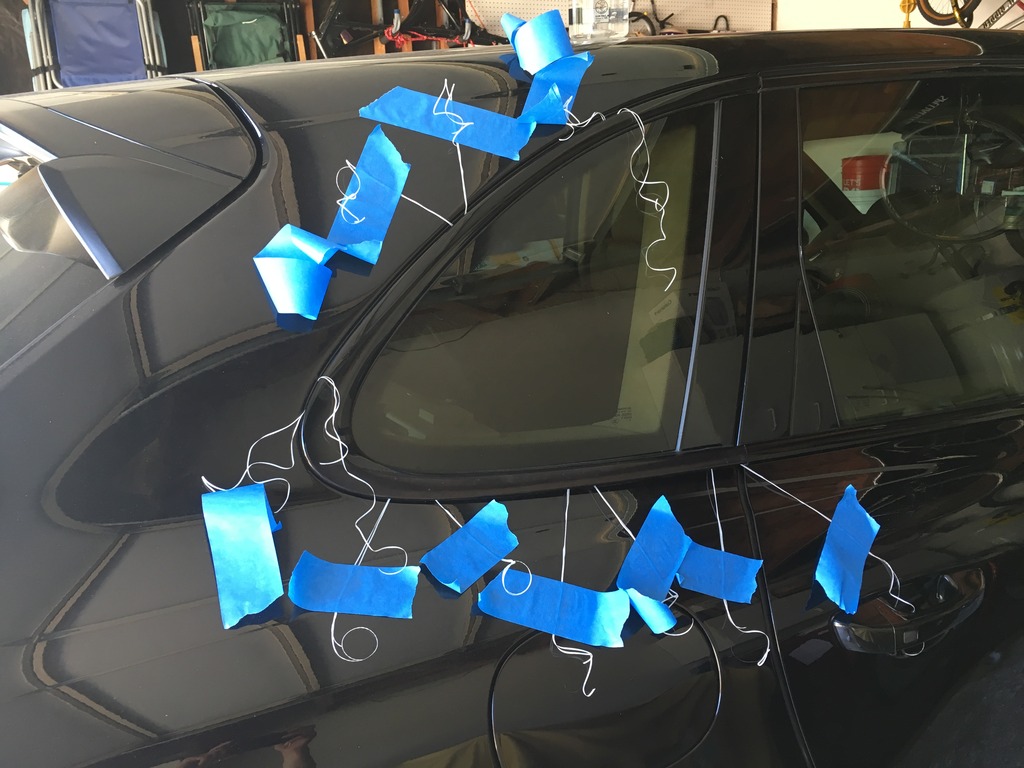

The Process:

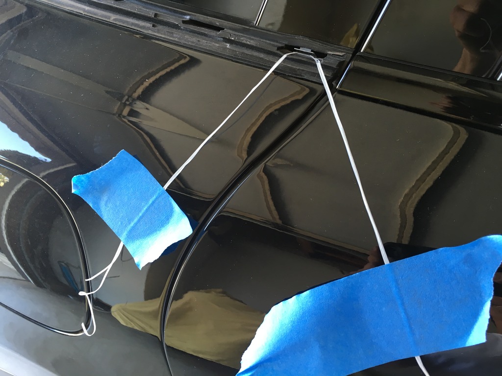

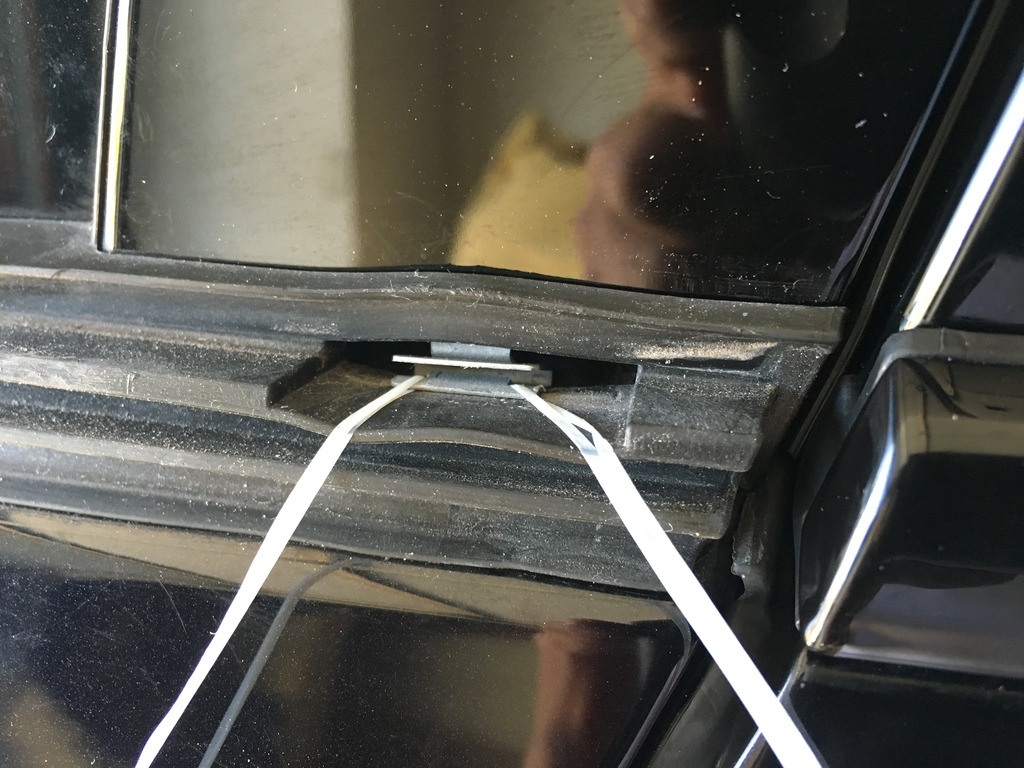

The top of the metal clip is exposed, you'll want to tuck it under with the small dull pick. don't use a sharp one or you run the risk of cutting into your rubber.
Proper orientation of the clip is the little clip lip is hidden behind the rubber. The lower, or opposite edge is supposed to be resting on the rubber and exposed. All clip lips are facing the inside of the trim

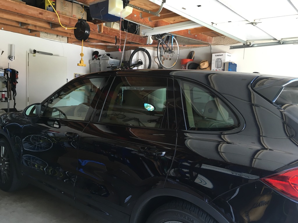

AFTER:

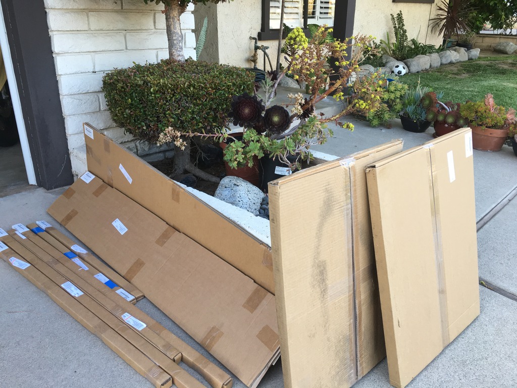

Also selling a set of Aluminum trim in absolute perfect condition. Removed from my Cayenne with 15,500 on the clock.
You can have it painted and then install for no down time. I'll sell for cheap.

Those are some nice boxes 😉

Black looks so much better.
