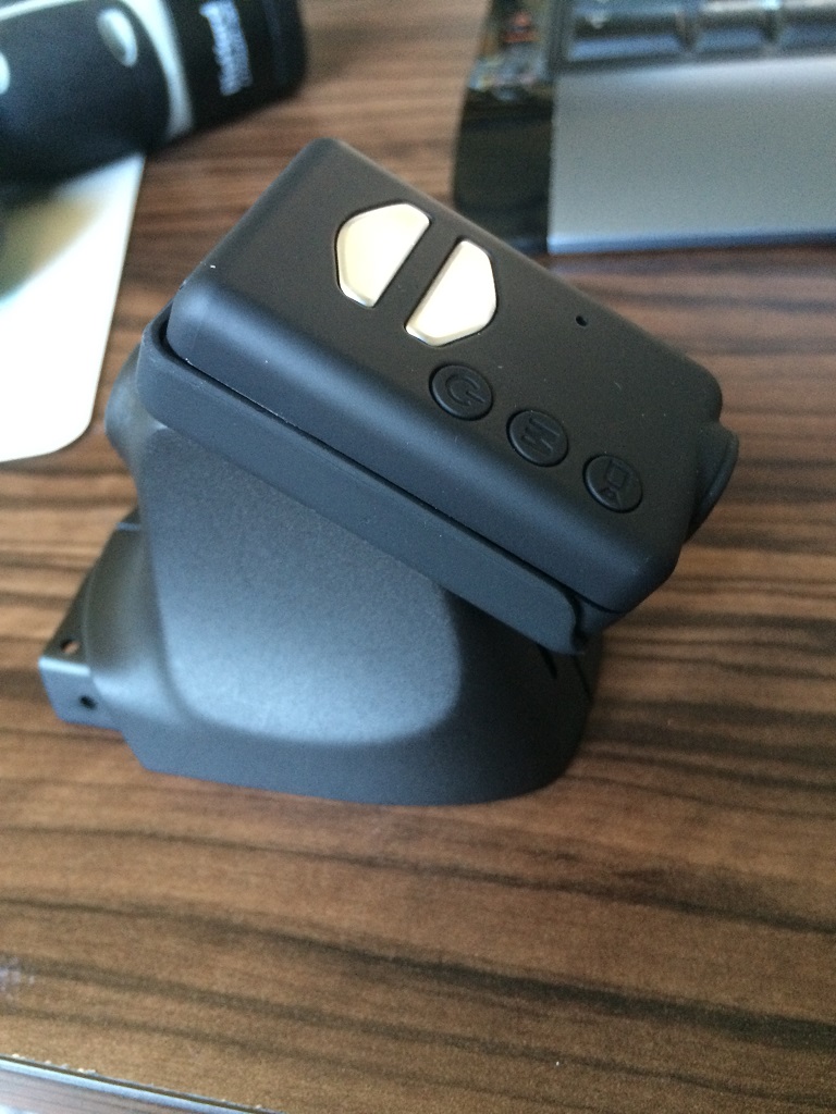

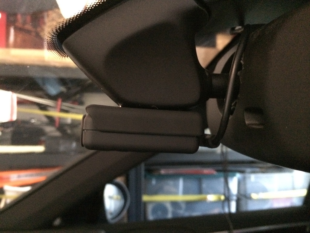

After a recent incidence where buddy's car was rear-ended by some punk driving while texting, I decided to install a rear facing dashcam. I already have a cheap dashcam in the front, but figure it's bulky and not very pretty. So I decided to move it to the back and buy something more discrete for the front.
After doing some research I ended up with "Mobius" camera due to it's small footprint and very good picture quality. It's a popular alternative to the Gopro due to its size, and commonly used in R/C hobby community. Now the beauty of this camera is the price; it can be had for less than $70. But the downside to this smallness is the lack of LCD screen, so you will need some trial and error to aim, and also video playback.
Mounting to the Cayenne was extremely easy. There's a flat spot at the bottom of the rearview mirror housing where you can just use a double sided tape or Velcro to attach the camera to. After installation you can't even tell it's there from inside the car, since it's completely hidden by the rear view mirror.
Power came from a micro USB cable I bought on ebay which tucks along the upper windshield inside the roof-liner, down the A-pillar and into the fusebox.

hmm it looks like its aiming upwards, do you have a still photo to show the POV?

The Mobius is working very well. I checked the recording the other day and it recorded everything as expected. So I went out and bought another one for the rear. Going to try mounting on the rear overhead lamp cover.
