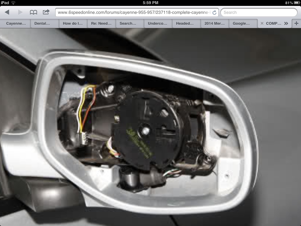

Here are some pics.

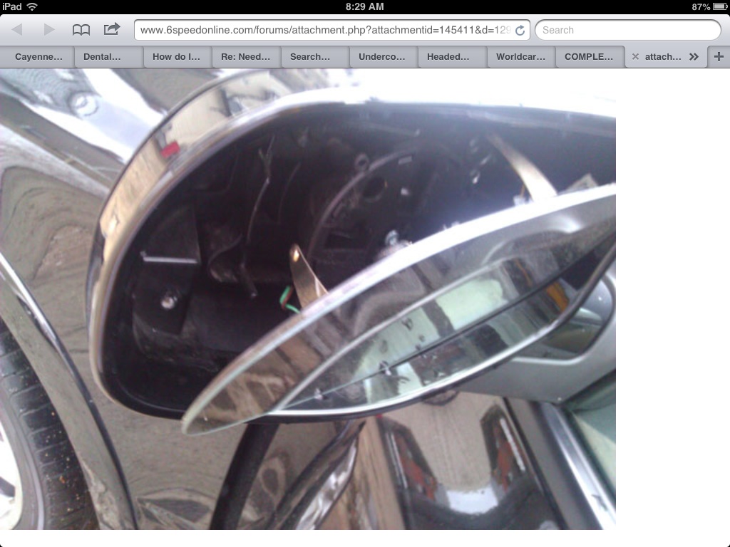

You can pry the mirror off.

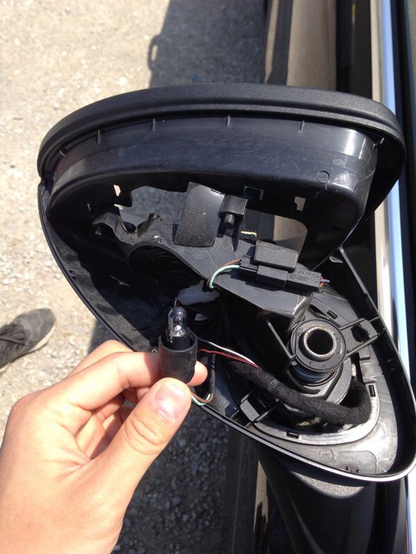

This is how it looks.

The light socket

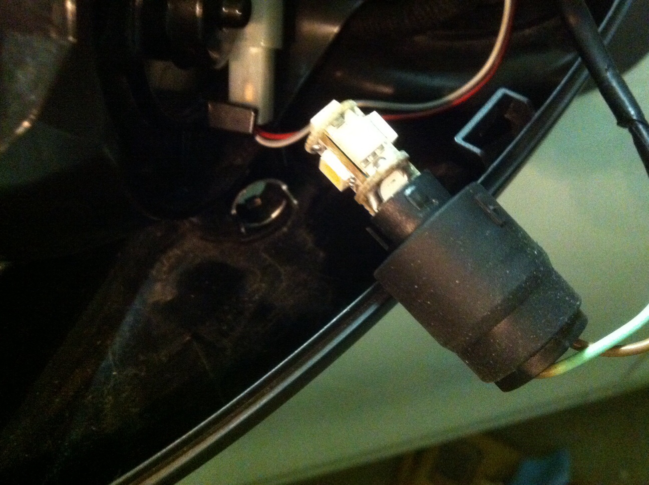

New LED bulb, you need to get a shorter bulb, the space is very limited. As the bulb is installed sideways, you need to get one that has LED elements on the side of the bulb, otherwise it will not be bright enough.

I just had these 2 extra no-name LED bulbs that happened to fit. I bought a whole bunch of LEDs a while ago because I also changed all my interior lights to LED. I did not break any glass or clips but you need to be very careful. You need to remove the mirror glass and the mirror base first because you need to unclip the body color cover from behind. After the cover is removed, you can then pull out the light socket. Hope this helps.

You need to remove the mirror glass first in order to get behind the plastic cover to release the clips.

Just wrap a towel on a screwdriver and you can pry out the mirror, not too much force is needed, don't worry, you won't break anything.
